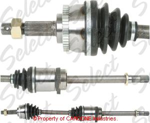

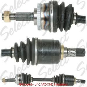

i don't have time for actual pics of my car but might phone pic 'em. . .the driver side has a c-clip but the passenger does NOT!
top pic driver; bottom pic passenger; middle is . . . really inspect "insert end" of shaft! might need to be filed with an angle file(triangle body shape) to get rid of dings and burrs "so to speak" on the very end that enters. . . you wont have any gaps like 1,2, or 3 inches if installed fully. . .passenger side is removed by loosening 3 bolts on the flange around the bulky housing and held in by those.
http://www.2carpros.com/forum/automotive_pictures/400521_driver_side_1.jpg
http://www.2carpros.com/forum/automotive_pictures/400521_axel_view_1.jpg
http://www.2carpros.com/forum/automotive_pictures/400521_passenger_side_1.jpg

Pic of L & R axle showing C clips.
http://www.2carpros.com/forum/automotive_pictures/61395_1_57.jpg
If there is no grove for the C clip on the L/H?axle the end has broken off. as you can see there should be a c clip on the end that locks it in place.
Mark (mhpautos)
