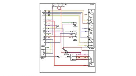

1998 Nissan 240SX Heater is on High
NKBUTTERFLY3
1998 Nissan 240SX
If the heater is automatically on high...
If I would put a thermostat in would that help until I get it into the mechanic.
Lastly, what prince range do the thermostats run?
Dec 22, 2008 at 6:42 AM
  • 75,988 POSTS
Operating on high at all times-check and test the blower motor resistor and its intergrated fuse
https://images.2carpros.com/forum/automotive_pictures/12900_resistor_8.jpg
