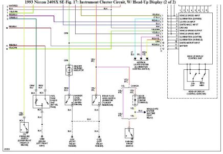

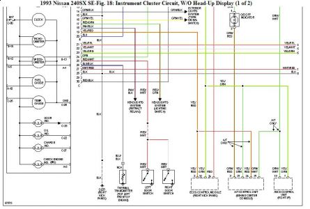

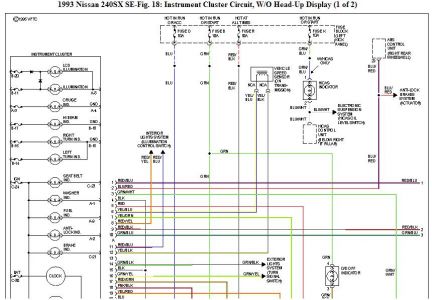

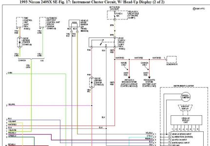

Sorry for the drelay in replying. I have been encountering difficulties logging into my database for the past few days and is still facing it. However it must be noted that the speedometer not working could be due to the Power Control Module (PCM) but the back lights are a different problem as they are not controlled by the PCM. There are 2 separate schematics and one of it has the control unit in the meter cluster. For both, youneed to test oif the speed sensor is pulsing to provide the signal.
