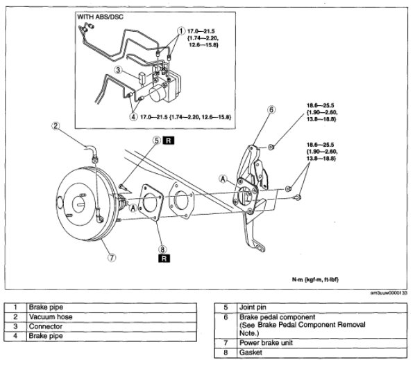

I recently had my brakes and rotor replaced and the first time I drove my car after the new brakes were installed, I had an unusual new noise when driving my car. At first the noise only occurred when I was slowing or coasting to a stop. The noise was a hiss-like sound. I called my mechanic and he was not concerned, but I did schedule an appointment to have the car looked at/repaired. In the meantime, the noise has gotten worse. I have limited my driving since receiving the new brakes and a new noise, but did freeway driving this weekend. I am no longer driving for fear that driving may cause more damage to my car or leave me stranded in one hundred plus degree temperatures.

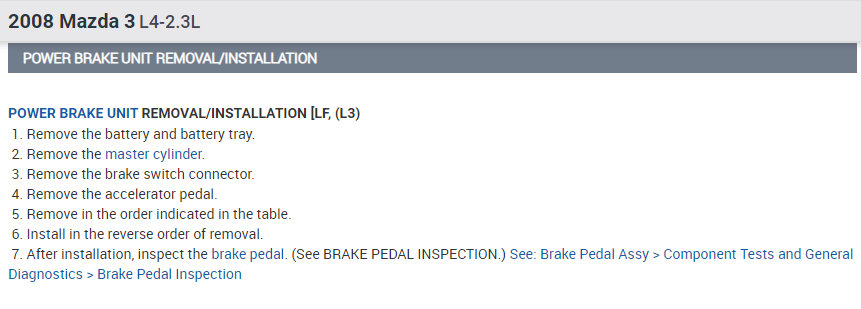

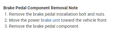

Here is the information you requested. Be sure to just move the brake master cylinder slightly out of the way so that you don't have to open a line and then have to bleed the brake system. I've attached picture steps below on how to change the power brake booster on your car. Hope this helps and thanks for using 2CarPros.
