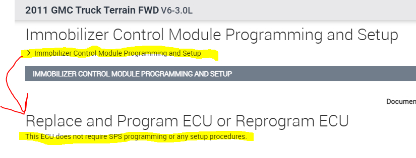

Take a look at the pic I attached below. According to my manual, the immobilizer does not need programmed when the ECM is replaced.
So, I need to rewind. What led to the replacement? Were there problems before related to the anti-theft?
Let me know exactly what happens when you turn the key to start the engine.
See pic below.

Was slow getting up to speed, when stopped the car would try to lunge forward and after driving for a bit the flash would flash engine power reduced. Had it scanned at 2 different shops and was told the ECM needed to be replaced. They ordered us 1 ECM and it wasn't working still so they sent us another one. Never had a problem with the anti-theft before.
When we turn the key all the lights on the dash light up then goes off except the service engine light. We spoke with the place we got the ECM again today and they told us that the ECM was programmed with our Vin # for the car and the anti-theft light should be staying on until the key is programmed.
I really appreciate all your help with this. It is my daughter's car and I've been trying to help her. I've replaced ECM's before and never ran into a problem with both being able to program the key to the new ECM.
Oct 26, 2022 at 11:57 AM
