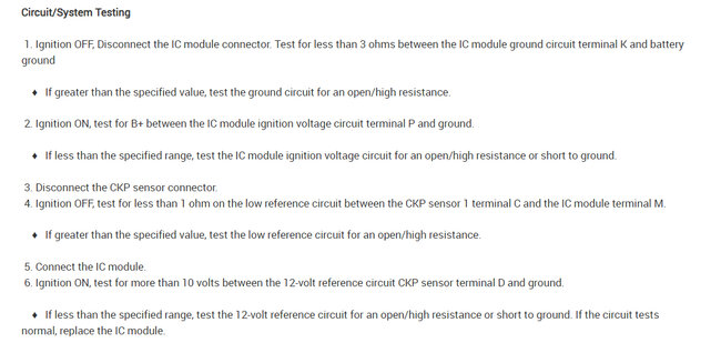

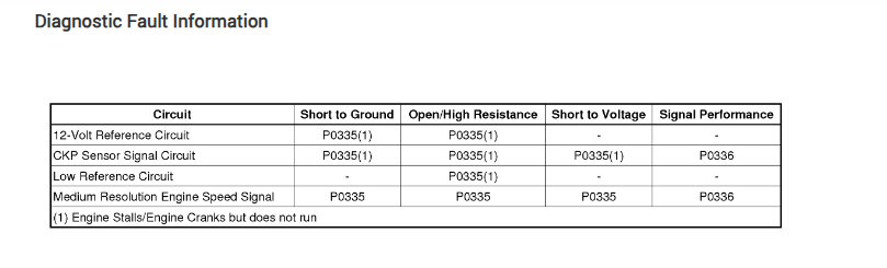

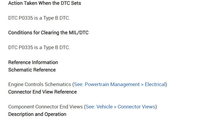

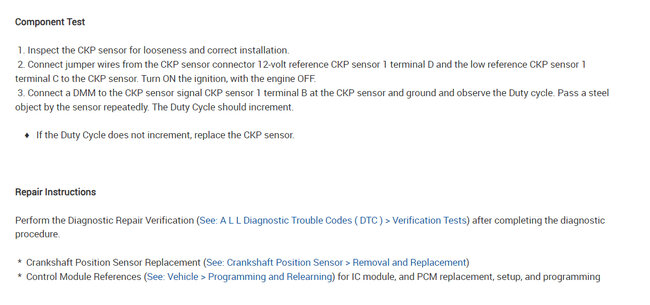

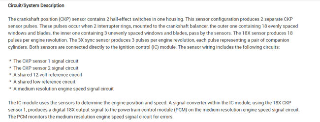

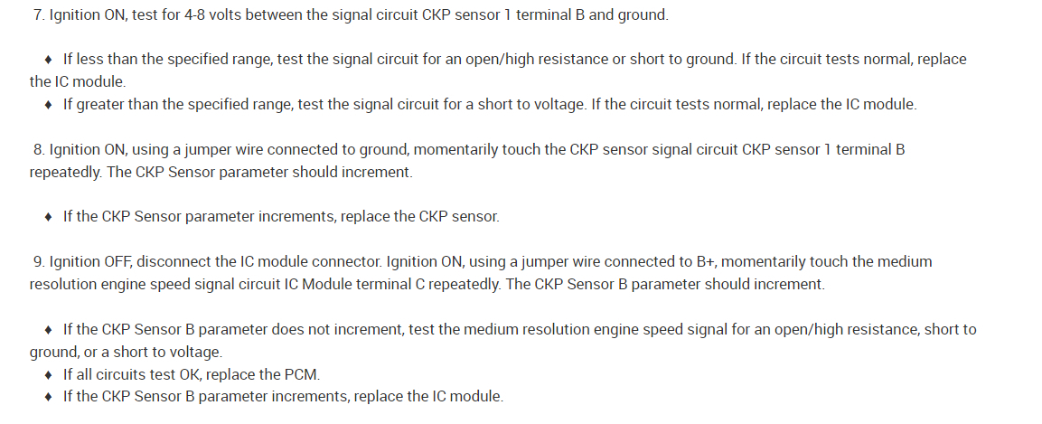

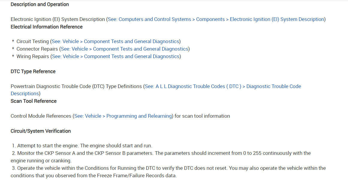

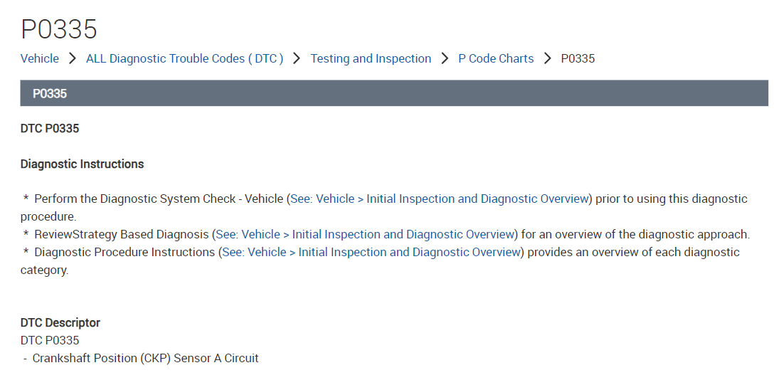

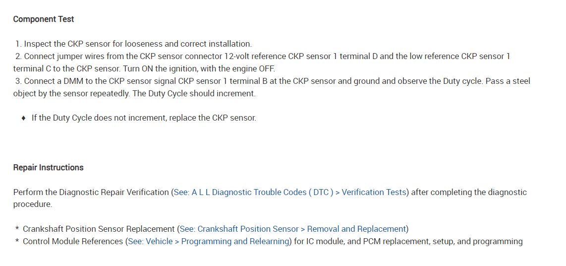

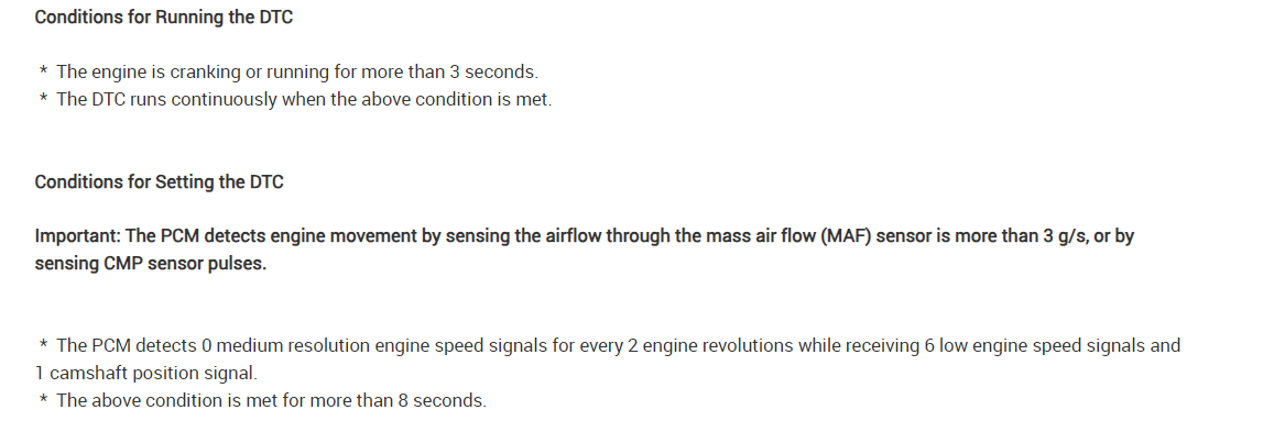

What symptoms are you experiencing? As far as the MAP sensor grommet, I believe that would drop into the intake manifold. If that is the case, it could cause issues.
The two codes you have are related, as you mentioned. I feel the 136 is a result of the 135 code. I attached diagnostics below. Take a look through them and let me know if you are comfortable performing them.

I think I'm good. The connector for the crankshaft got wet when I did the water pump So once it dried, it was fine. Turns out the catalytic converter is clogged. I'm all set. Thank you
