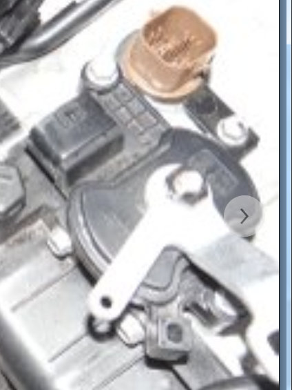

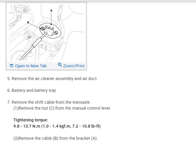

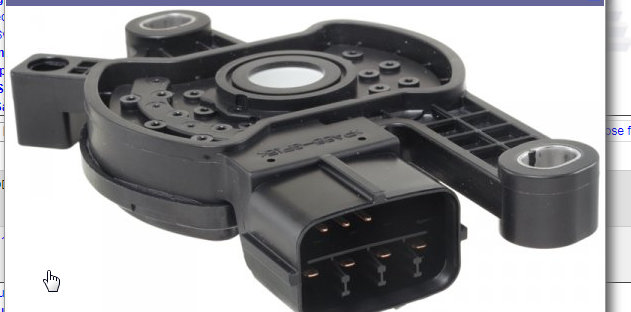

I need to find the neutral safety switch on my engine and I can't locate it. Is there a picture you could show me to help me locate it?
Nov 5, 2019 at 9:24 PM

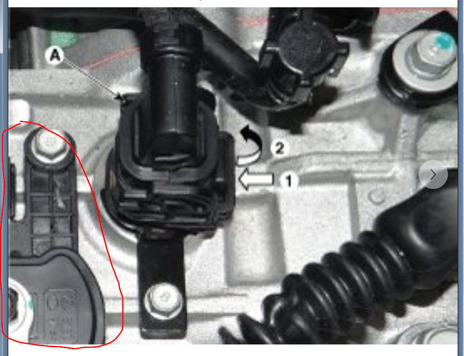

You do not have a neutral safety switch on an automatic transmission. You have what is called a Trans-axle range switch. This is located on the top of the transmission when there shift cable attached to.
I attached a number of different pictures of what it looks like. Let me know if you have questions. Thanks

Okay, I located the part and replaced it. I did that on Thursday of last week. It's worked perfect ever since. Until today. It's doing the same thing again. It won't crank. I put it in neutral and still wouldn't crank. I let it sit for a minute. Put the hand brake on, or it in neutral again and then it cranks. Any clue what's going on with it?

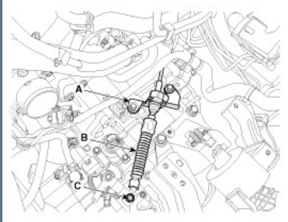

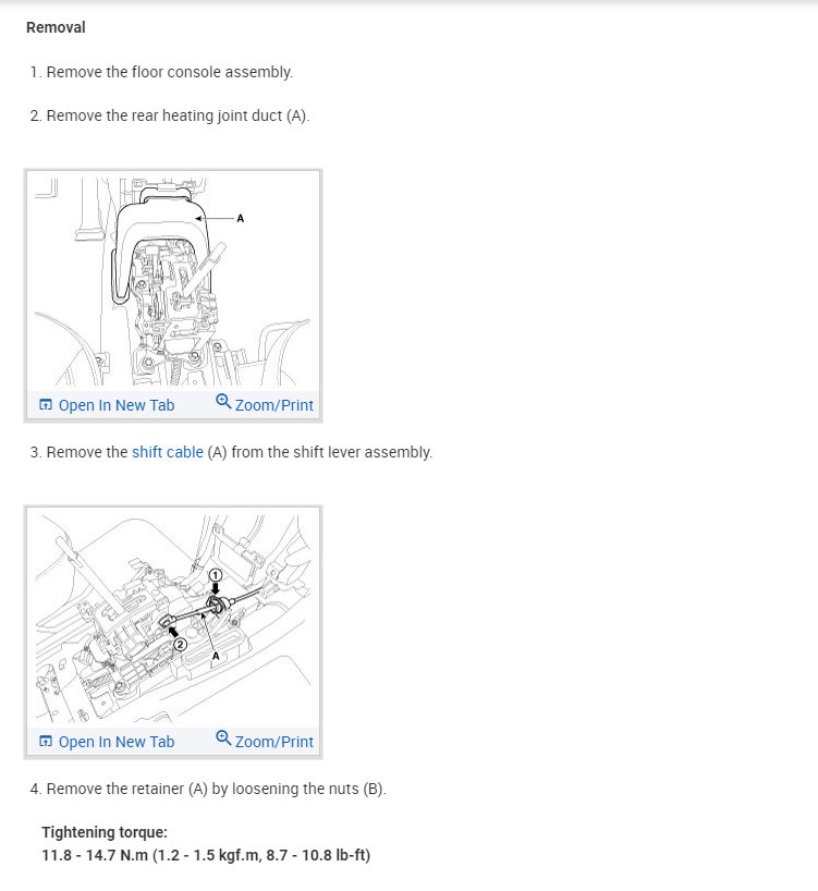

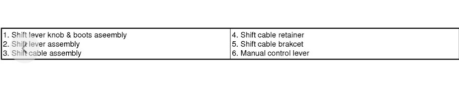

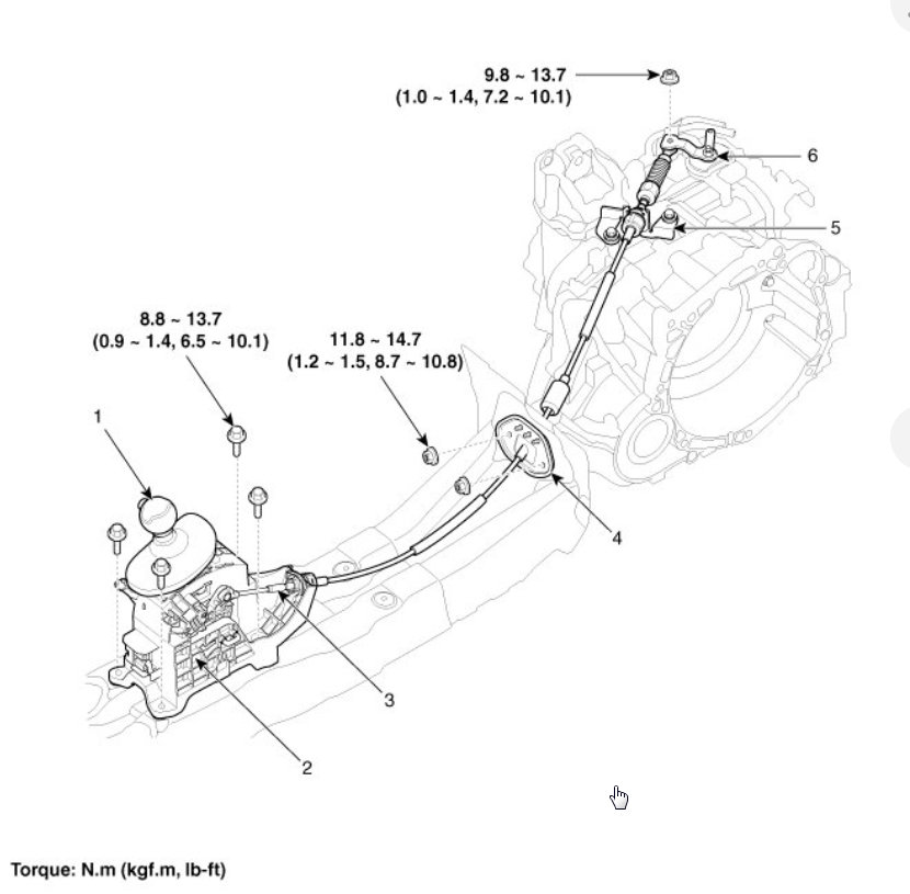

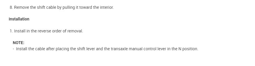

There is a chance that this is the shift cable itself but before you do anything, I would return the part and have it exchanged because if you had an issue, replaced a part, and it was fixed then that was the issue. If it starts again, chances are that part failed. Unfortunately, I have had too many experiences with "new" parts from the parts stores that fail shortly after installation.
I included the process for the shift cable but again, I would not do this first. Also, before you replace this again, get it to act up and then press the shifter into park pretty hard and see if the vehicle starts. I suspect the sensor is telling the vehicle is not fully in park which would prevent the start.
