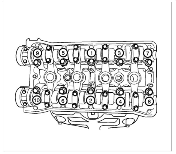

Need torque settings on cylinder head and big end bearings.

Here are the engine torque spec you have requested:
Camshaft Cap Bolts 16 Nm (12 ft. lbs.)
Cylinder Head Bolts - Camshaft Support Housing and Cylinder Head Mounting Bolts 25 Nm+60°+60°+60°+15°(18 ft. lbs.+60°+60°+60°+10°)
Crankshaft Bearing Cap Bolts 50 Nm+45°+15°(37 ft. lbs.+45°+15°)
Connecting Rod Bearing Cap Bolts 25 Nm+30°+15°(18 ft. lbs.+30°+15°)
