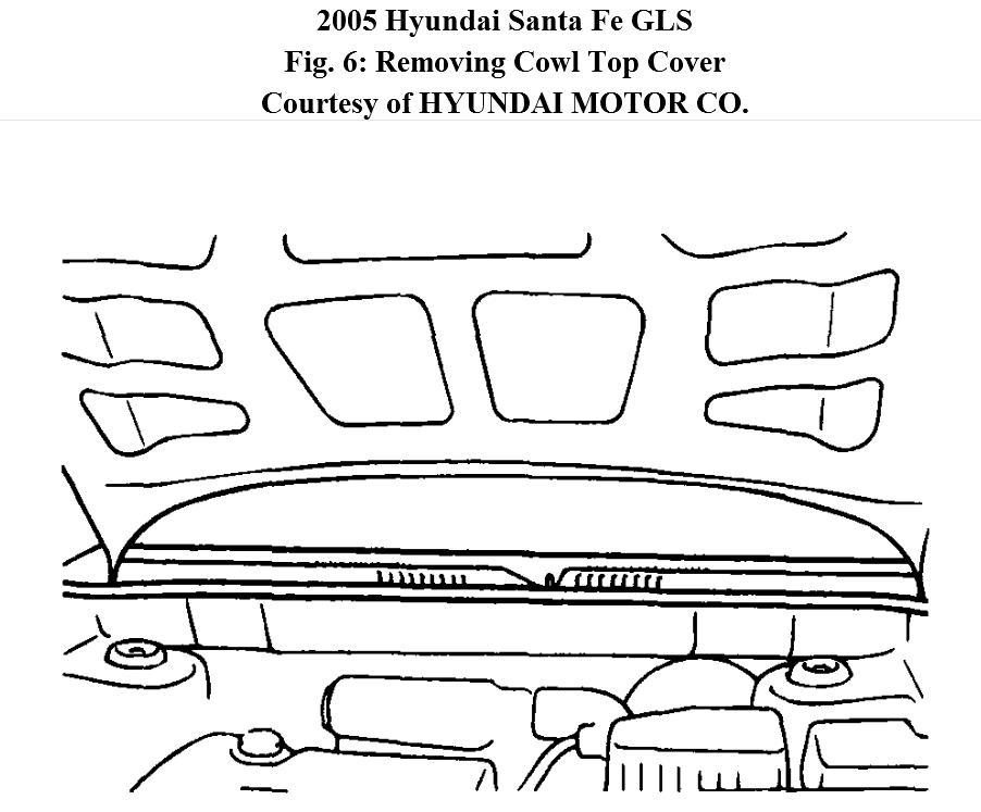

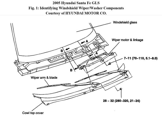

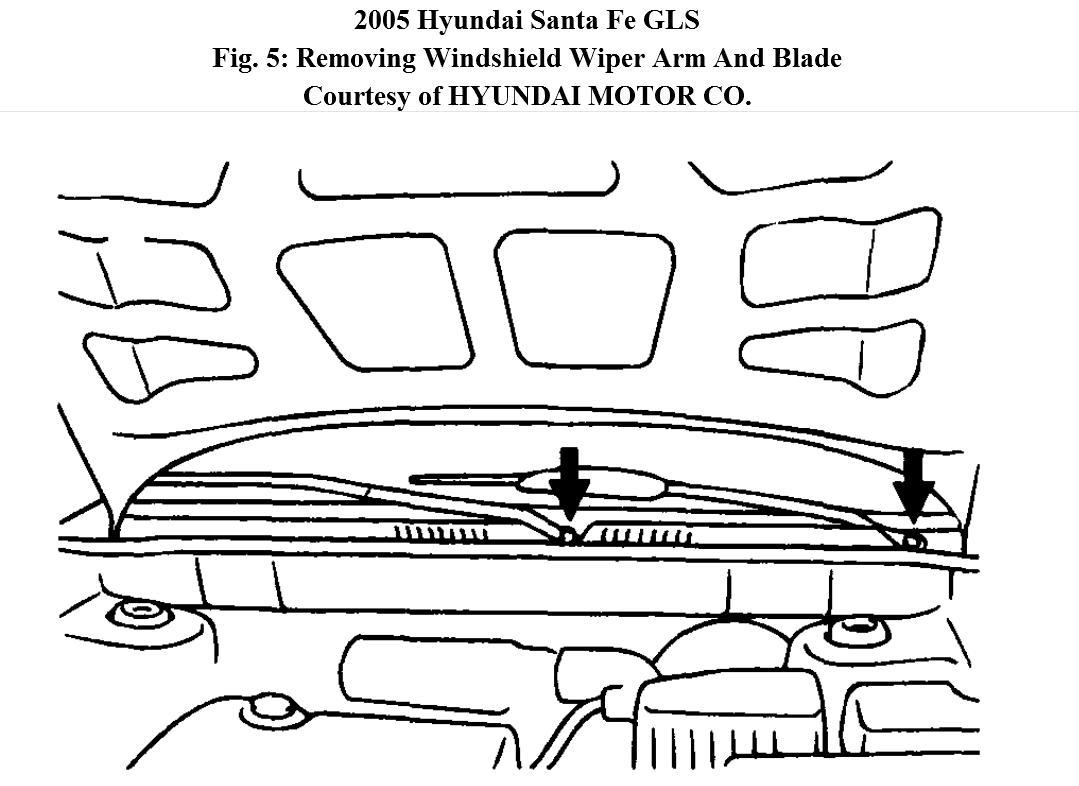

1. Remove the windshield wiper arm and blade.
NOTE:
Care must be taken not to scratch the engine hood.
2. Remove the weather strip and the cowl top cover.

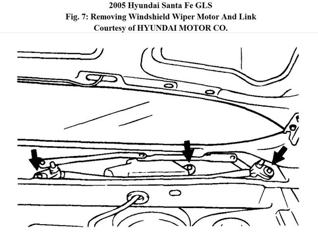

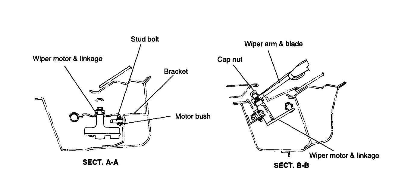

3. Disconnect the windshield wiper motor connector and remove the windshield
wiper motor and the link.
Tightening torque
7~11 Nm (70~110 kg.cm, 5.1~8.0 lb.ft)
