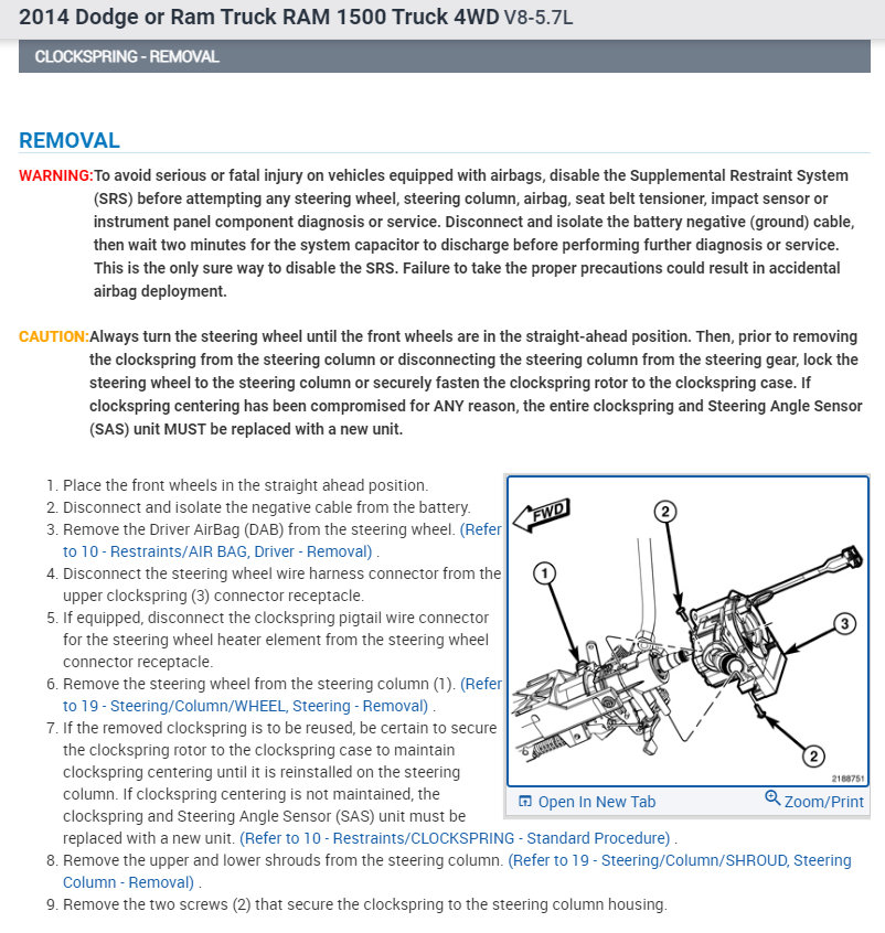

Not sure which clock spring is the best replacement... part number 68528300AA or68528301AA Mopar site lists both.
Oct 17, 2021 at 9:42 PM
SQM
  • 6,383 POSTS

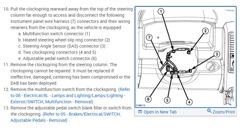

These are two different clock springs, depending on options and manufacturing date they used those two types, for the same model truck.
Best option would be to call your local Ram dealer and provide them with the VIN. They will be able to let you know the part number that is suited for that specific VIN.
https://www.2carpros.com/articles/steering-wheel-clock-spring-removal
