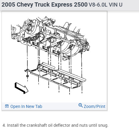

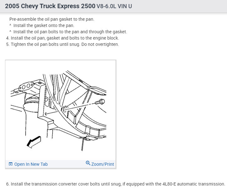

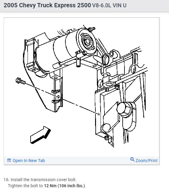

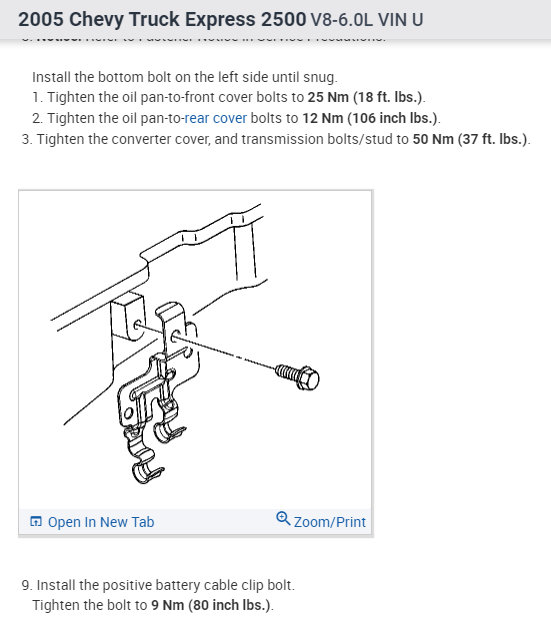

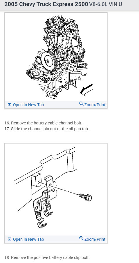

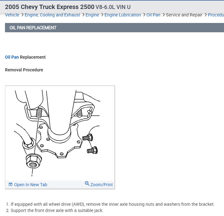

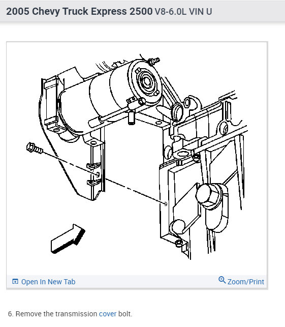

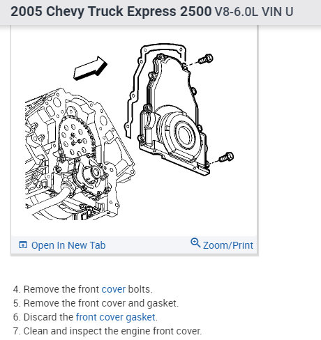

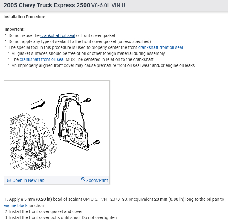

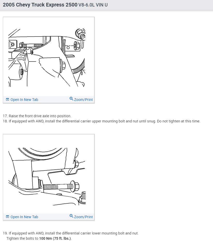

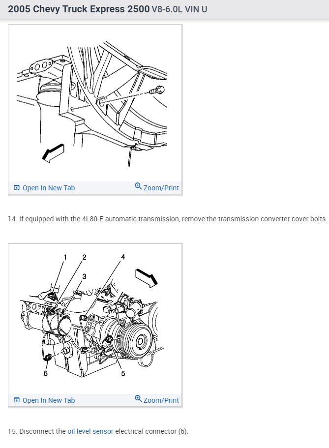

Need instructions to change the oil pump on the van listed above 3500.
May 22, 2022 at 5:05 PM
SQM
  • 6,383 POSTS

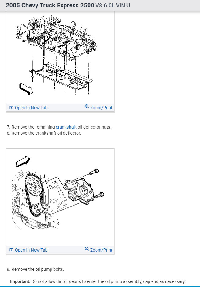

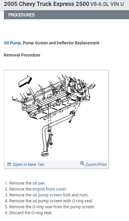

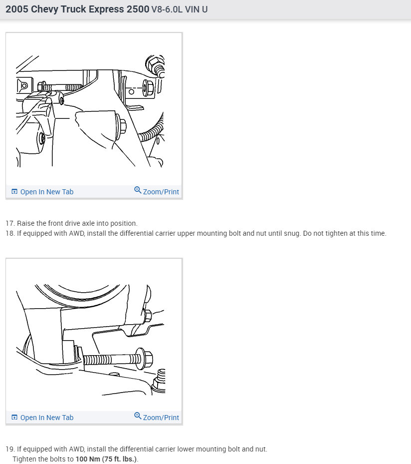

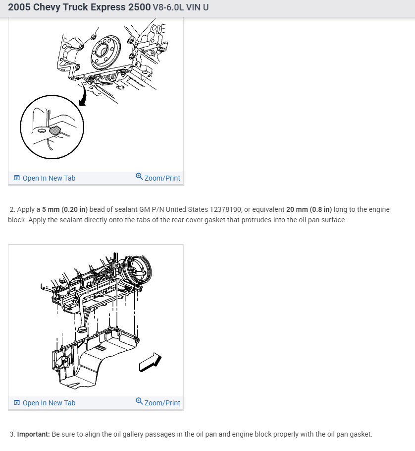

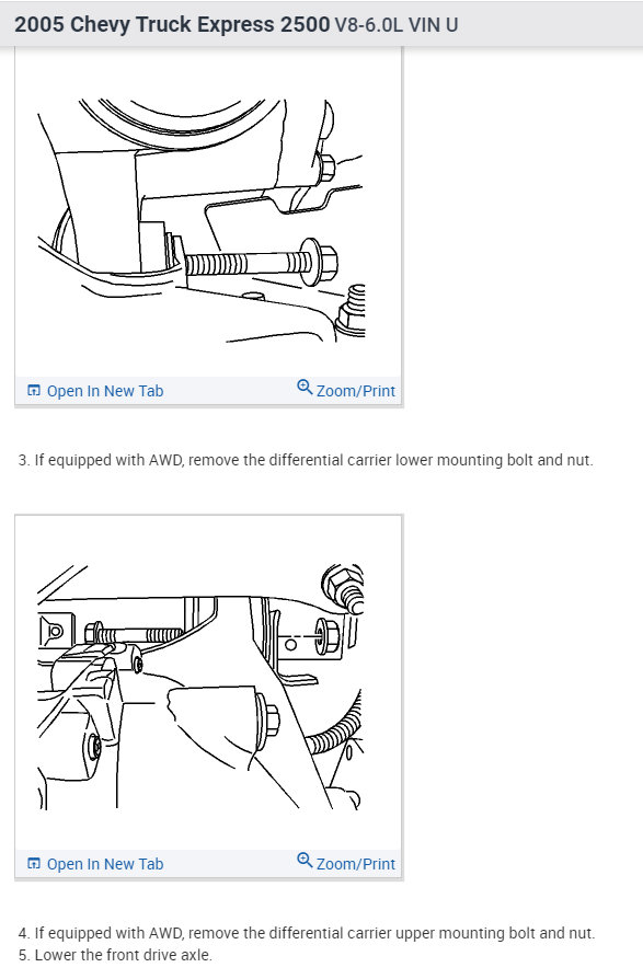

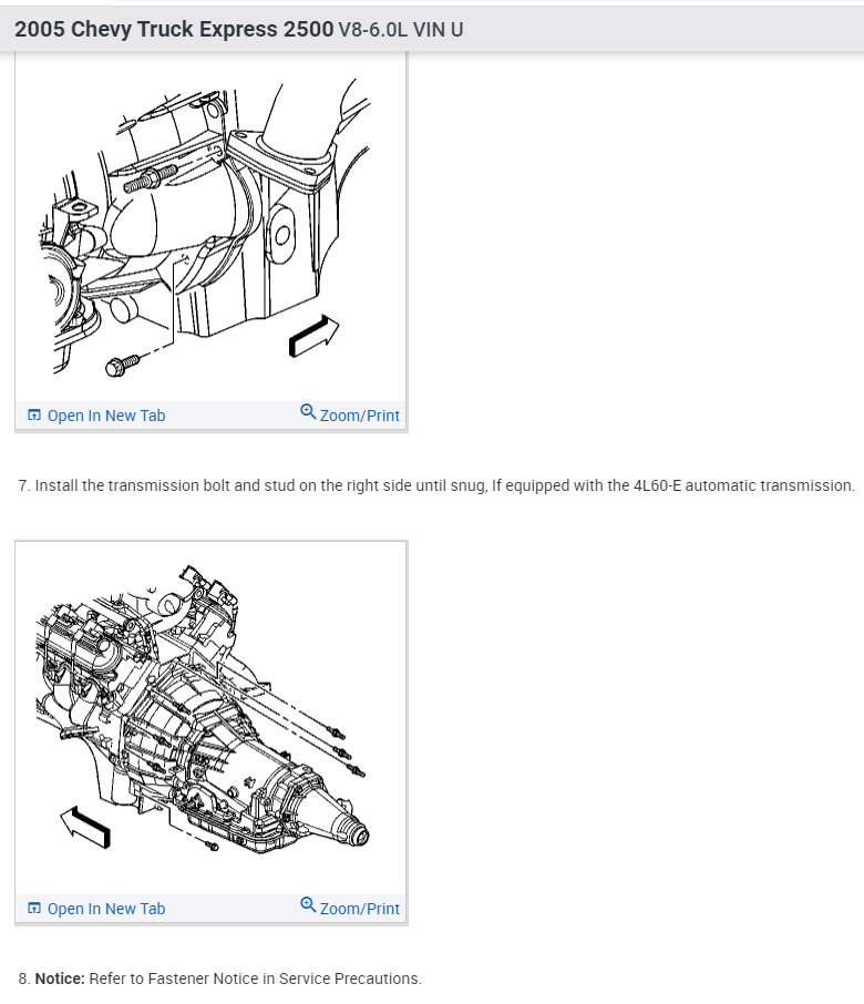

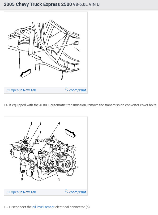

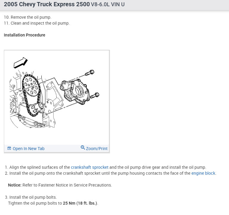

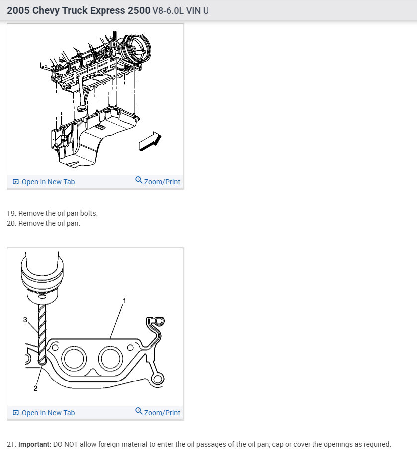

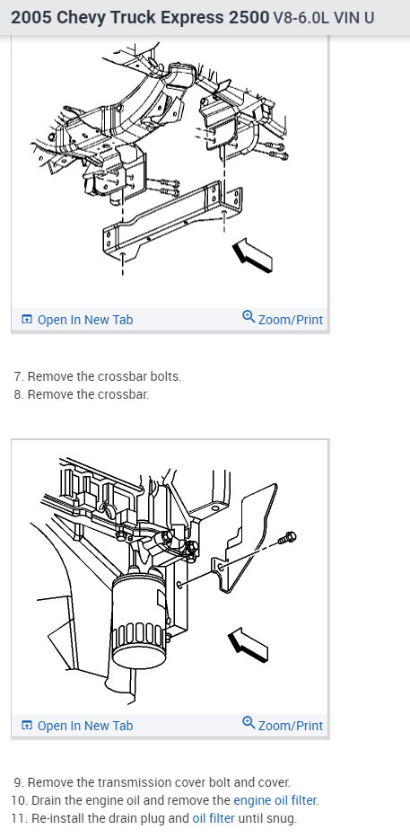

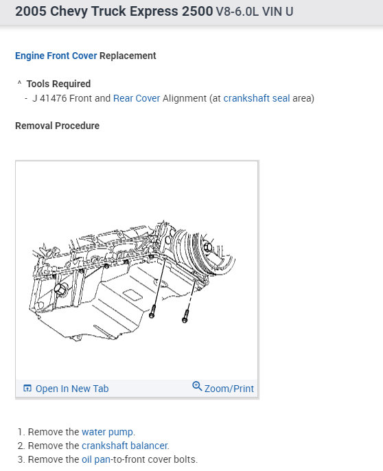

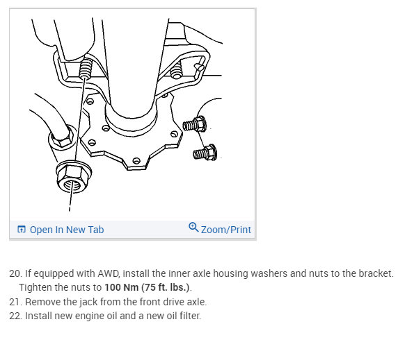

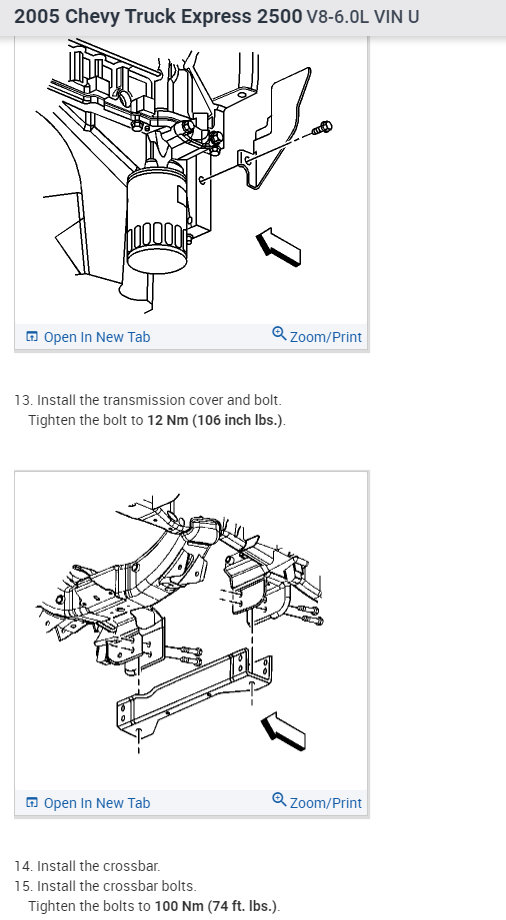

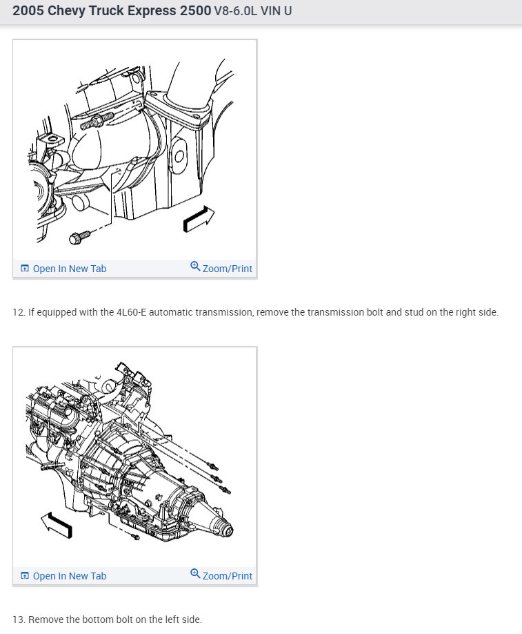

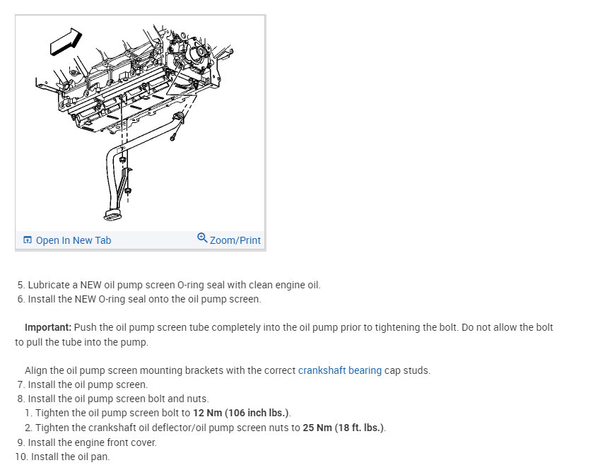

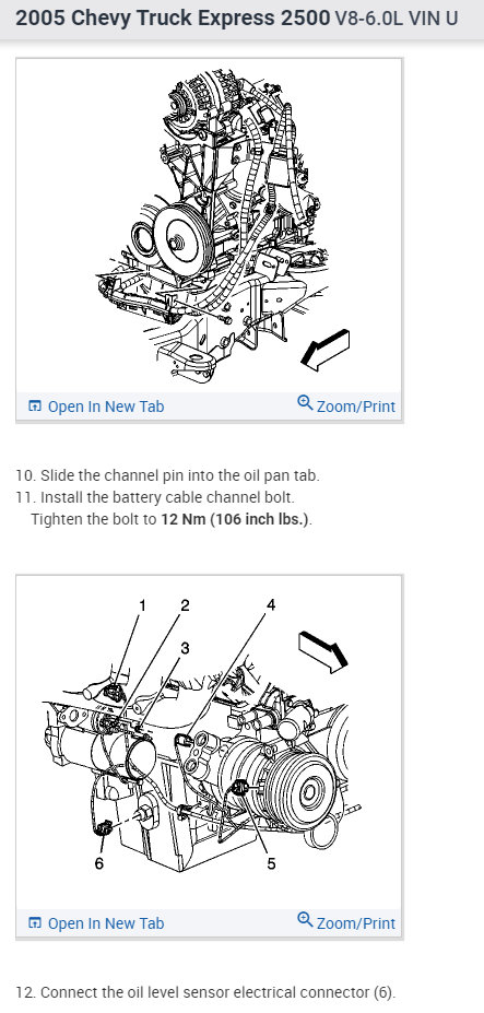

There are several components that will have to be removed to get to the oil pump.
You will first have to remove the oil pan, engine front cover, and water pump.

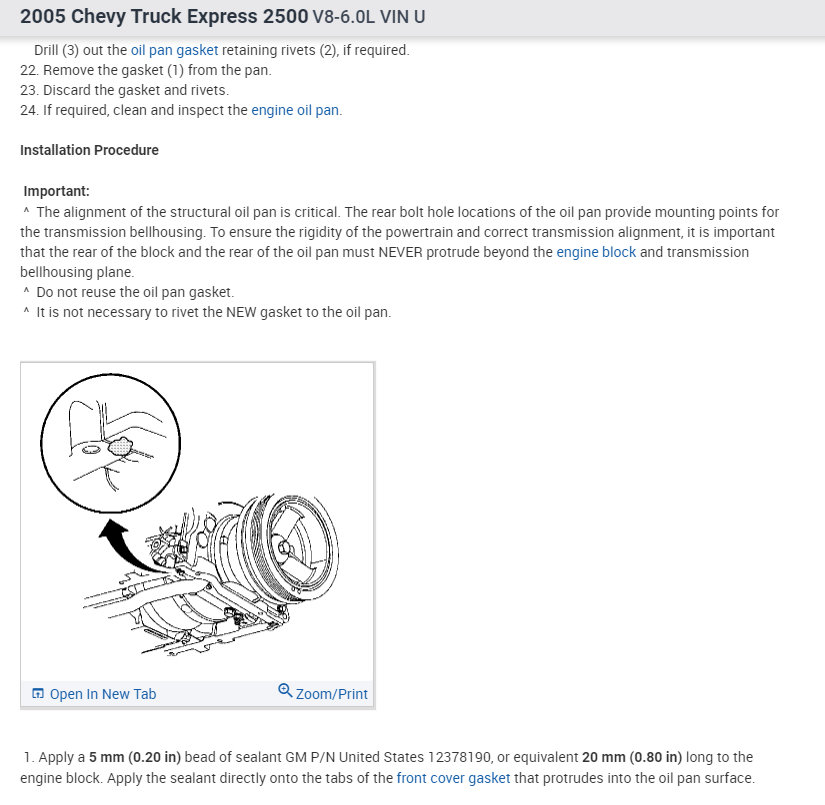

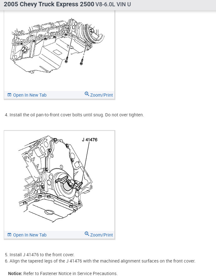

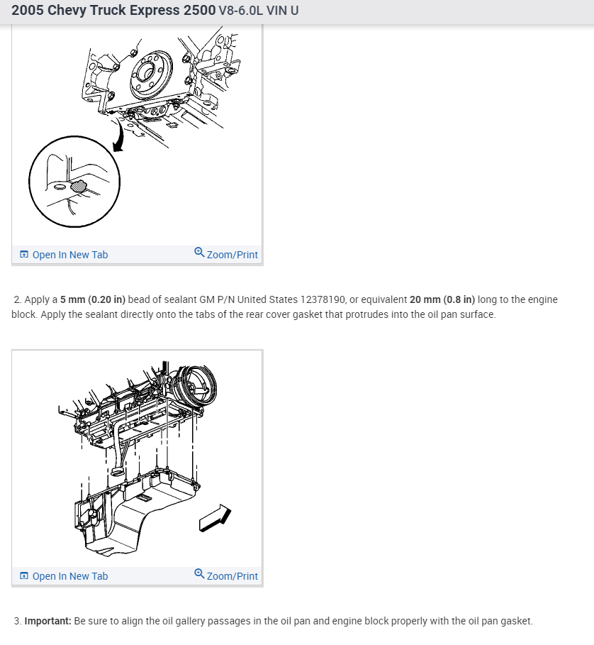

I have attached the procedures, including all the torque specifications below for your reference.
Let me know of any questions.
