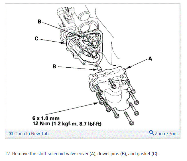

So I have my vehicle listed above it recently started giving me some acceleration problems. the weird thing about it is that if I turn the car off and back on it drives normally for a while until I try to go over 40 or 45. The car won't speed up and will still drive but only at a very low speed my RPMs rev high and I have to let off the gas that's when I'll pull over and turn it off and back on and it goes back to normal. I need some help figuring out what I need to replace before spending thousands on a new transmission. So I recently scanned it and got the following codes.
P0756 ACURA - Shift Solenoid 'B' Stuck Off
Dtc 70-03 A/T system malfunction
84-1 sensor logic failure
83-1Ecm/PCM relation failure code
Can anyone please guide me or help me understand what I need to repair. Thank you in advance.

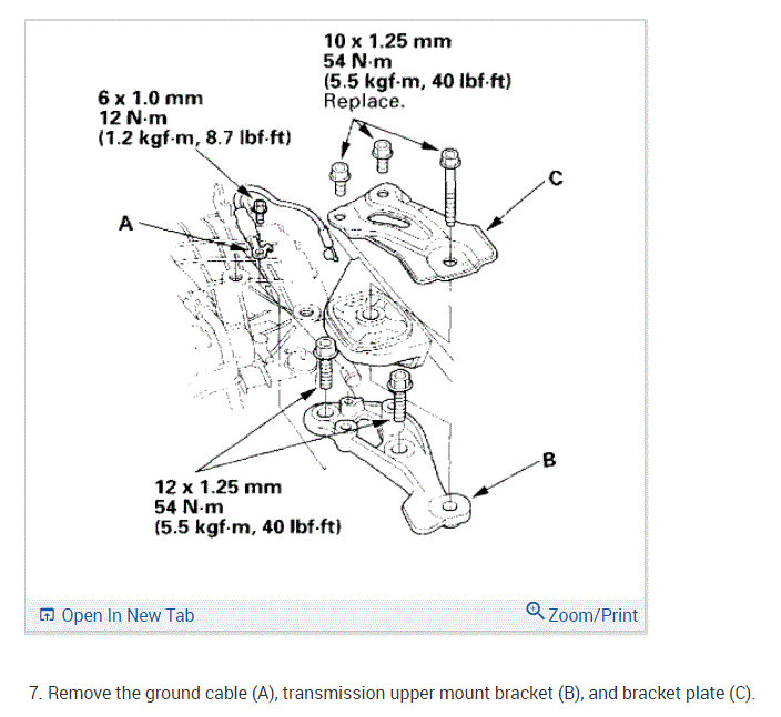

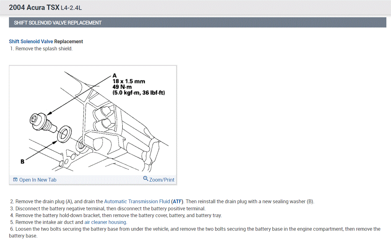

The idea that it revs high and you can't go faster leads me to believe it is related to the shift solenoid indicated in the diagnostic trouble code.
The shift solenoid is responsible for shifting to the next gear. Basically, it's the same as if you were driving a vehicle with a manual transmission and never up-shifting. (if that makes sense LOL)

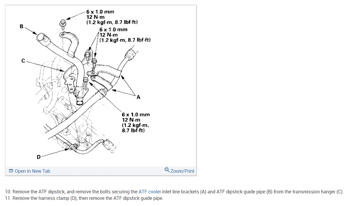

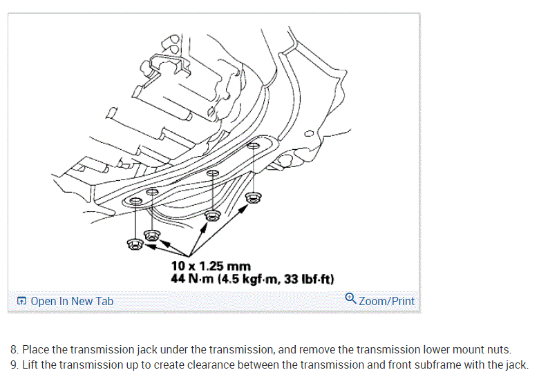

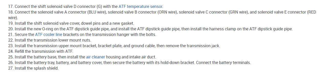

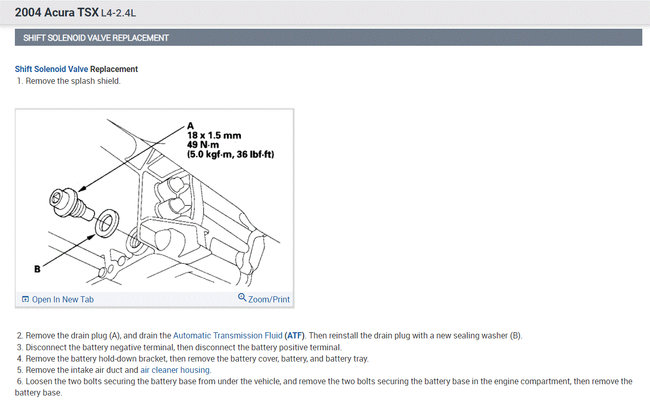

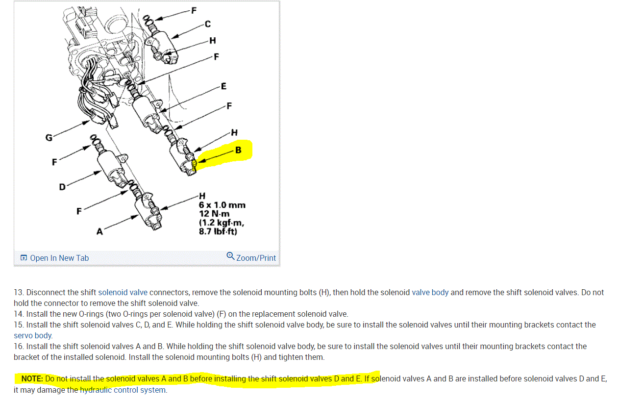

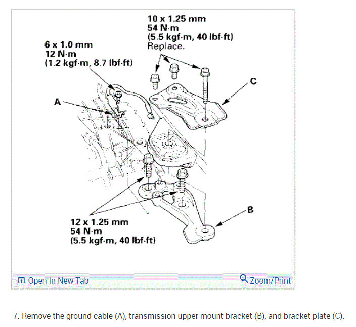

To replace the shift solenoid, you will need to remove the shift solenoid valve cover on the transmission. This will require draining the fluid, supporting the transmission, A/T cooler line brackets, and a few other things to access the solenoid.
I attached the directions for the procedure below. I highlighted the solenoid in question and an important note under it. Note that you shouldn't have to remove any of the other solenoids to replace solenoid B.
Aug 18, 2021 at 6:41 AM

So then solenoid b would be the last one towards the bottom on the right correct? I just want to be sure. So I'll just disconnect the connector and remove and place new one then connect it and put everything else back together.
Aug 27, 2021 at 12:13 AM
  • 110,240 POSTS
I looked at the pic from the manual and see why you may be confused. It does appear to be the bottom right. And yes, once you remove and replace it, put it back together.
Let me know if I can help in any way. Also, if you have a chance, let me know how things work out for you. I'm interested in knowing.
Aug 27, 2021 at 12:30 PM

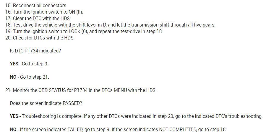

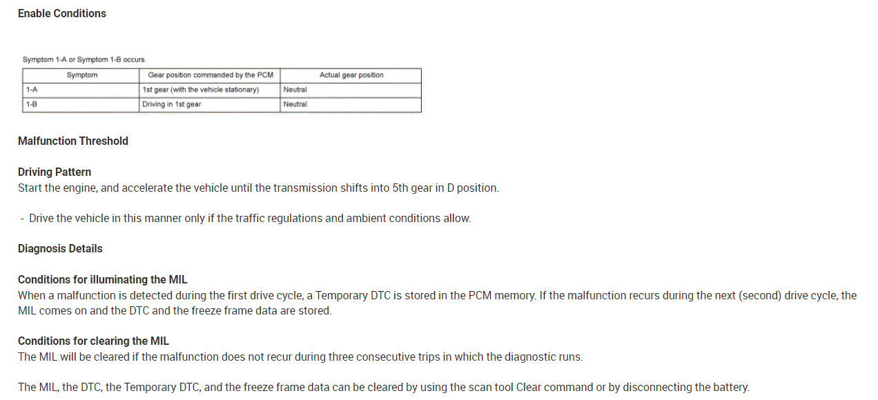

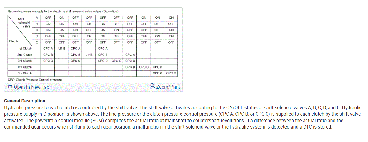

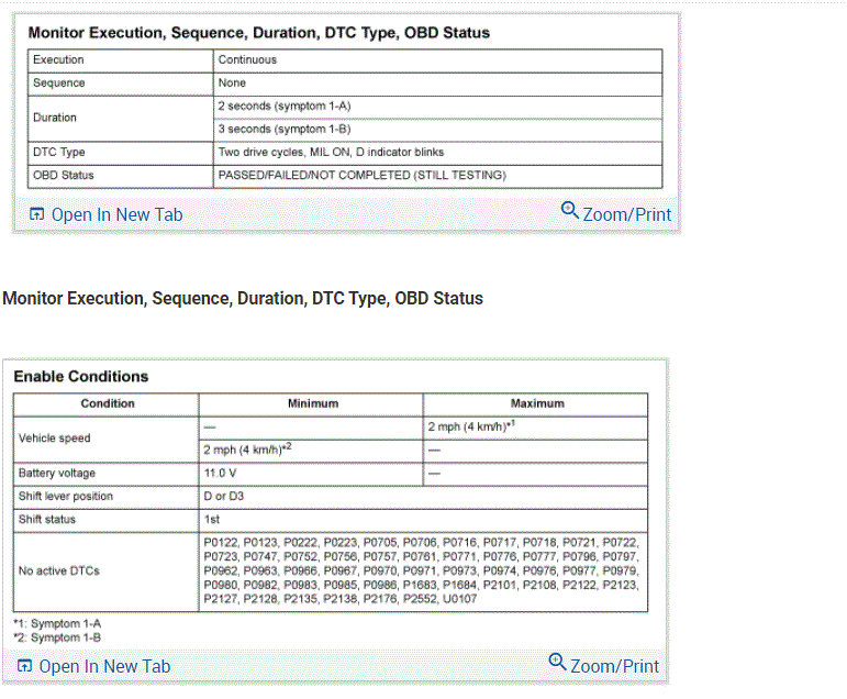

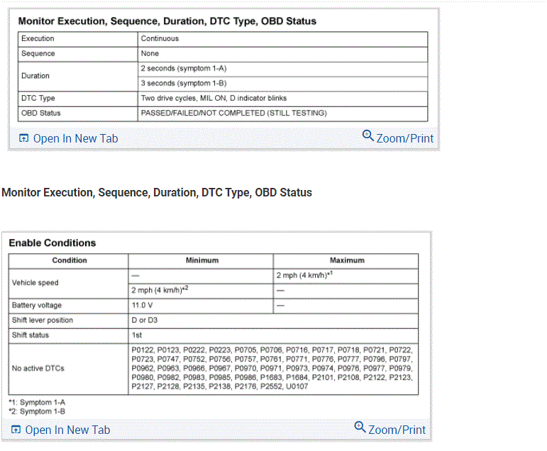

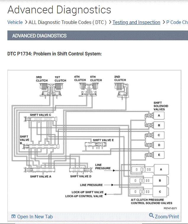

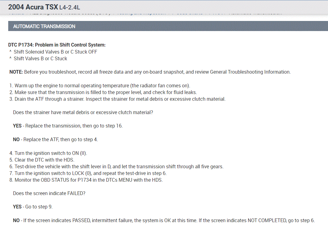

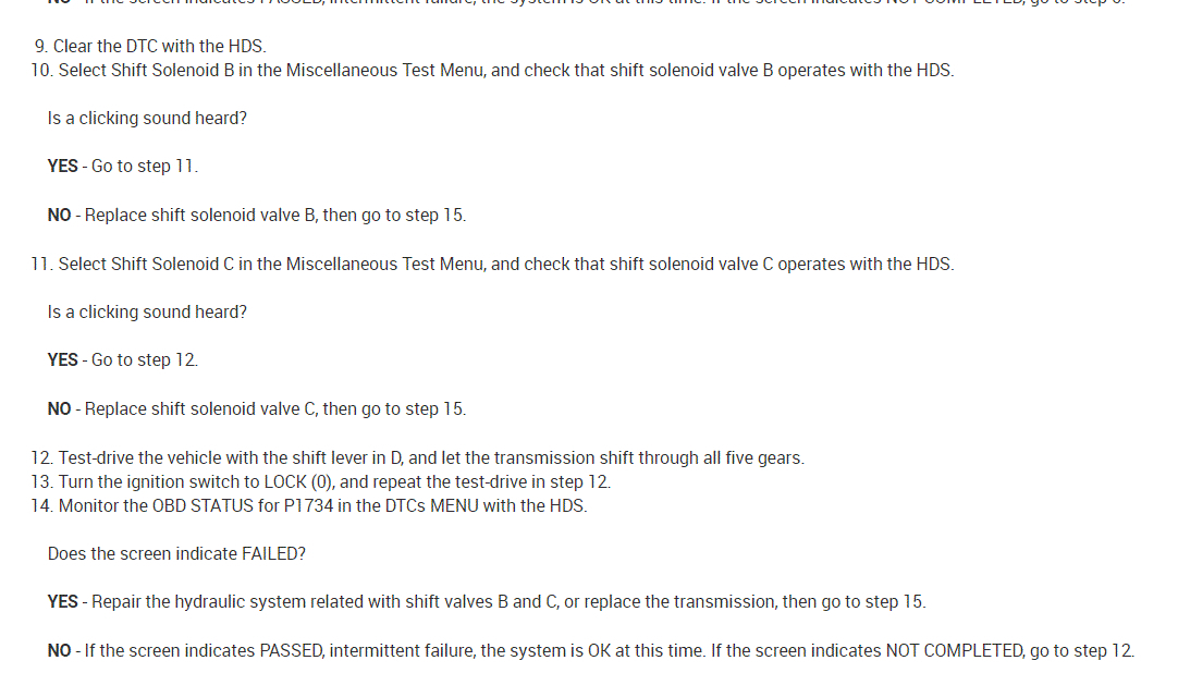

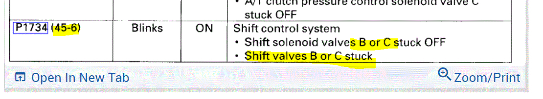

The code you provided, 45-06 (P1734), can be either with solenoid B or C. Your last post is the first I saw it. Do me a favor. Take a look through the diagnostics below and let me know if you are comfortable performing them. You will need a scan tool that can actuate solenoids.
Note: The first pic below shows the definition of the code, pics 2 - 4 are the diagnostics, and the last pics are advanced diagnostics.
Let me know. And again, I don't (at this point) feel the transmission is bad.

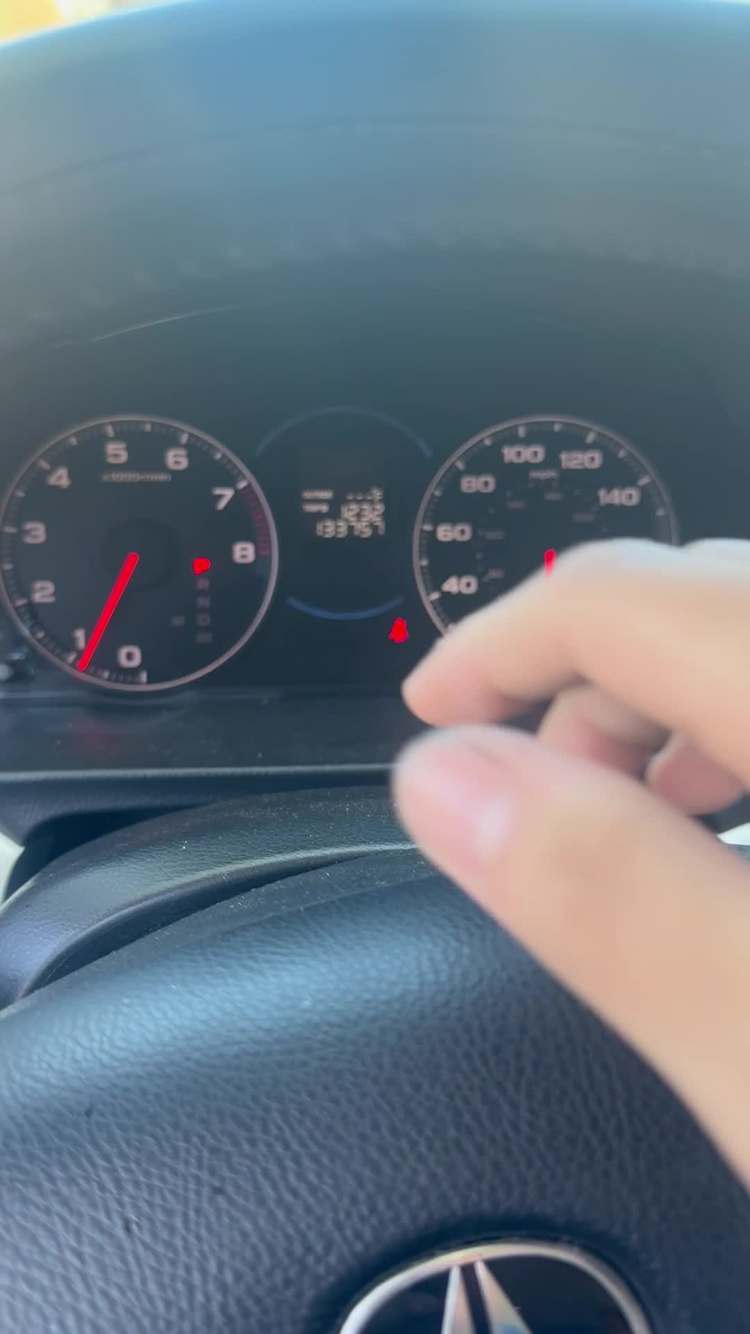

Here’s the video lmk if you can see it I’m kinda having trouble sending it
Jun 21, 2026 at 3:37 PM
  • 55,224 POSTS
Thank you for the video, it helps, so can you tell me what you have done so far?, New fluid or shift solenoid? Also, I would clear the codes and then start the engine without putting the car in gear and run the codes again. We are trying to see which code comes up first.

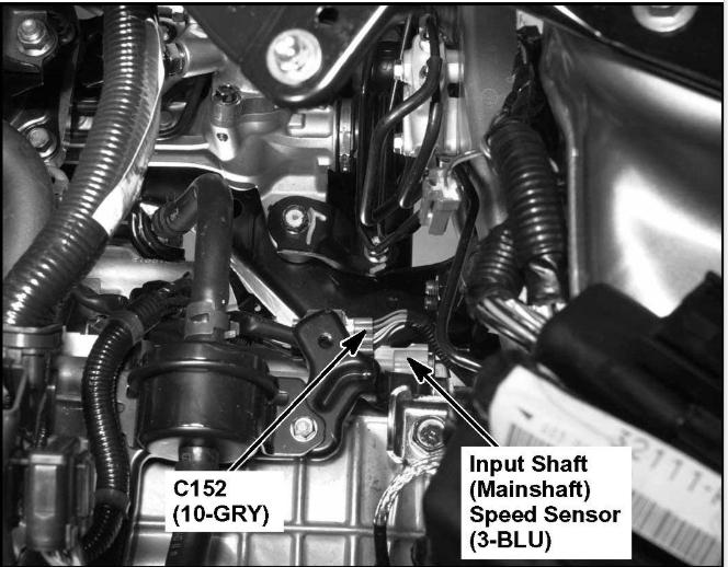

Can I ask if the fluid was burnt the first time you worked on the transmission? IF so the clutches might be toast and all the fluid and solenoids will not help it, but if the fluid was okay I would swap out the input shaft sensor. Here is the location. Check out the images (below). Let me know how it goes
Jun 24, 2026 at 8:23 AM
HONDABOY05TSX
  • 9 POSTS
Hey so i changed it but i think that photo has the wrong location thats the output sensor and the input sensor is more behind towards the firewall But anyways i changed the input speed sensor and nothing.. The fluid still looked bright red not dark tinted and it also didnt smell burnt and i also strained it and there was nothing it was clean
HBTSX
Jun 26, 2026 at 7:33 AM
  • 55,224 POSTS
If the fluid is good this can be a valve body issue or the PCM. I would go over your work again to see if you missed anything. Also I would try clearing the codes and then do not drive the car and then start he engine to see what codes come up so we get the most relevant code first.
