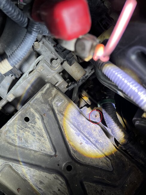

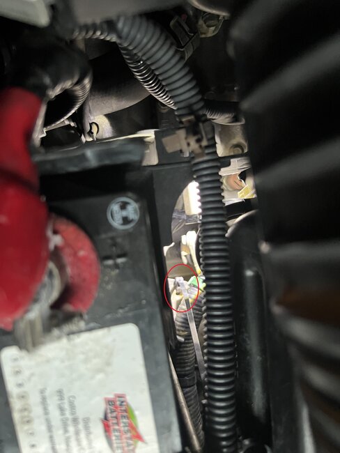

I hear rattling noise while driving the car. I see that one bolt on the battery tray is missing. I tried M8-1.25 and M8-1.0 bolts. It seems to be the right size. but it does not go in. see pics attached. Since I couldn't find the right bolt, I have it tied with a zip tie.

It looks like from the photo the hole is an oval. Maybe the bolt head broke off? M8 seems a little small.
Have you removed the tray completely to see what is underneath that area? If not, I would take out the whole tray and see if it was a thicker bolt that broke. If you do see if you can take a couple more photos of what the bolt would go into and send them to me.

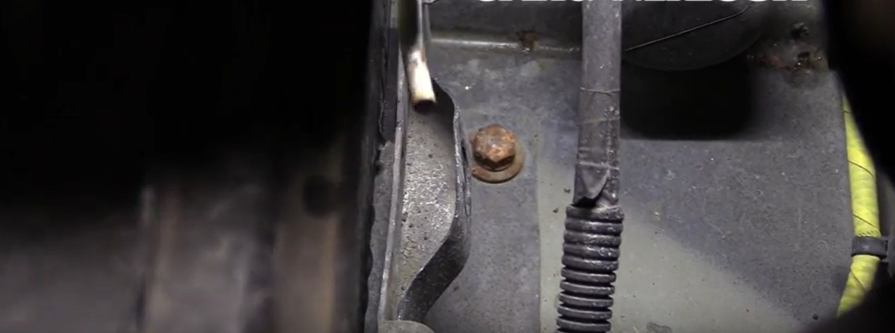

I have added a picture, it looks like the right area to me. Take a look and see if it is. If it has broken off, you will need to drill it out and use a tap to put new threads in it.
I have added a video, tools and links to help you do this if you need to.
Here is a good video that will show you how to drill and tap a broken bolt:
https://youtu.be/YDt5OUIZTs0
I suggest using some oil or PB Blaster periodically as you are drilling to lube the drill bit and drill slowly. This will keep the bit from getting hot and dull which will break the drill bit. If it breaks, you will not be able to drill out the old drill bit because it is hardened steel, so take it slow.

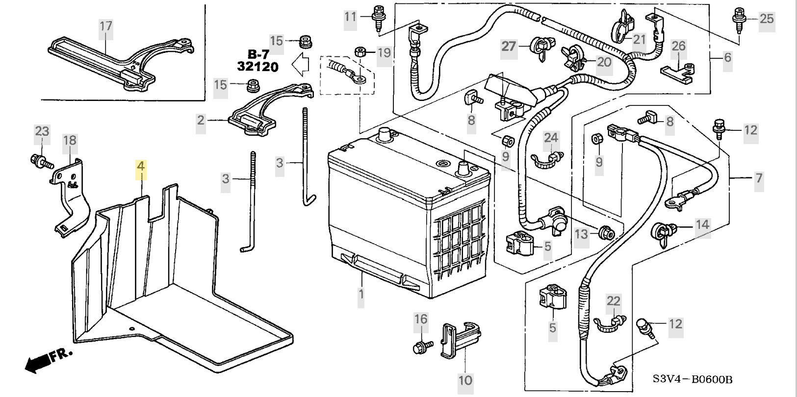

I have also added a picture from the Honda catalog of the battery area. I don't see a bolt in that area, but this image is a little different than what the dealer has. So, you could take this image with your VIN and see if they have a better image. They might have the bolt in stock.
