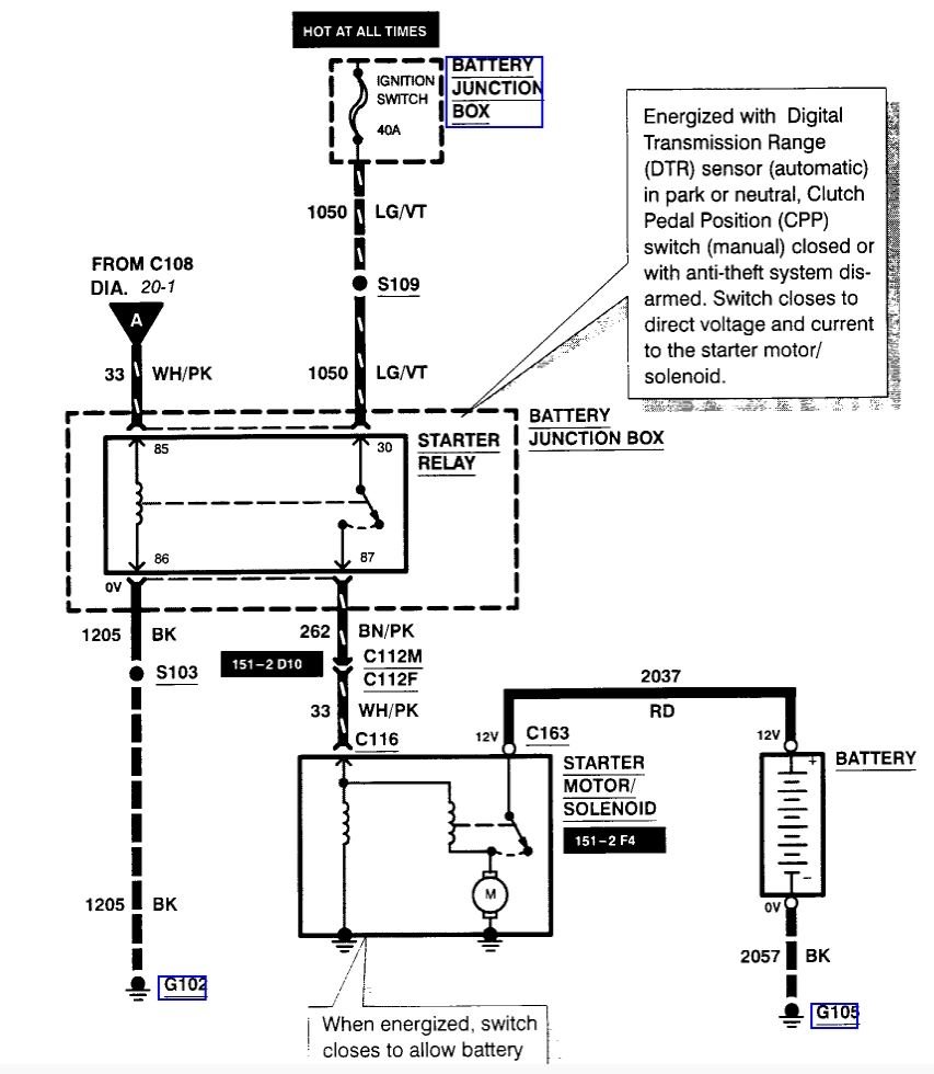

Had bad gasket on thermostat, radiator went out and anti freeze covered top of engine. Stopped running. I changed radiator, coil packs, spark plugs, two starters (first one was bad from the start), new battery, new relay module from under passenger wheel. Well now anti theft light on is immediately and cannot get it to crank at all.

Does the anti theft light go out after about five seconds with key on?
If you think it is hydro locked, remove the plugs and crank it over.

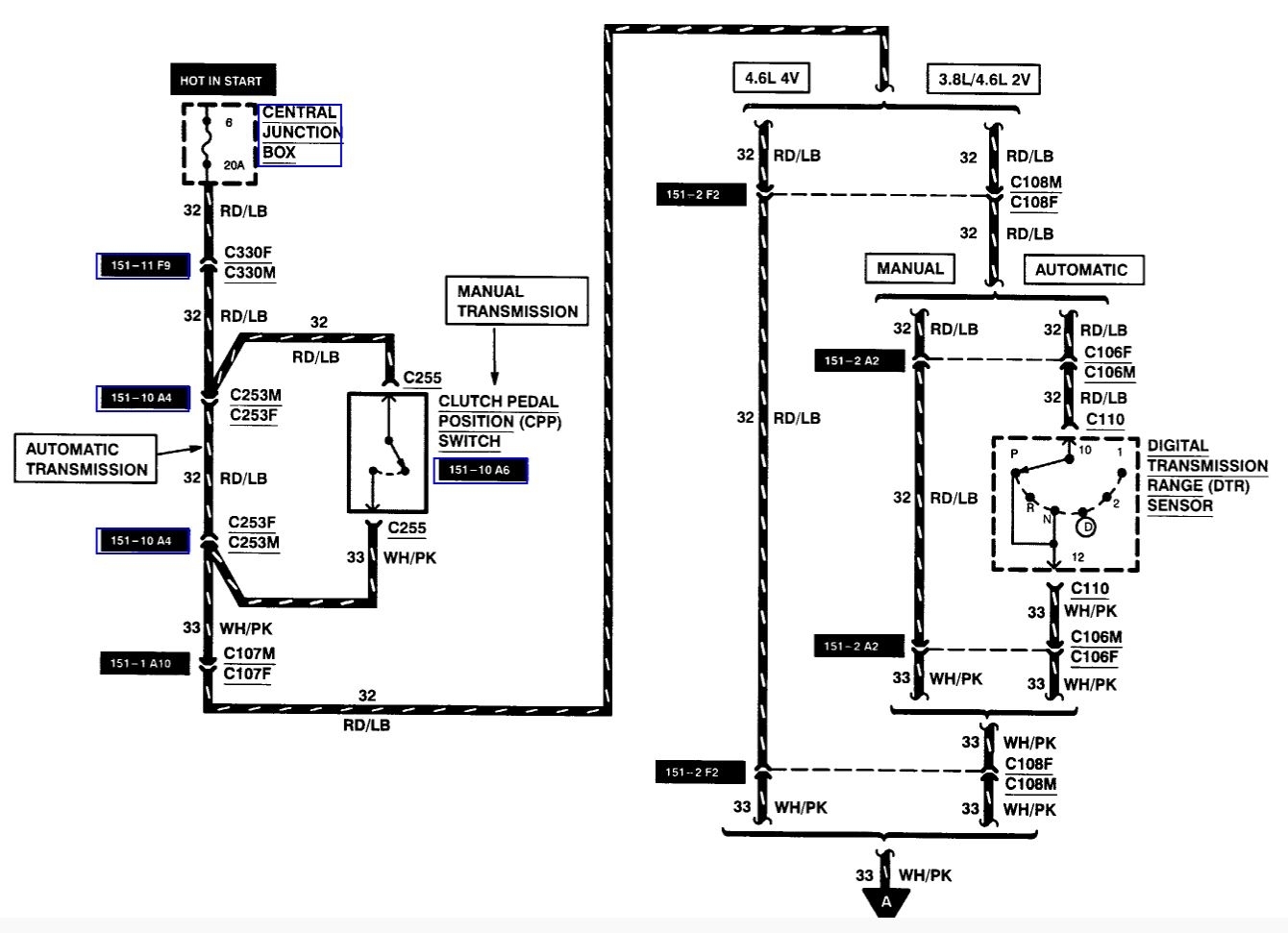

The security system will not prevent the starter from cranking the engine over and unless you had a blown head gasket also, I doubt also if it is hydro-locked. The engine could possibly be just plain locked up from the overheating. See if you can turn the engine over by hand. Remove all the spark plugs first to relieve all the compression, then try to turn the engine over again by hand if using the starter will not do it.
If though the starter is not even clicking or trying to crank over the engine check the starter fuse and try a new starter relay.
