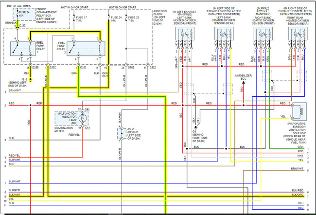

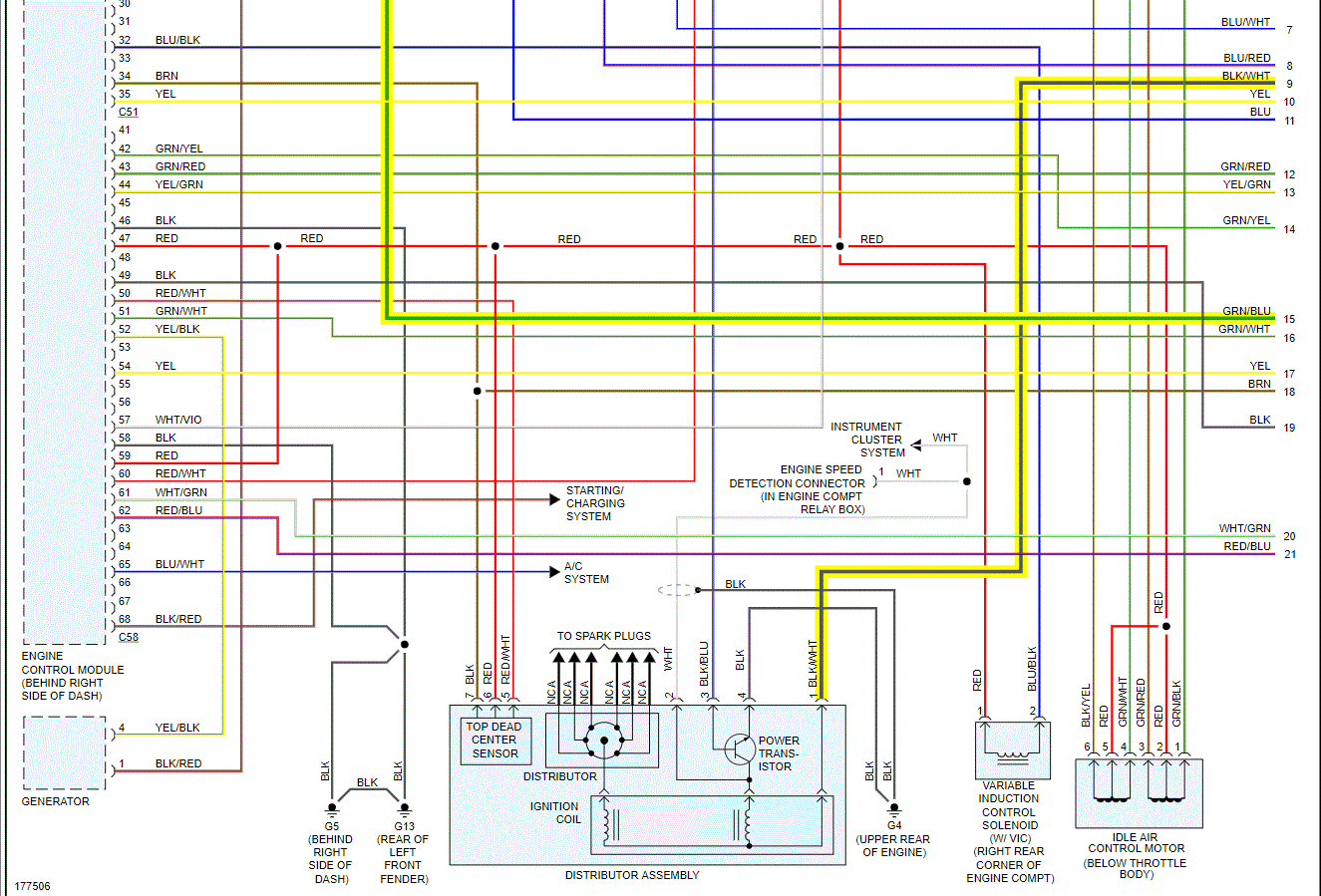

I'm having a random misfire and I have the code for a bad fuel temperature sensor but it was replaced. I just need to check the terminals of those cables which I know it starts on the fuel pump but I don't know where it goes after that specially on the front. Can someone please send me pictures of the Diagrams for those cables and if known where those cables are in the front? Thank you.

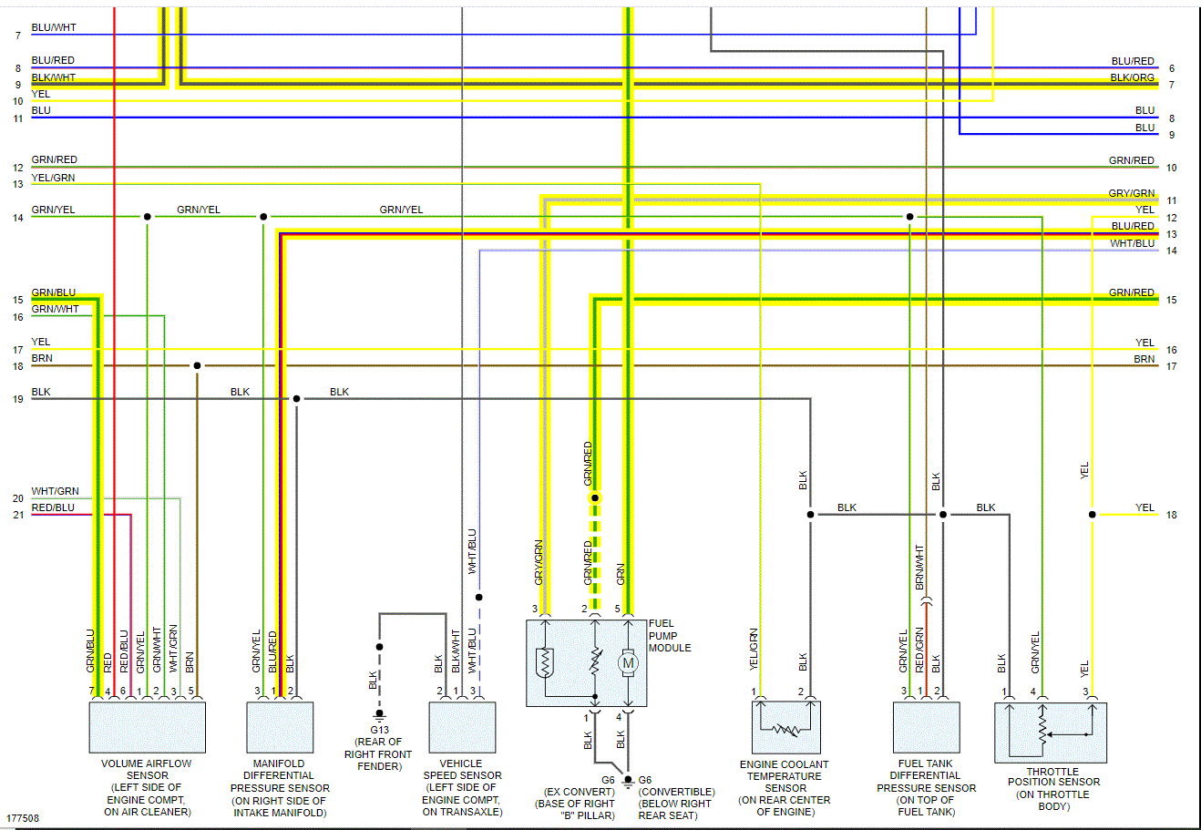

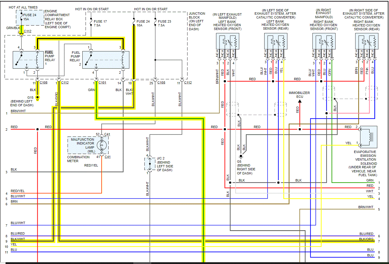

The fuel temperature sensor is integral to the fuel pump. The pump is located in the fuel tank.

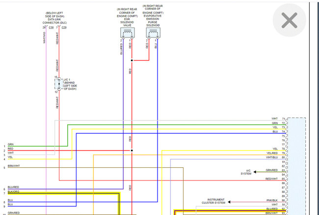

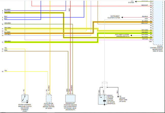

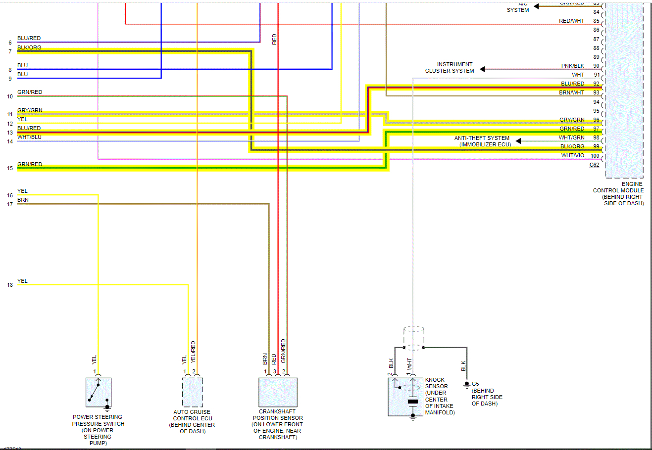

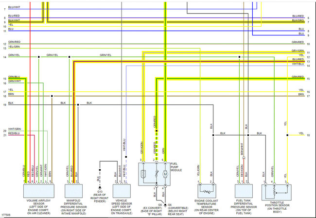

I attached the entire wiring schematic for the powertrain management system below. I highlighted the fuel pump wiring as well as the fuel tank pressure sensor.

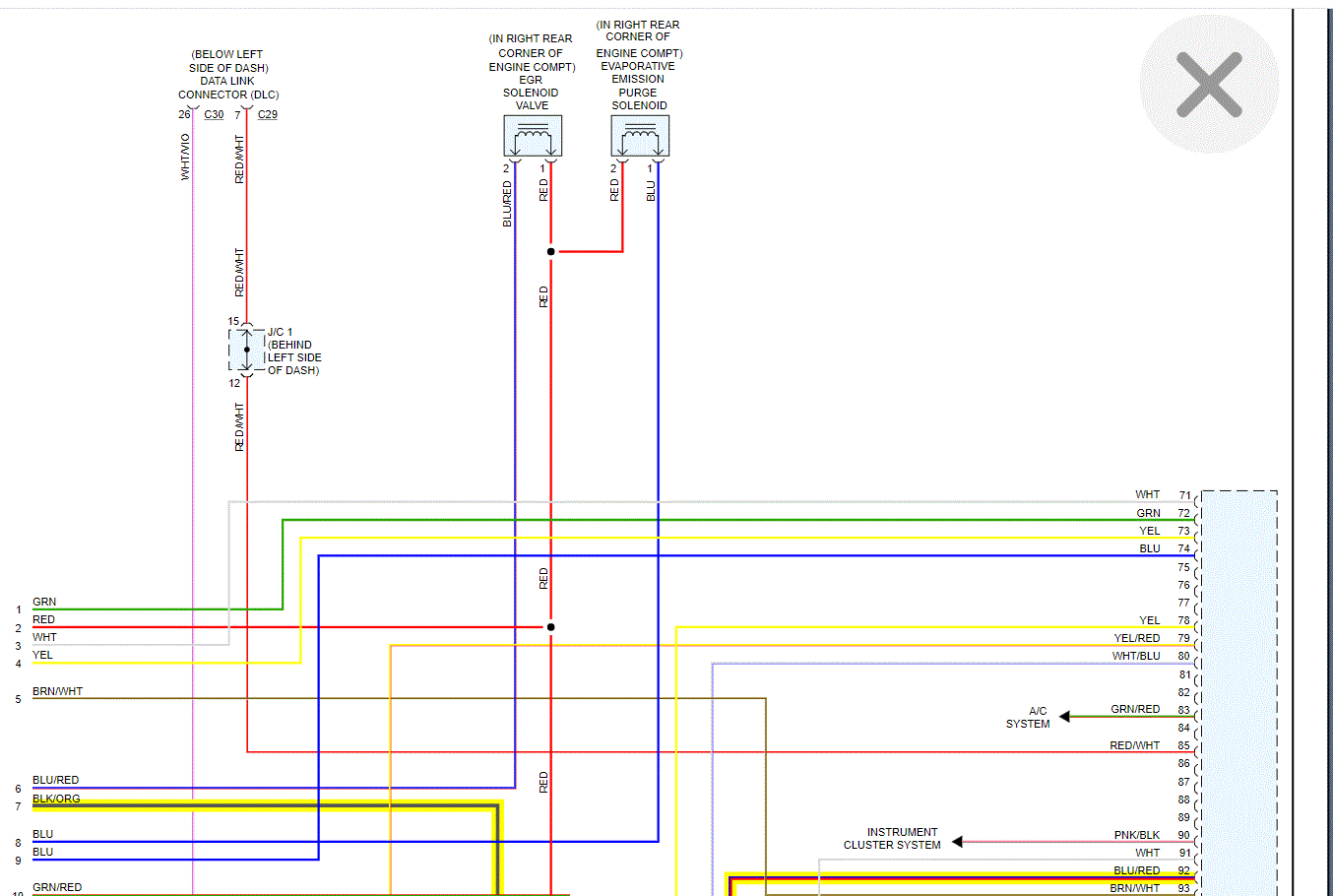

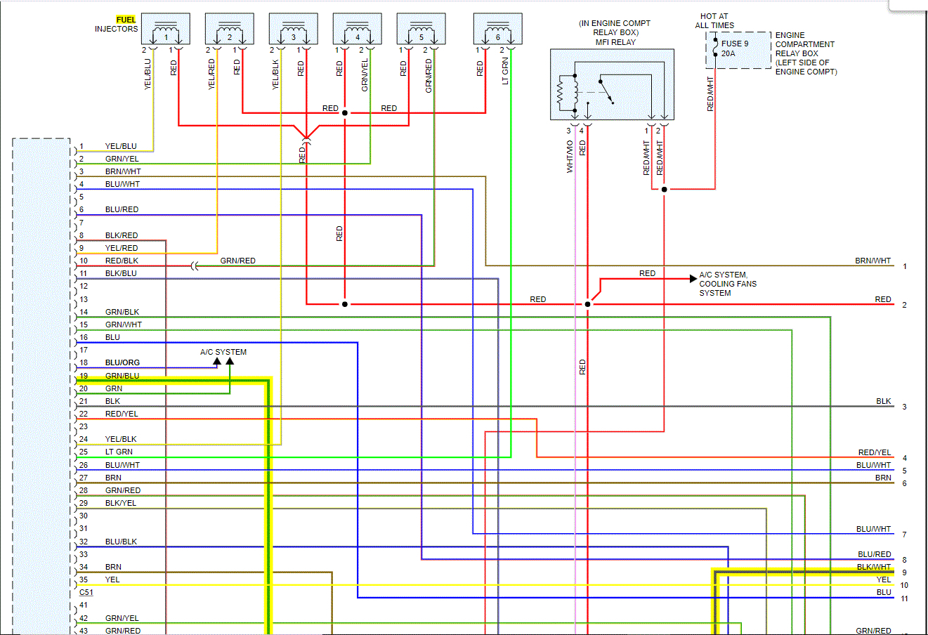

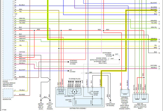

See pics below / Note: Pics have been cut in half to make them readable. I did overlap them so you can follow from one to the next.
