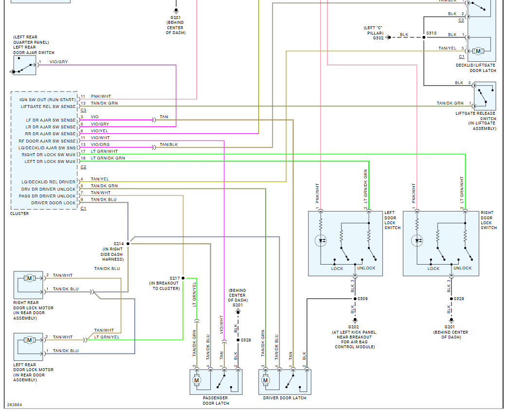

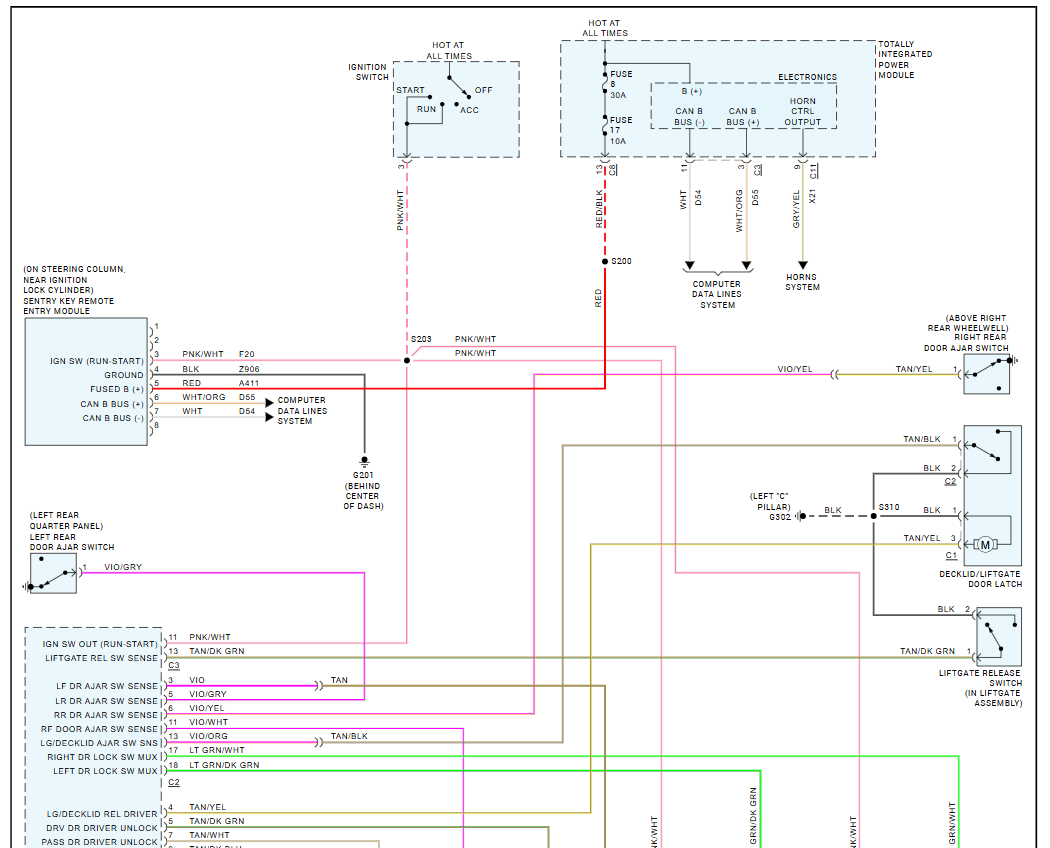

I looked up the wire diagram and i don't see any of the colors they tell me to hook into i know it's in the driver kick panel but i don't know what colors. any help will be helpful thank you. The wires I'm trying to find are for the door sensors. So, when I open a door, the alarm will go off?

Sure, here are the wiring diagrams for the security system so you can see how the unit works. Check out the images (below). Let us know if you need anything else.

Yes this is very help full but i really don't know how to read it i mean i do but is there any way that you can dumb it down for me i would really be thankful.

  • 55,711 POSTS
Wiring diagrams are like road maps, follow the wires and they show what they go too. The sensors are really switches. I marked the driver's side door latch for you. Check out the images (below). Let us know if you need anything else.
