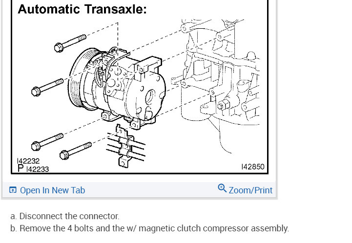

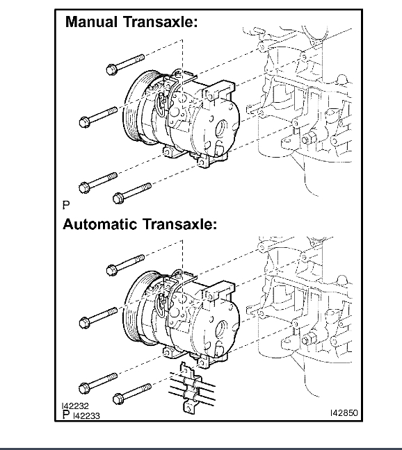

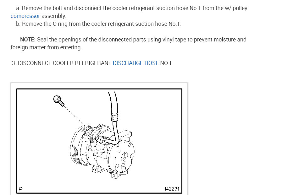

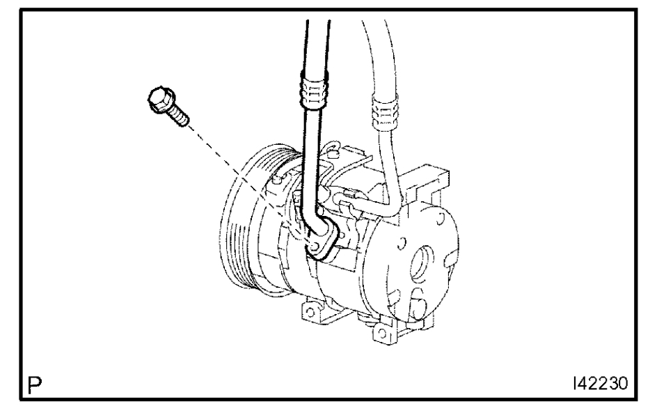

Okay, the decision is your but let me show how easy doing the A/C Compressor could be. In the diagrams down below I have included the pictures to the three steps needed for the removal of your vehicle's AC Compressor. The only other thing that is needed is to take the serpentine belt off which is a piece of cake. The installation is the same, just in reverse. Check out the diagrams down below and get back to us with what you decide.

What’s the catch? Do i need to take a bunch of stuff out to get to the compressor? Surely it can’t be that easy?

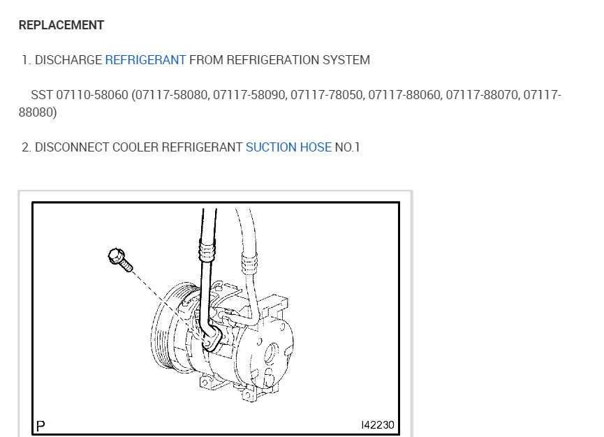

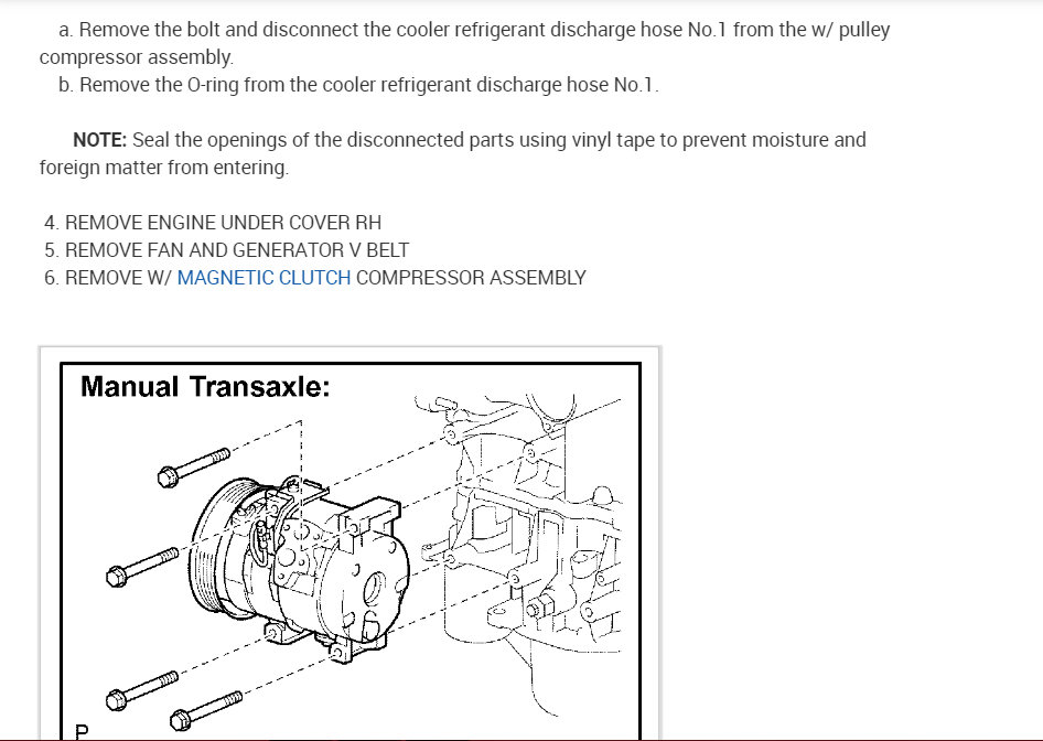

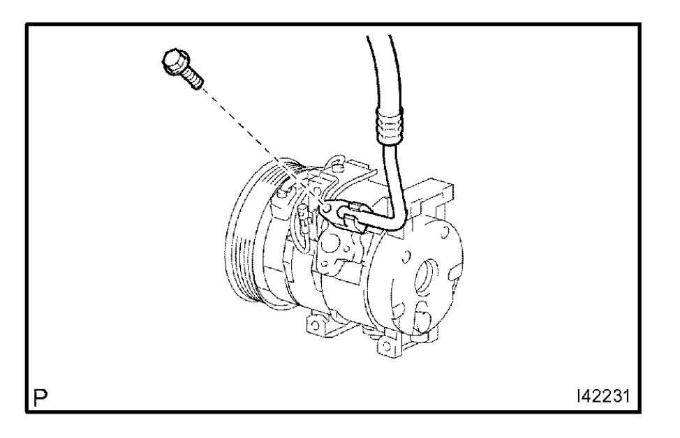

Here is the rest of the guide in the diagrams down below. Installation is the reverse of removal with a Freon recharge which can be bought at any auto parts store for around $30.00. Please go through this guide and get back to us with your thoughts.

I actually have manual transmission.
How would I discharge the coolant without a proper machine to do so?

That's right. I forgot that step. You wouldn't be able to do that without the proper machine for the collection and disposal of the Freon. Like I said, it's ultimately your decision and your's alone. Please get back to us with how everything turns out. Remember, we are here for you 24/7/365.
