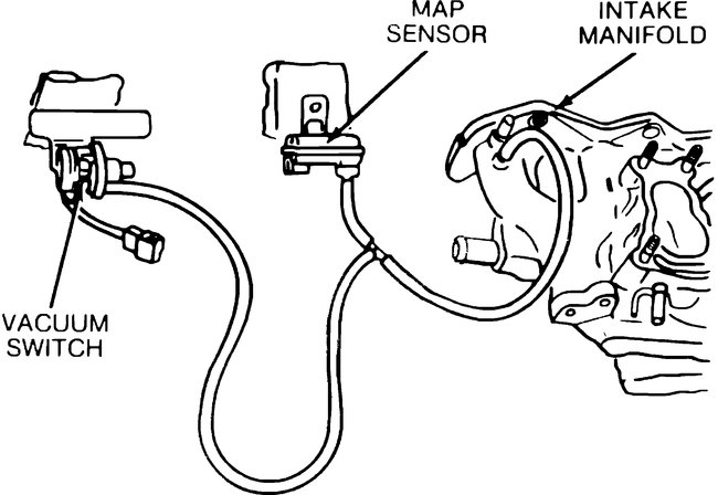

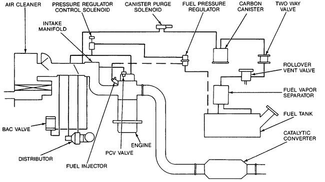

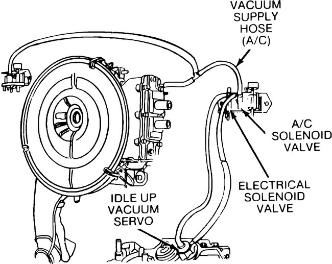

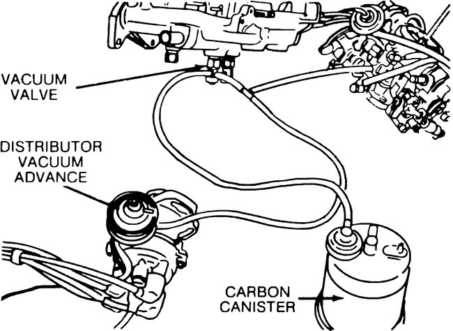

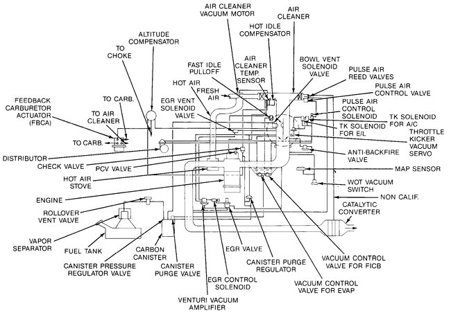

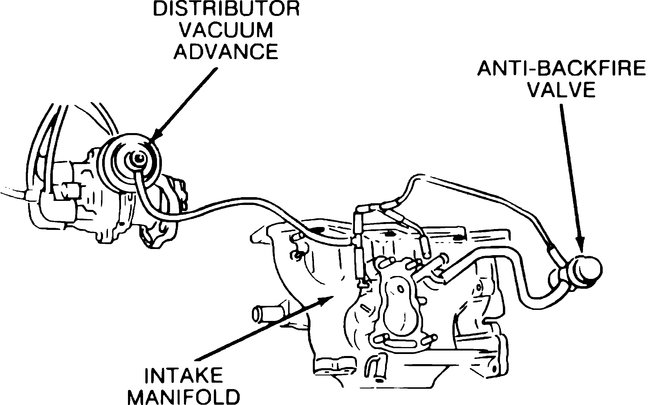

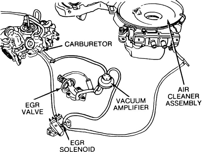

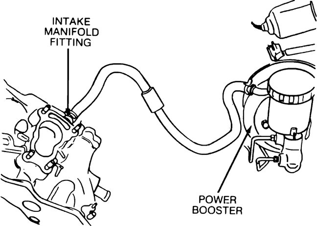

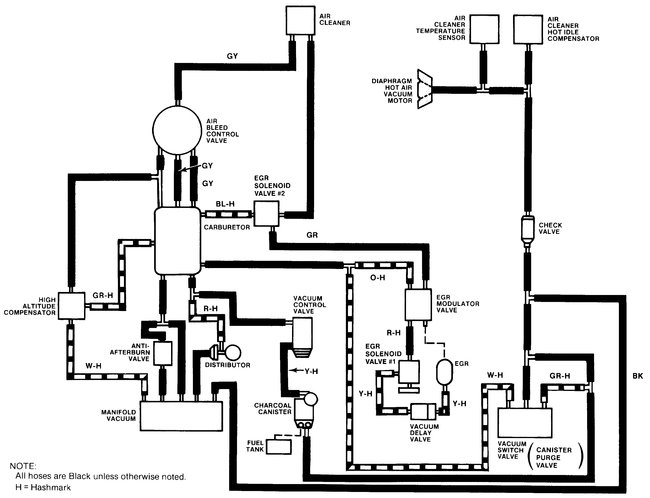

Previous owner disconnected several engine vacuum lines and I am not familiar with this 1988 Festiva setup. Would like a diagram (or something) to help reconnect the line properly. The location of a reliable web page or manual or anything would help and be greatly appreciated.

I have attached all the shop manual schematics for your review. They are broken down by components. The last two pictures are routing pictures. They basically show how the hoses ran originally. Picture 8 is for a carburetor design and picture 9 is for one which is fuel injected. I hope this helps.

Do not know if what I am looking for exist. All my vacuum lines are color coded. Looking for something that tells me what they are for.

Hi again. I am sorry. I looked through a few manuals and nothing indicates vacuum hoses by color. I can try to help you with the ones I sent. If you have a specific question or questions, ask and I should be able to help.

Previous owner did not replace disconnected vacuum lines correctly. Need to know proper order. Would like to see a good diagram (images if possible) of their proper connection order.

I think I may have answered this question for another post. Not sure if it is you or not, so here are the schematics.
