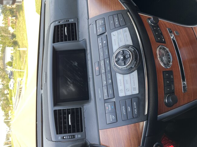

This happened in the middle of the day when I left the gas station. Random. It started about 24 hours ago. Since then, the screen and A/C control module came on twice for a short period of time. I can’t adjust the AC since the control module using working. None of the buttons on it works. And when it randomly came on twice all of the buttons worked the way they’re supposed to.

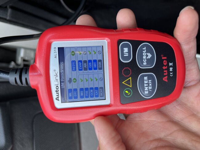

I received the scanner today. It has OBDll/EOBD & ready test. How do I scan the CAN-bus? Thanks
May 29, 2023 at 5:16 AM
M45MIKE
  • 14 POSTS
I scanned it. No codes. All monitors came back with green check marks.

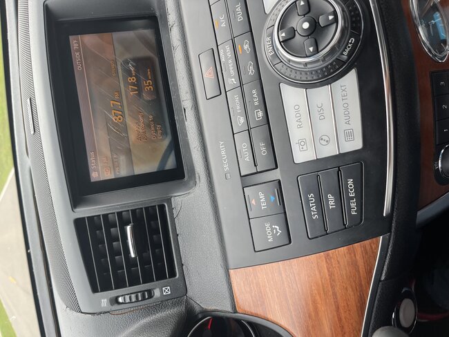

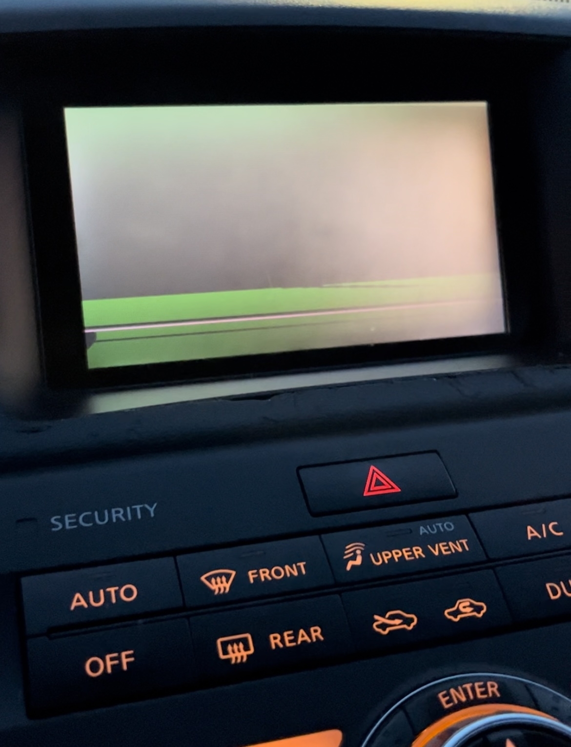

Here’s my monitor and AC module while driving. The monitor was flickering yesterday but never turned on. The buttons light up on the module with the rest of the interior at night but the indicators on each button doesn’t light up.

First, I'm sorry for the delay in getting back to you. It has been a bit crazy. Regardless, if there are no codes, my first suspect is a loose connector. It could even be a fuse in the fuse box that has a poor connection. Have you been able to check those things?

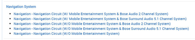

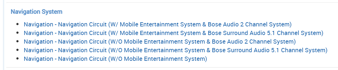

Let's try looking at this from a different point of view. I have wiring schematics that I would like to review, but there are multiple options. Could you take a look at the pic below and let me know which you have?
See pic below.

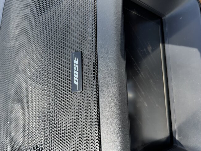

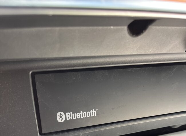

I’m not sure. I have an 06 M45 Infiniti base model. It does not have navigation. It does not have a DVD player. There’s a Bluetooth box in the glove compartment. It does not have an aux. it does have Bose speakers.
Please let me know if there’s a place on the vehicle where I can get this specific information.

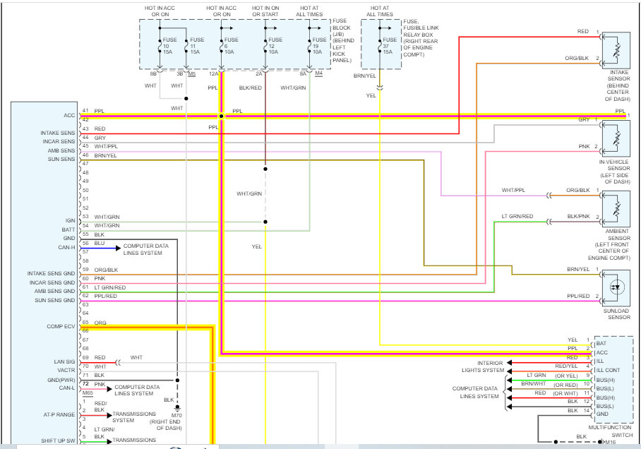

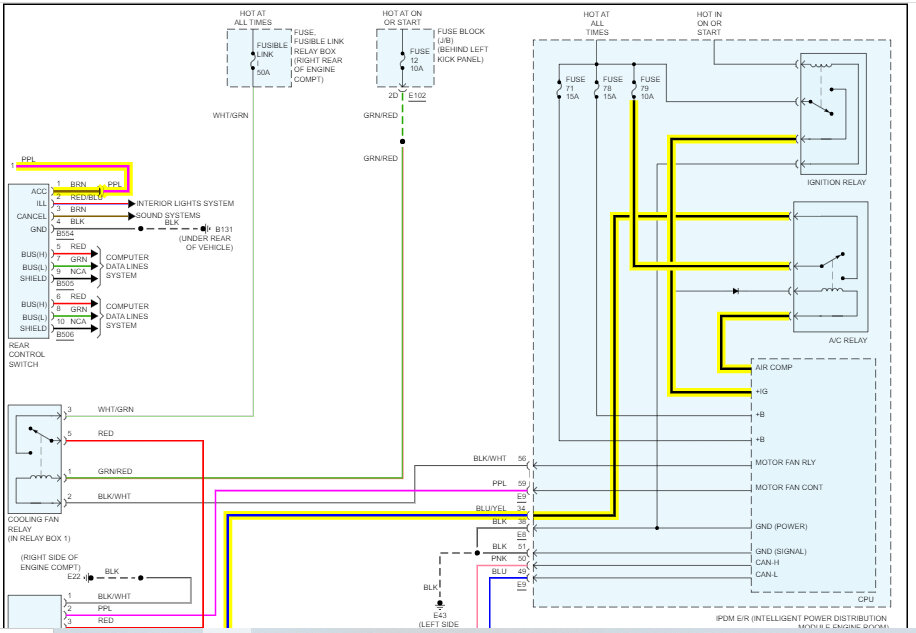

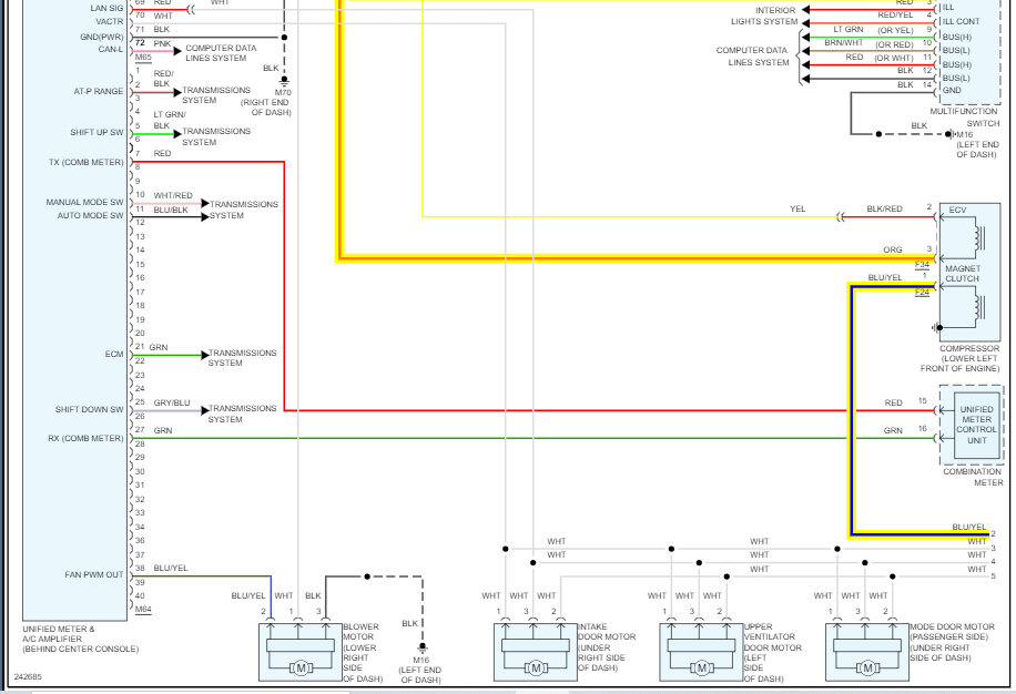

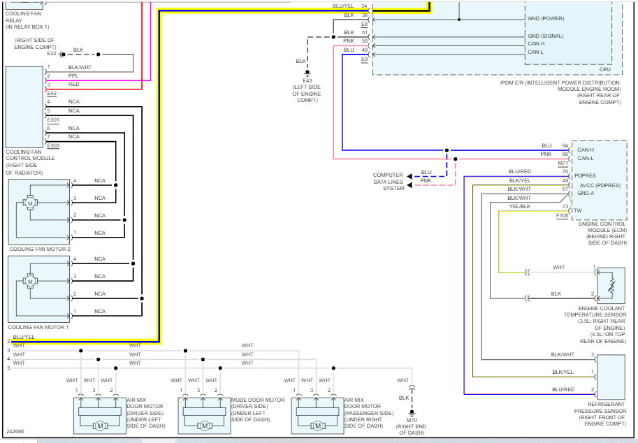

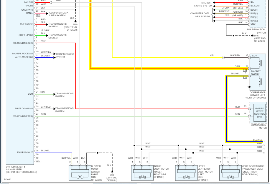

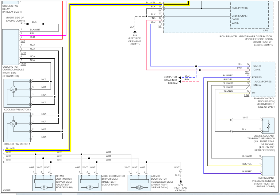

I attached the wiring schematic for the HVAC controller. The best thing to do is to start by checking connectors and making sure there is power to the unit that is required.
Note that the wiring schematic I attached was two pages. I had to cut each one in half to make them readable. I did overlap each so you can follow from one to the next.
Let me know if you are able to find any issues.
See pics below. Also, run the scan tool again to confirm there is still nothing related to the can-bus.

Okay. So far I installed another control unit & display and same result. Flickers. It doesn’t seem to be the units.
Regarding your message I just stick the voltage meters in the ends of the coneectors right?

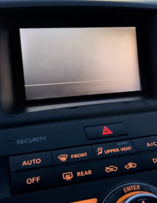

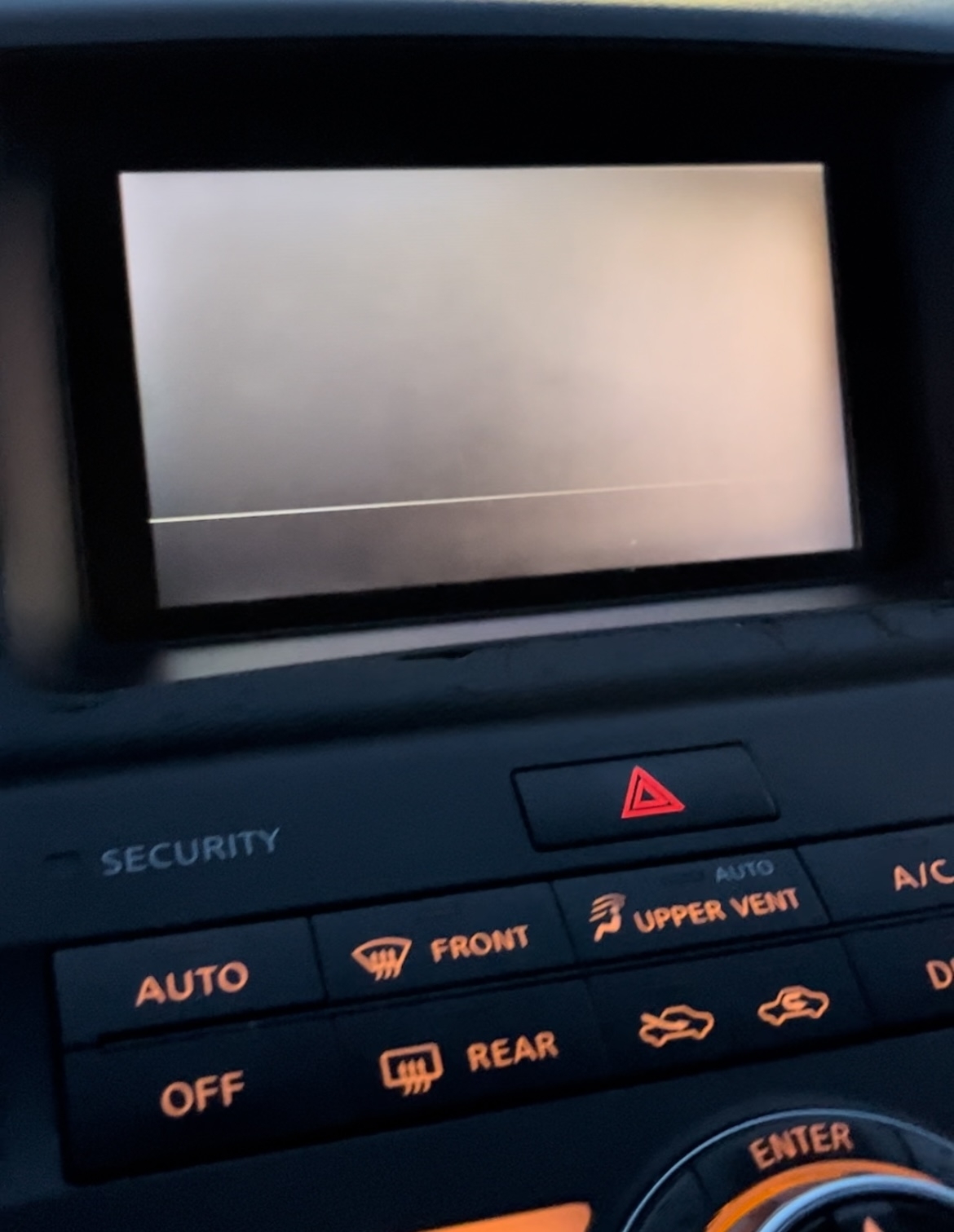

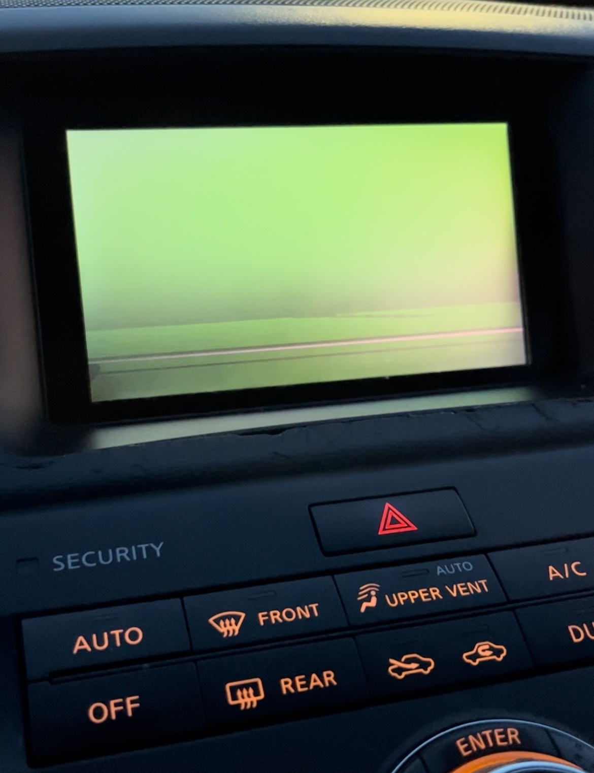

Okay so far, I checked all fuses with the car on acc with a circuit tester (not running). The fuses that don’t light the tester are fuses 72 74 76 and 86. Not sure if those have to be tested with the car running or not. My headlights do work. I will check male ends of wires to the screen and control module tomorrow for voltage. And attached is a picture of how my display looks flashing.
