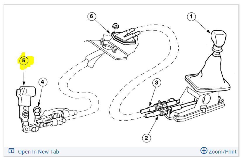

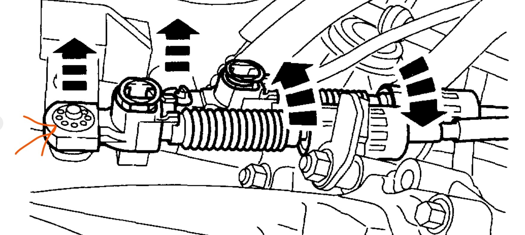

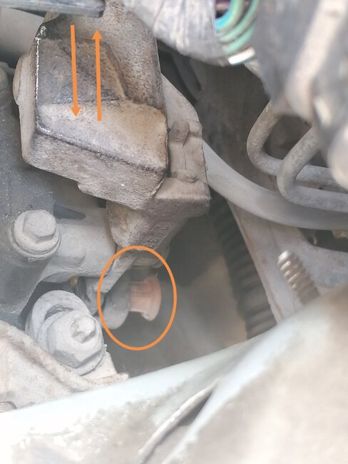

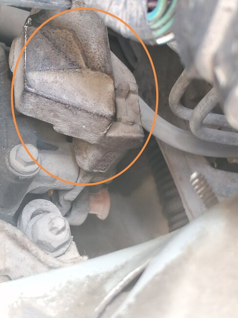

What is the name of the clutch part circled on the picture? It is Zetec engine.

I could be wrong, but I know this part is a counterweight for the shift arm.
Jun 29, 2024 at 12:50 PM
  • 110,240 POSTS
Mercury identifies that as a transmission shift lever. Although, it could be considered a counterweight.

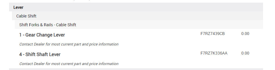

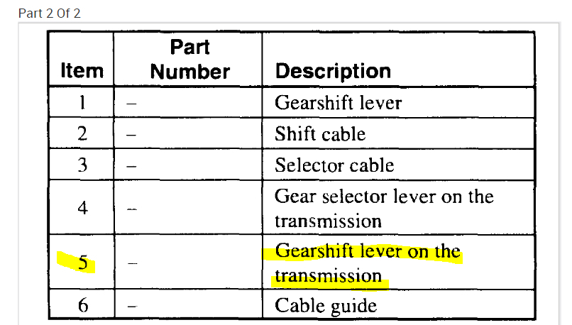

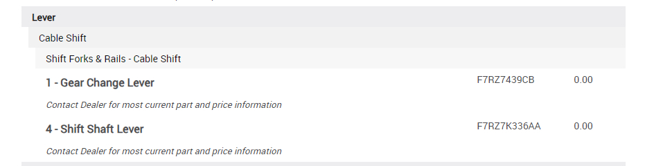

I attached an exploded view below (pic 1). Pic 2 is the parts legend. Pic 3 is what it is showing me as part numbers for that lever.
Let me know if this helps.

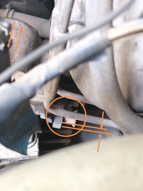

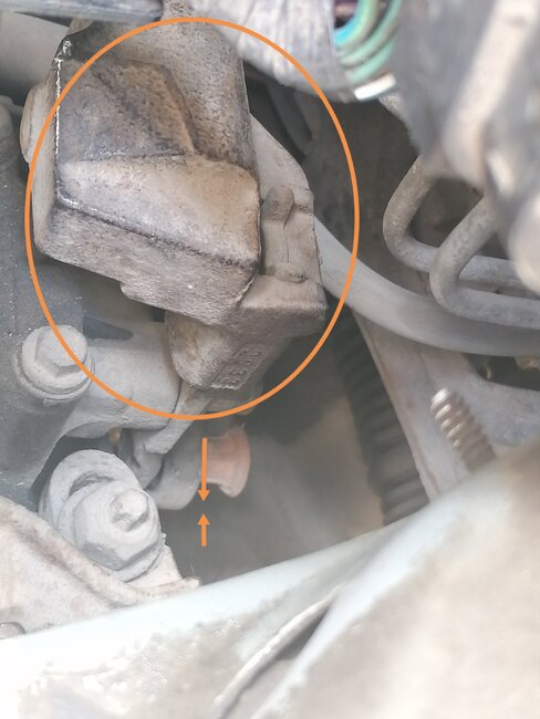

When you move it slightly forward-backward, it has free moving (empty space) around the circled yellow plastic pin about 2-3 mm. Should it be like that, or what should I do?
I came to this question because of a problem of sudden stalling (sometimes on road holes, sometimes when gears shifting, sometimes accelerating, and after lot of inspections (injectors, fuel pump, inertia switch, relays, ignition pack) noticed that an armor hose carrying lot of cables is touching to this part. When inspected, the hose was even damaged on the touching bottom (luckily wires were all okay). After fixing the hose upward with a plastic tie, the problem did not appear in the next few driving's.
Thanks for your patience and time.

The piece hanging out of it is the bushing that should be inside it. They snap into the end of the cable. You can get replacements at many parts stores, but you need to take the old one to match it.
