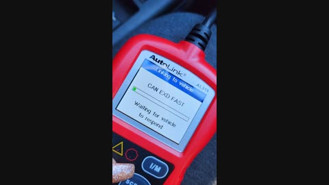

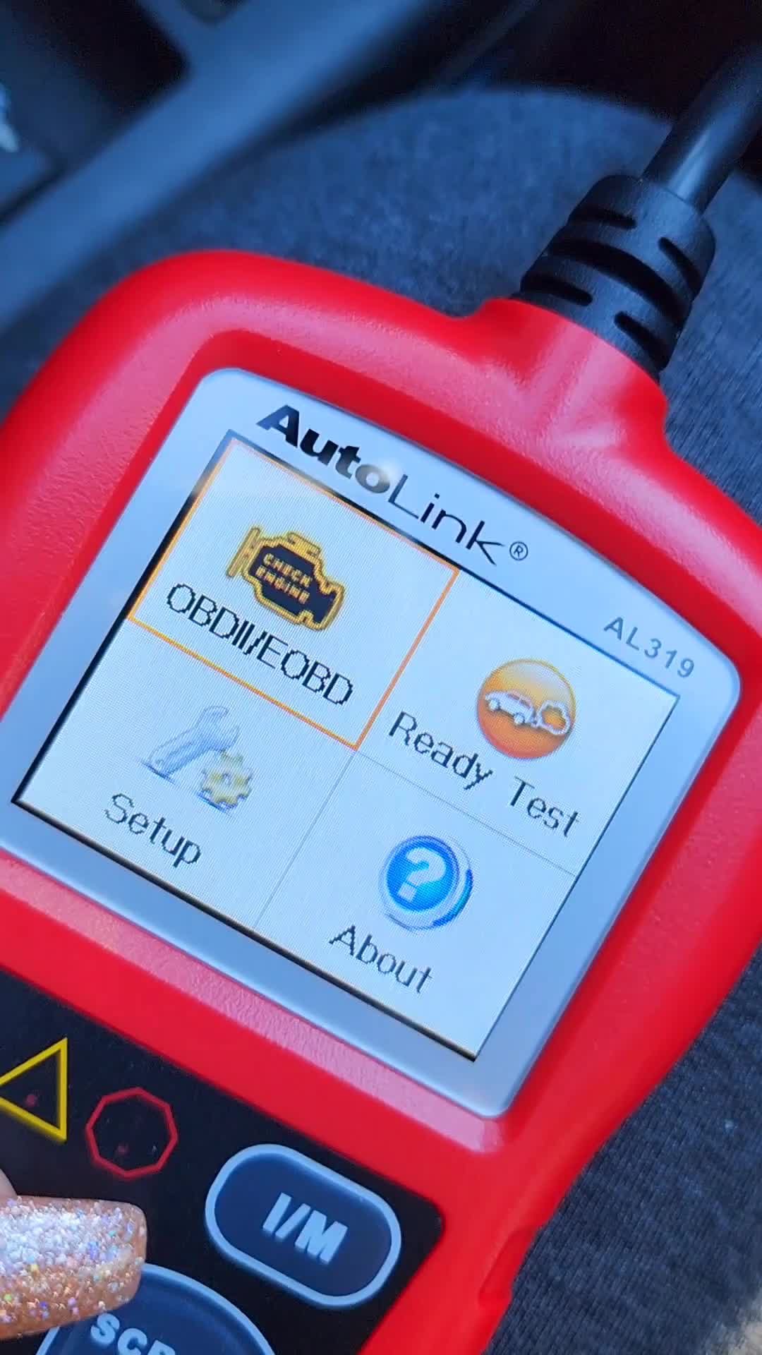

STORM23
  • 7 POSTS
Sorry about that, but the scanner arrived earlier than expected. I included a video, but unsure if there's anything useful from what I captured?
Reading was done with the car on, but engine off.
Nov 30, 2023 at 12:46 AM
  • 55,381 POSTS

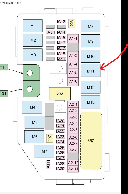

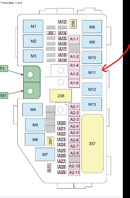

Can you please take a video of what the car is doing again, the first video you uploaded is too short. Thanks for the video of the scanner, the readings looked normal. I am thinking you may have a battery draw; let's try removing the A/C compressor control relay to see if that makes a difference. Here is a guide and the location of the relay:
https://www.2carpros.com/articles/car-battery-dead-overnight
