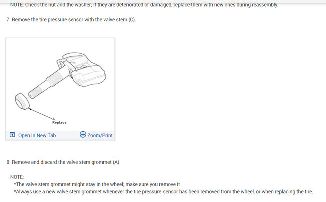

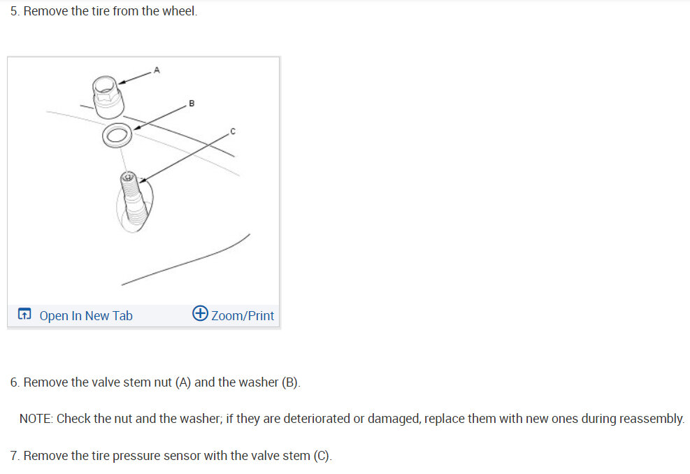

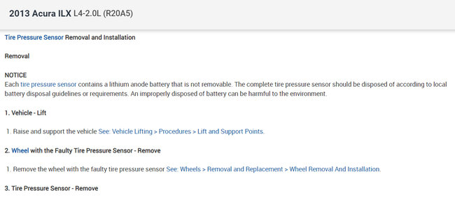

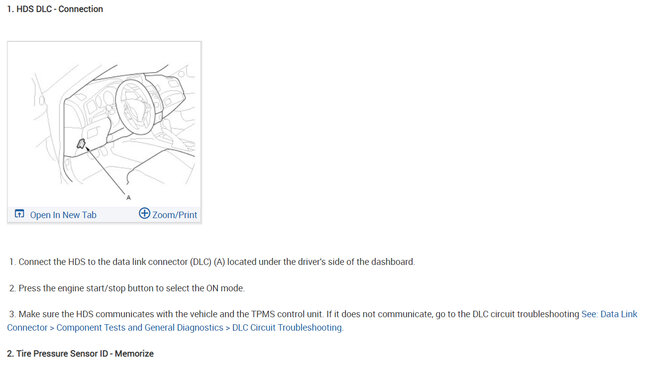

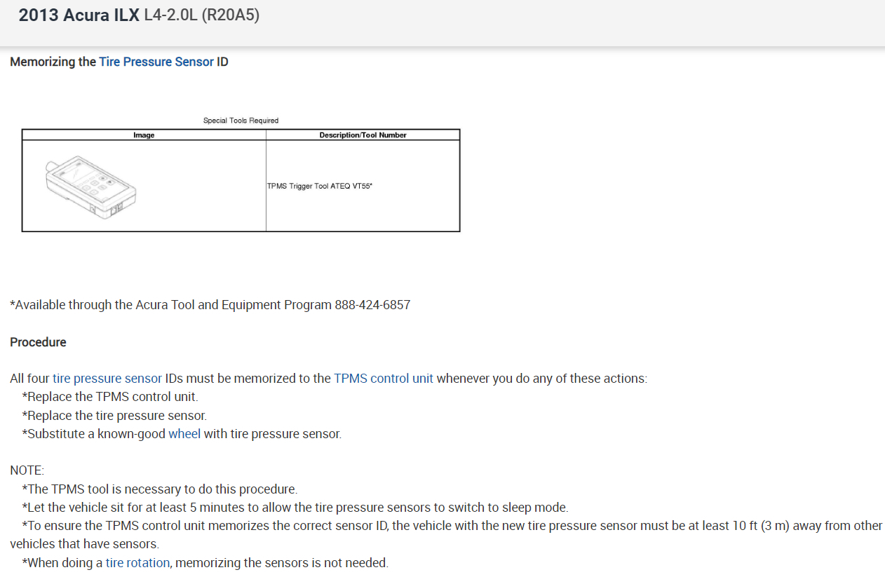

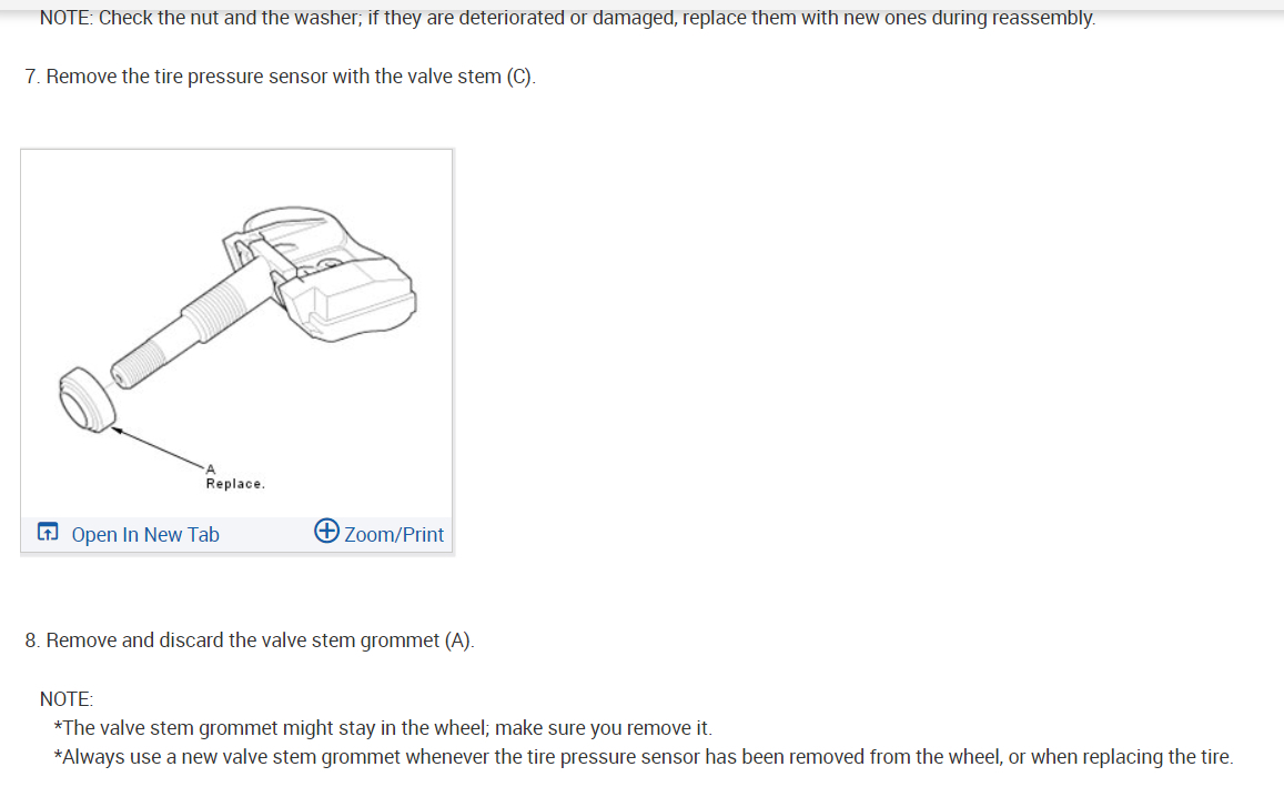

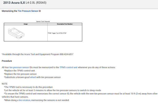

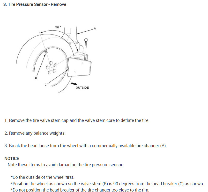

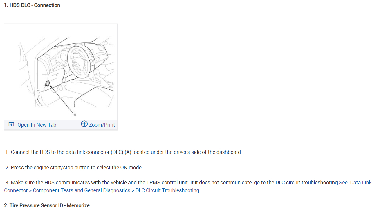

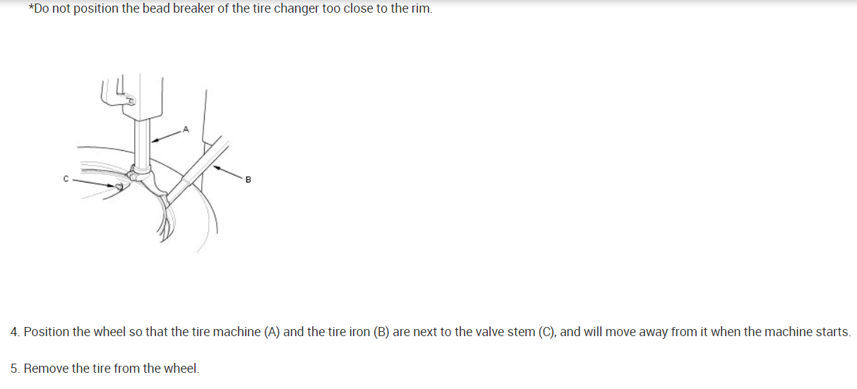

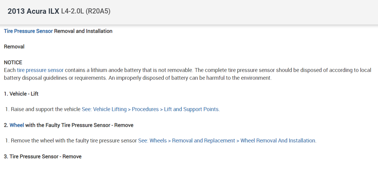

So when they fixed the tire, they must have damaged the tire pressure sensor which is common. Here is the part you will need to replace. These cars were made since 2013. Check out the images (below). Please let us know what happens.
