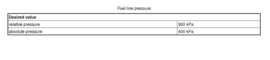

Sorry, I have a S40 not a V40. Not sure where the V40 came from. I'll check the connection on the sensor. Is 82psi "high". I think I saw somewhere the "normal" fuel pressure is 40psi.
Oct 22, 2019 at 7:46 PM
  • 110,194 POSTS
Welcome back:
No problem. They do make a V40, but it's not available in the US. As far as the pressure, that is too high. Picture 1 shows the manufacturer's specs. It indicates 300 to 400 kPa (kilopascal unit of measurement). That works out to 44 to 58 psi. At 80+, the engine is getting too much fuel.
I suspect there is a wiring problem either at the plug or between the sensor and the PCM. The code indicates no signal, so pay attention for broken wires and make sure the plug doesn't have pins pushed in or corroded.

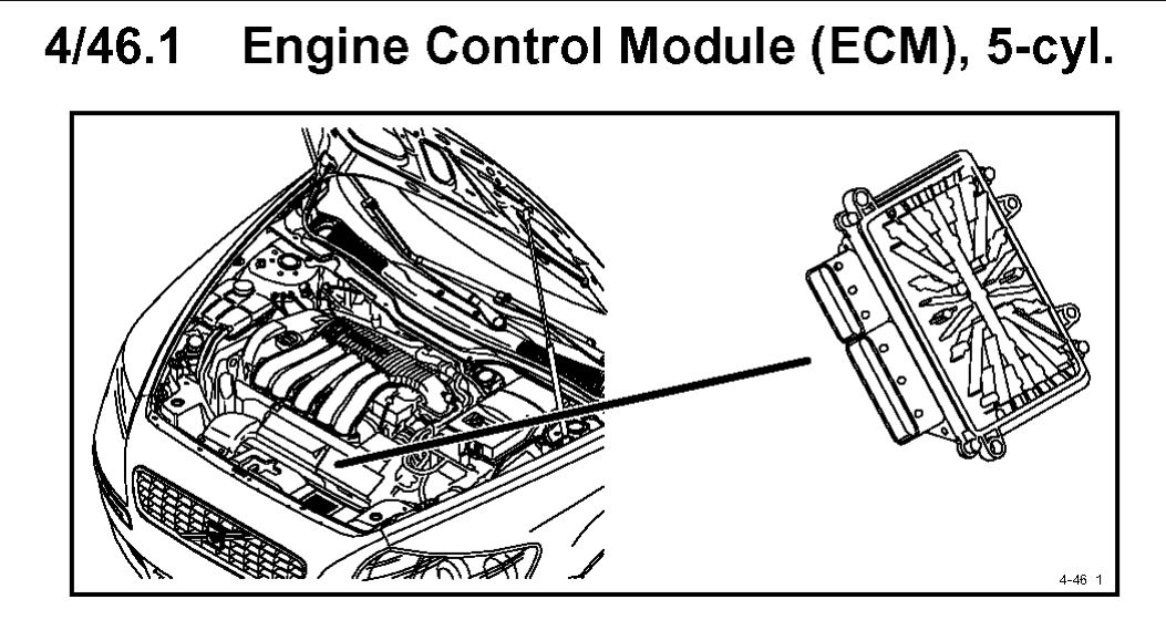

I haven't checked the pins or wiring yet. Where is the PCM? Is it on the right hand side of where the air cleaner is?
Also, I'm seen on a couple Volvo blogs, some comments that the P0190 code was due to a MAP sensor. That's on the intake manifold, so not sure how that would impact fuel pressure. I should be able to check the pins and wires in the next couple days.
Oct 24, 2019 at 11:34 AM
  • 110,194 POSTS
Welcome back:
I attached a picture of the location. As far as the MAF, like you I don't see it affecting fuel pressure.
Make sure you disconnect the battery before you disconnect the module. Before the battery is reconnected, make sure the module is connected.

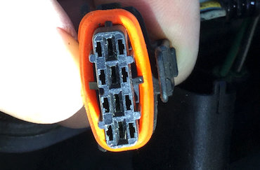

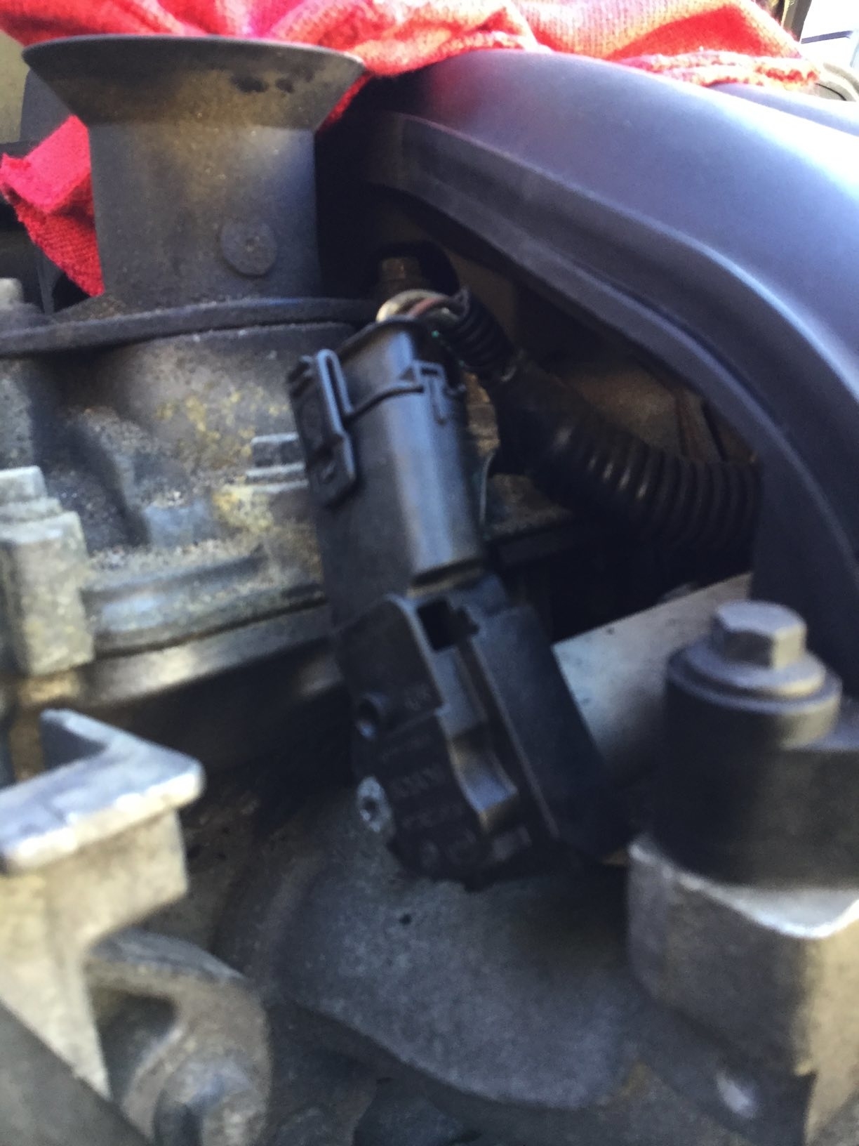

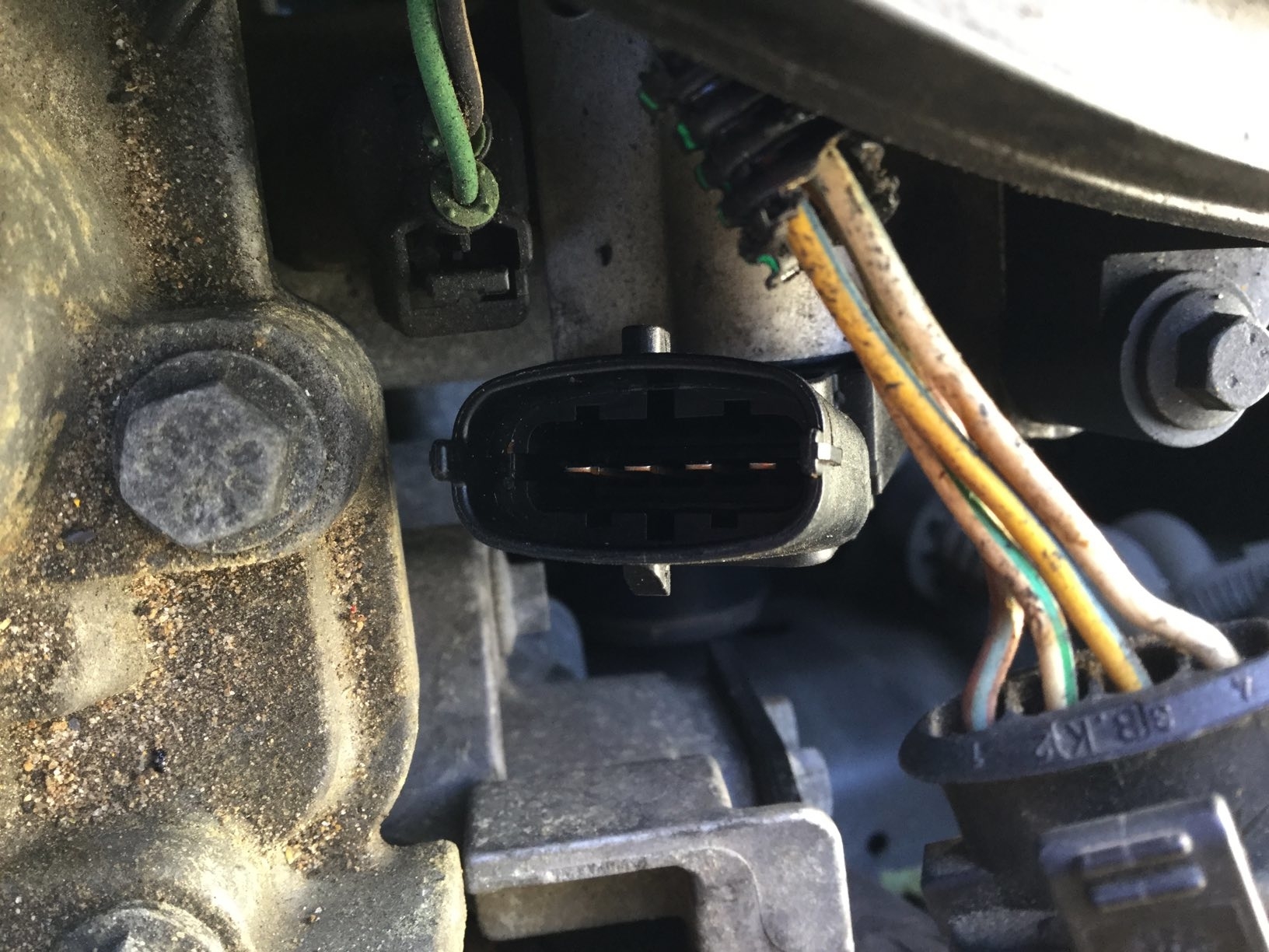

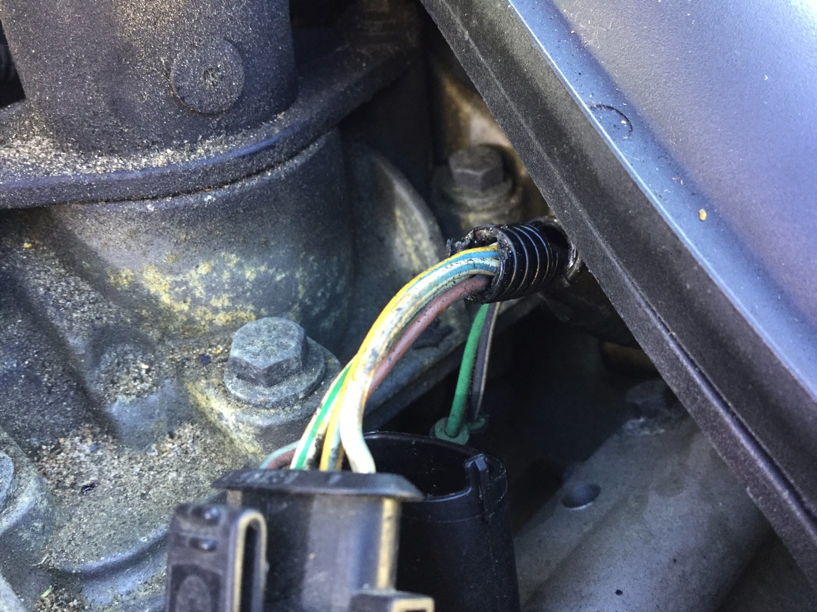

I checked the connector, pins, and wires and didn't find anything. Nothing was bent or broken. There is another sensor right below the fuel pressure sensor that seems to be working. The wiring harness goes under the intake manifold, so I'd have to remove it to fully check it. I'm going to spray some contact cleaner in the connector(I didn't have any at the time). I probably need to get a wiring diagram to check each wire from end-to-end. The OBD tester is still showing fuel pressure over 82 psi.

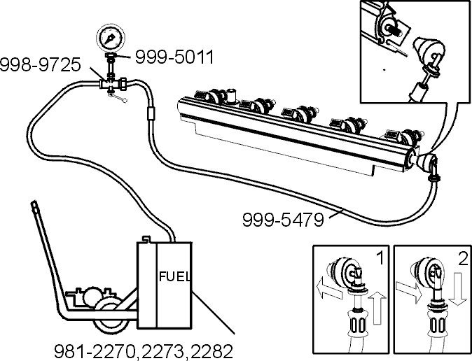

Nothing ever seems easy. LOL I checked the directions for attaching the gauge and see what you are dealing with. I attached a picture.
Let me know what you find. Take care,
Nov 3, 2019 at 5:28 PM
S40JIM
  • 7 POSTS

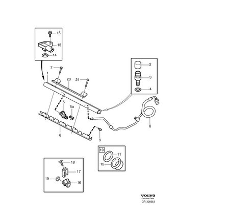

Is your diagram a generic one or one for a Volvo? Here is what the fuel rail diagram from Volvo for my car. The fuel pressure sensor is on one end of the pipe and the Bosch (I guess) male schrader valve is on the other end. That is where I'm trying to connect the pressure tester. I think getting an actual reading will tell where to go from here. I have a brass fitting that fits the threads but can't "press" the schrader valve. I may have to remove the valve and directly connect the tester (only if I can't figure-out an adapter).
