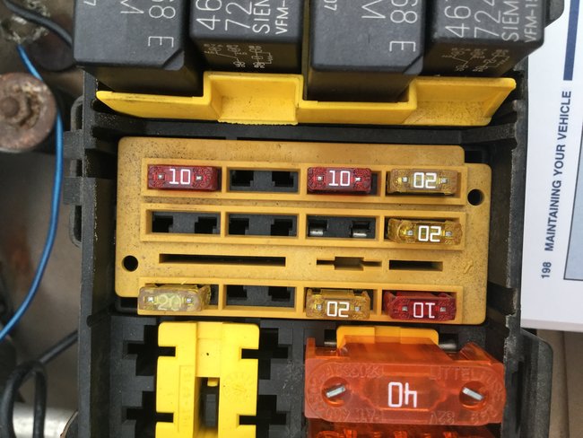

I did the test light and found the fuse that is drawing the power it seems to operate my radio and my gauges. It is in the power distribution box under the hood and it is not the factory radio so I pulled it out and the light on the tester was still on. It is a mini fuse I pulled the fuse out in the picture. it is in the middle between the 10 amp and 20 amp. Thanks

Well the way I tested it. I unhooked the negative battery post hooked up one end of the test light to the negative cable and the other end to the negative post with key off and doors shut hood light unplugged. Then I had a dimmed light on the test light then I opened the door to see if it was working properly. The light got brighter when I opened the door. So I started pulling fuses and when I got to that fuse the light went off.

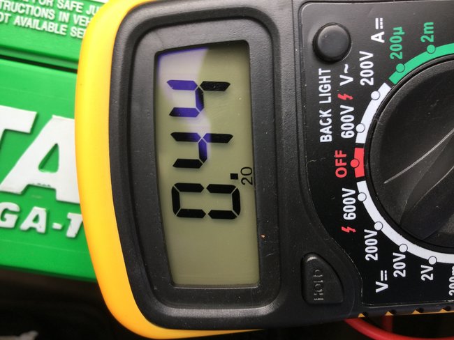

K. This is what I got changed battery new alternator did the test with the volt meter and got this. It goes up to 0.49 is that enough to drain my battery? Now if I pull the fuse I got in the first pic it goes to 0.00.
Oct 15, 2016 at 8:03 AM
TEDDY SHARKEY
  • 13 POSTS
Pulled out the radio got it down to 0.18
