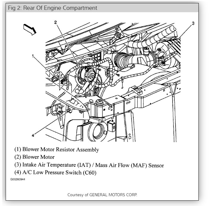

My gas gauge is lowering very quickly after I get gas. It went from 99 miles to 82 miles and I actually only drove about 2 miles.
Sep 23, 2022 at 1:47 AM
  • 55,743 POSTS

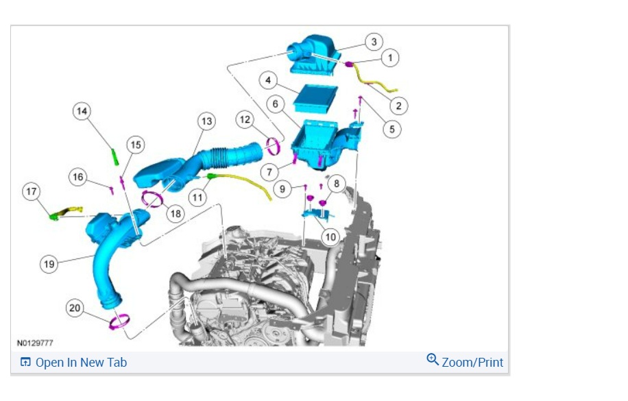

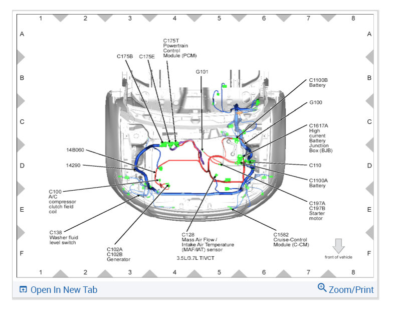

The #1 reason for this to happen is a bad MAF (mass air flow) sensor, I would purchase a new unit (Motorcraft) and install it. Also, check the air filter as well and replace it. Here is a guide to help you with the repair and instructions in the images below to help you with your particular car:
https://www.2carpros.com/articles/how-to-replace-a-mass-air-flow-sensor-maf
Don't try to clean the sensor because once it gets to this point cleaning will not help. You should also check the air in the tires.
https://www.2carpros.com/articles/how-to-use-a-tire-pressure-gauge
Check out the images (below). Let us know what happens and please upload pictures or videos of the problem.
