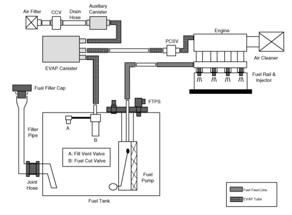

Hello, what code is the engine computer setting? And exactly what Evap components have been replaced, theres the Charcoal canister, Canister vent valve, Fuel tank pressure sensor in the rear of the vehicle and the Purge valve in the engine compartment.
Another thing, do you stop filling the gas tank when the handle at the station clicks off? Some people will pull the filling handle out alittle more to try to get more gas in the tank. This causes and overfilling of the tank, and results in the Charcoal canister getting liquid gas in it. Its only designed for vapor not liquid gasoline. When the canister gets liquid gas in it the charcoal breaks up and pieces of it get sucked into the purge valve and the rest of the system. So a new purge valve can be put on and the same result will happen. The purge valve will have small pieces stuck in it. This will cause either a purge valve code, or a large leak code. So if you know the code number your mechanic is getting, we can go from there and try to help you out.

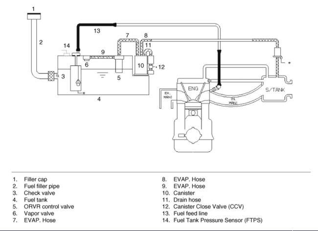

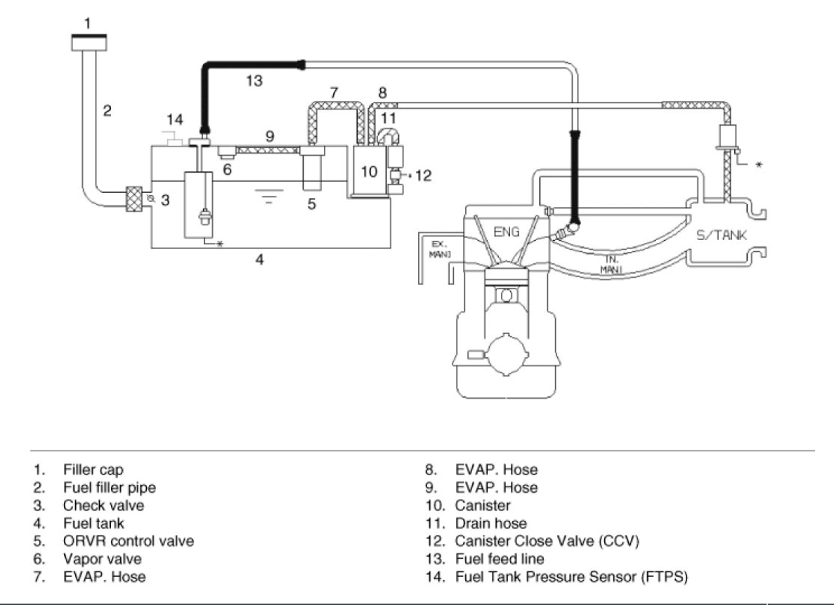

Because the tank is only made to hold so much fuel, when the handle at the gas station clicks off, that's full. When you try to add more there are valves and vapor lines that the extra fuel goes into, such as the charcoal canister, and vapor lines. There is also a rollover valve for when a vehicle is in an accident. There are a lot of components down there that can't get liquid fuel into them. The fuel tank pressure sensor cannot get gas into it either, that is for only measuring air pressure and tank vacuum. Here is a diagram with all the Evap and tank components. You can try just replacing the Charcoal canister and see if that takes care of the issue, but if pieces of the charcoal are now throughout the entire evap system. They will need to be cleaned out. They are going to be in the new purge valve as well. If you unhook it and tap out small particles of charcoal it needs to be replaced and the vapor lines cleaned out.
Feb 6, 2023 at 7:12 AM
PMAUGHN
Oh, thank you very much. This clarifies a lot. The diagrams helped me to really see.
