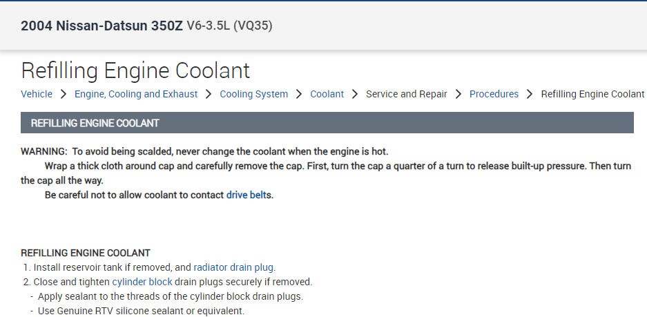

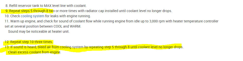

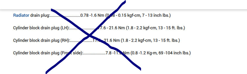

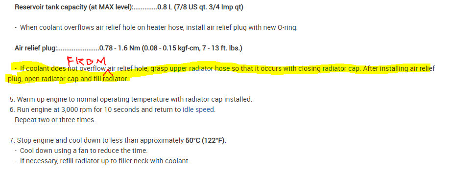

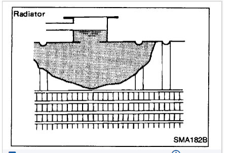

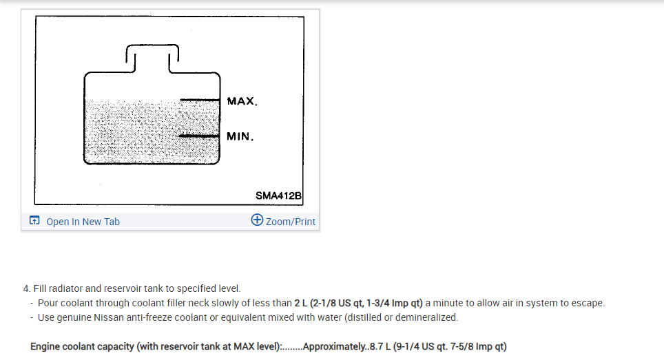

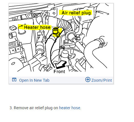

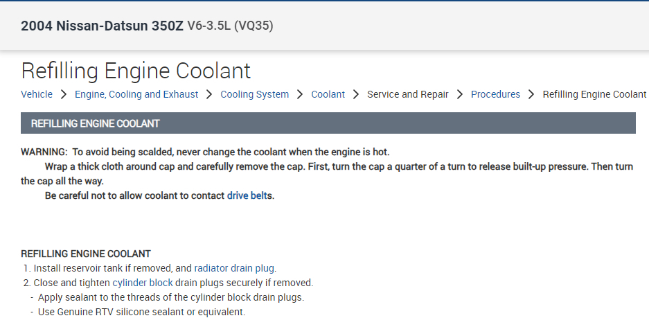

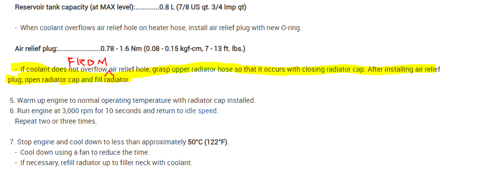

If the heater isn't working, you likely still have air in the system preventing it from circulating through the heater core and not allowing the temperature sensor to function properly. There is an air bleed valve on the heater hose. If you didn't open it when refilling the system, it has air in it.
I attached the directions below for draining and refilling. Note, I crossed out the draining procedure. Read through the directions and let me know if they help.
Take care of yourself.
