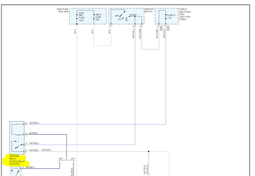

I’ve had a MAP sensor code for a week, replaced the MAP sensor and mass air flow sensor. The code still was up and I was reconnecting the battery when the car headlights came on and the car tried turning over without the key in the ignition.

Were there any electrical issues prior to disconnecting the battery? I ask because this is an odd one.
Does the vehicle have a factory remote start system or has someone installed an aftermarket one? let me know that information so I can look at the correct wiring schematic for the starter circuit. If it doesn't, then we have a traditional starter relay. If it does have a factory remote start, it is designed differently.
Also, let me know if anything other than the sensors were replaced.

The only issue was the dancing RPMs and the car stalling, which sent all the lights to flash on the dashboard and the code was for the MAP sensor. I replaced the MAP sensor and the mass air flow sensor. Unplugged those and disconnected batteries to clean the O2 sensor and when reconnecting the battery, the car was trying to turn over (never started). I just bought the vehicle 3 weeks ago and haven’t driven it for a total of 4 days since I bought it. The first time it messed up, the company I bought it from replaced the spark plugs and coil pack.

Nothing you have done should have caused this to happen. To me, it sounds like there is an issue with the electrical box.
Does it still do the same thing? Do the lights turn on and the starter engages when the battery is connected? Also, I want you to remove the starter relay and see if the starter still engages. It is located in the fuse/relay box.
There is also a headlamp relay in the same box. Check it as well.
Here is a link that explains how to check a relay:

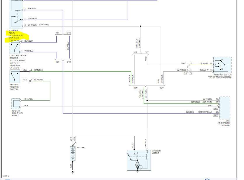

I attached the wiring schematic for the starter circuit so that you would have a reference. I had to cut it in half to make it readable, but I did overlap the two so you can follow from one to the next.
Let me know what you find.
See pics below. Also, if the dealer that sold you the vehicle provided a warranty, you may want to contact them. As mentioned, you did nothing wrong, and I suspect the problem is in the fuse box.
Nov 20, 2023 at 11:14 AM
