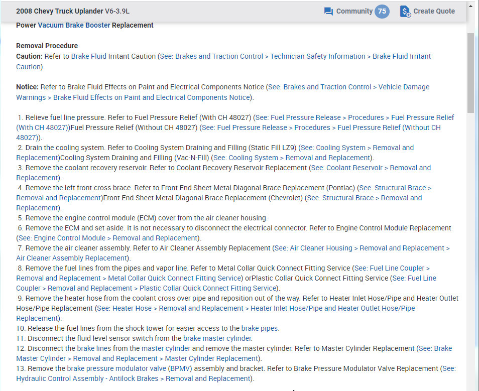

Here is a guide on how to replace front pads just to make sure you didn't miss something:
As for the booster we need to make sure none of the lines came off or if you did remove any that they went back on the same place.
The easiest way to test the booster is to start the engine and let it idle. Shut the engine off and press the brake. You should have an easy/normal pedal for about 2 full presses. Press the brake until the assist is gone and the pedal feels hard. Then hold it with moderate pressure like sitting at a stop sign, and start the engine.
If the pedal drops slightly then the diaphragms inside are working. If the pedal doesn't move then the booster is the issue and needs replaced.

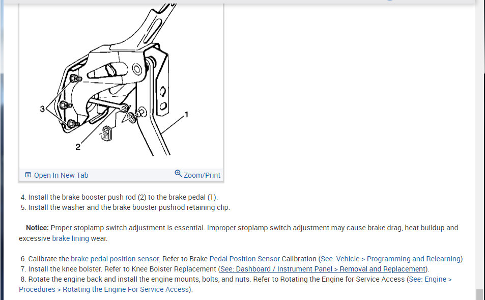

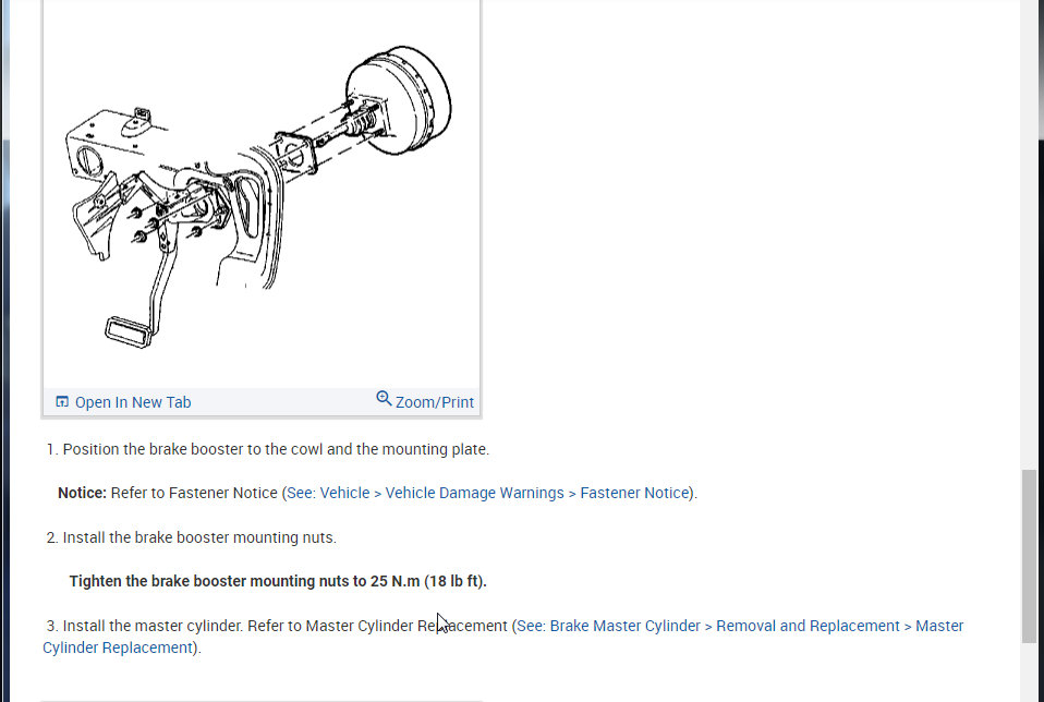

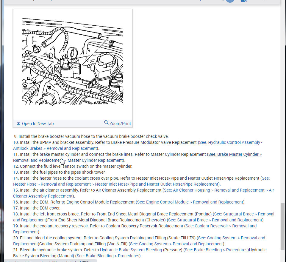

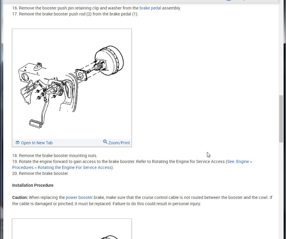

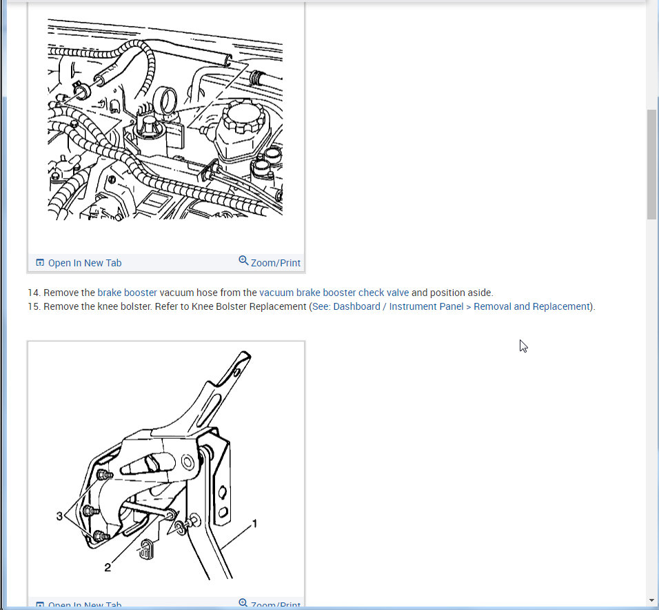

Below is a guide on how to do that.
Let us know if you have questions. Thanks
