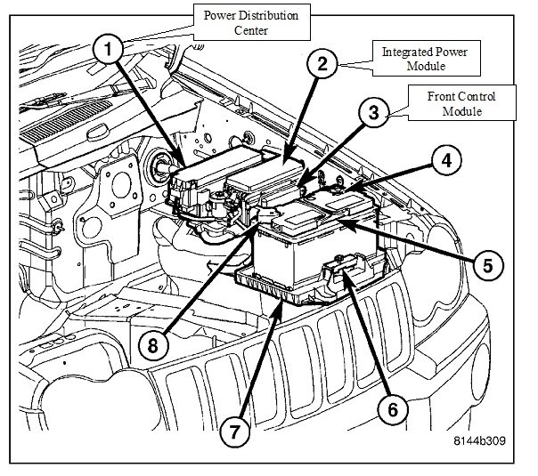

For future reference, there is always a way to stop that battery drain when the vehicle is going to be stored. In the late '80s, that was a large wire right behind the battery that had a single bullet connector. Later that became the "IOD", (ignition off-draw) fuse, usually a ten-amp fuse. Removing that would kill things like signals and radio, but it kept enough systems working to allow haulers to deliver vehicles to the dealership. Part of the New-Vehicle Prep included pounding on wheel covers, screwing on antenna, checking lug nuts, and popping the IOD fuse in.
By 2005, the IOD fuse was no longer labeled as such. Since it included the Air Bag Computer in its circuit, today the two air bag fuses get pulled out to kill the current drain. Anything bright yellow is related to the supplemental restraint, (air bag) system. Therefore, you'll find two fuses inside a bright yellow fuse holder, and plugged into the fuse box. They're also identified that way for safety responders to disable the system after a crash. In this case they're inside the Integrated Power Module under the hood.
Removing these fuses is considered normal, so no special procedures are needed when they're plugged back in. The same would result when the battery is disconnected or run dead. What I have found with my Dynasty, is when I pop a battery in it, the anti-theft system turns on with flashing lights, but not the horn. I have to have a key ready to lock and unlock a front door to disarm the system.
