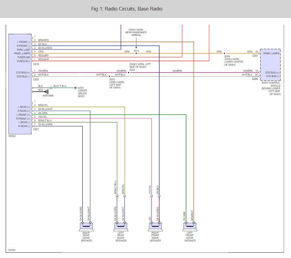

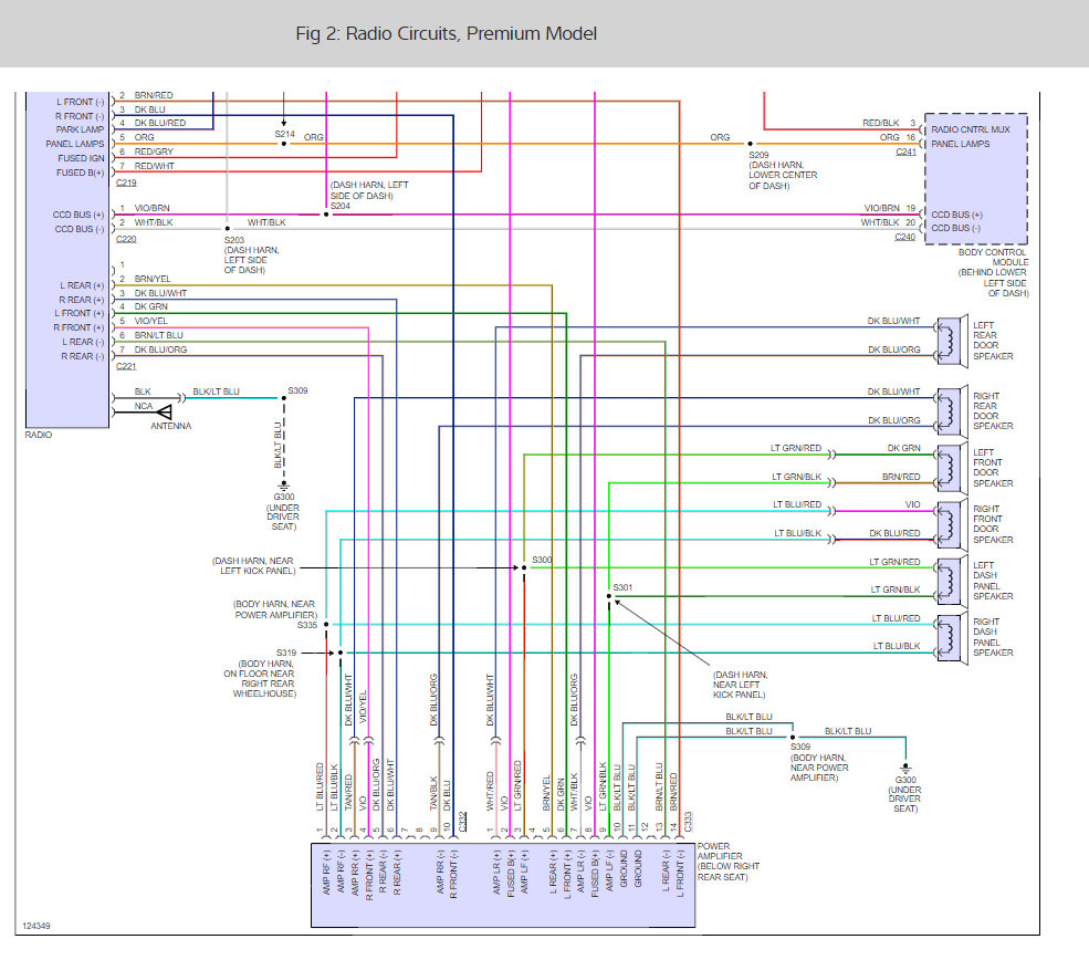

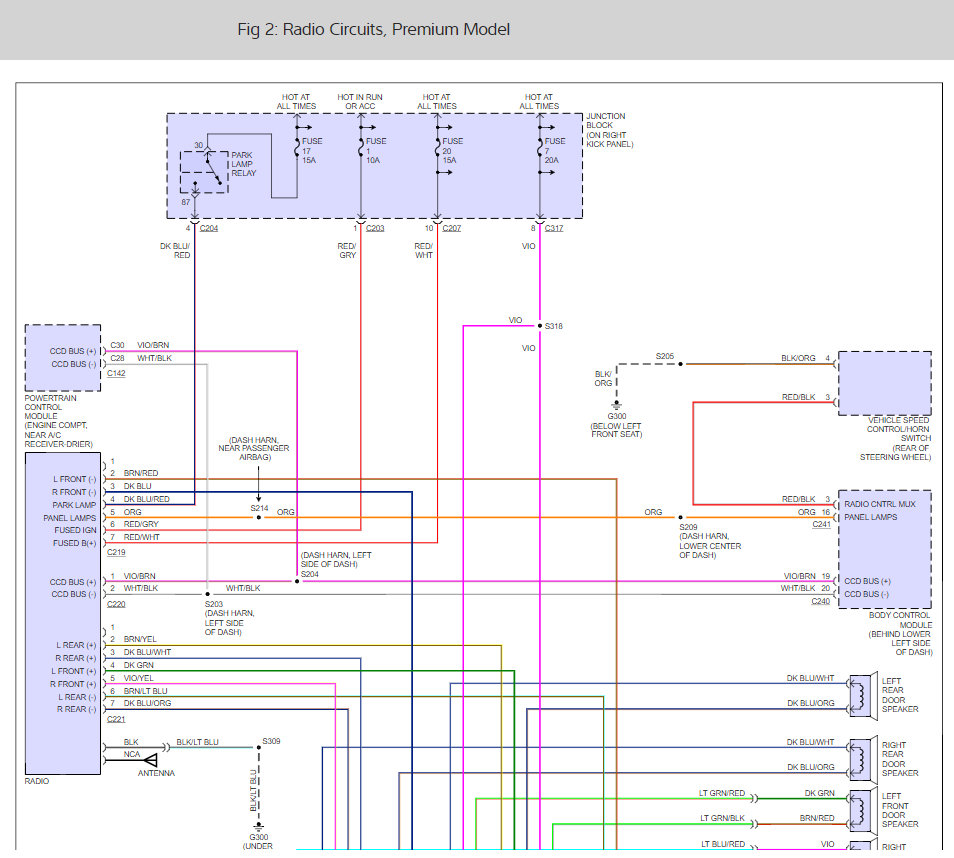

The amp needs a signal from the radio or it will not turn on causing the no sound issue or there is a fuse blown for the amp.
Here is a guide and a wiring diagrams to help us get the problem fixed.
That blue wire is the switched power turn on signal for a power antenna and/or amp. The amp in the vehicle needs a turn-on signal and it gets it on that last wire in the black plug. Those are the two that have to be connected.

Look under the passenger seat to see if your vehicle uses an amp. By 2004 radio amps, and most computers on all brands of cars no longer turn on simply by turning on the ignition switch. The original radio generates a digital "turn-on" signal that is broadcast over the data buss. The amp turns on when it sees that signal.
I suspect there is something available through places like Crutchfield or Best Buy, but it would be easier to eliminate the amplifier. There are jumper plugs available for that, or you can cut and splice the wires.
