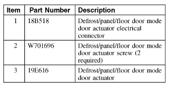

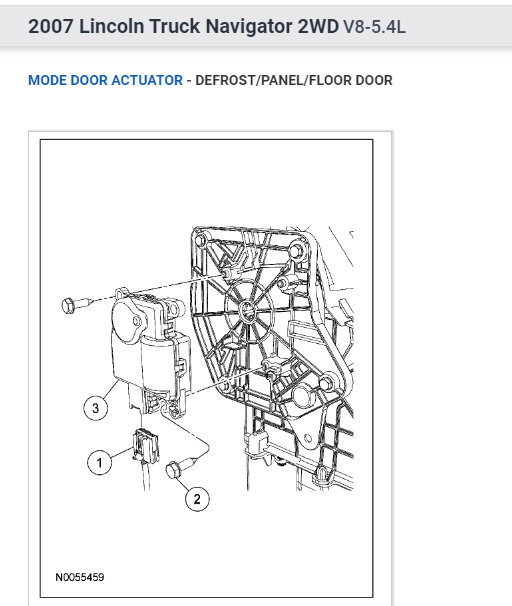

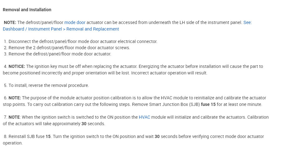

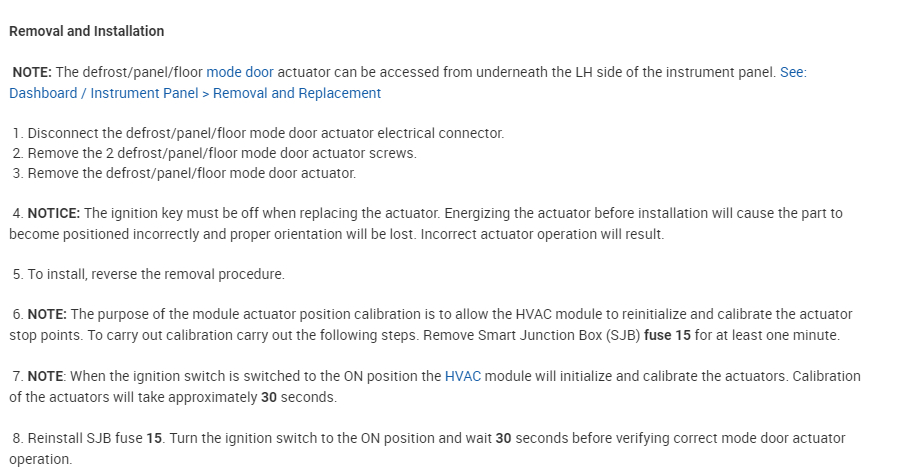

Do you still hear the blower motor running? Does the air come from a different location such as the floor or defroster?
If the air is blowing from the wrong locations, it is likely related to the mode door actuator. I will need to know if you have dual climate control and if it has automatic climate control or manual control.
If the blower fan is working and you do feel the air from a different location, I attached directions below for replacing the mode door actuator. Before replacing it, remove it and see if it responds when you change the controller between different modes.
Let me know what you find.
