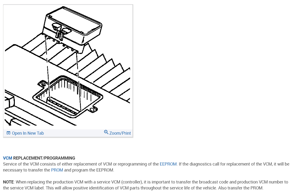

My truck runs great until after about ten miles of driving then all of a sudden it can't get out of its own way. I can shut it off and immediately start it back up then it runs like it should but only for a limited amount of time. I've replaced and upgraded the fuel injection, new GM pump, fuel filter, coolant temperature sensor, mass air flow sensor, new plugs and wires, cleaned the throttle body and replaced the gaskets on both the throttle body and upper intake. I'm completely lost, please help.

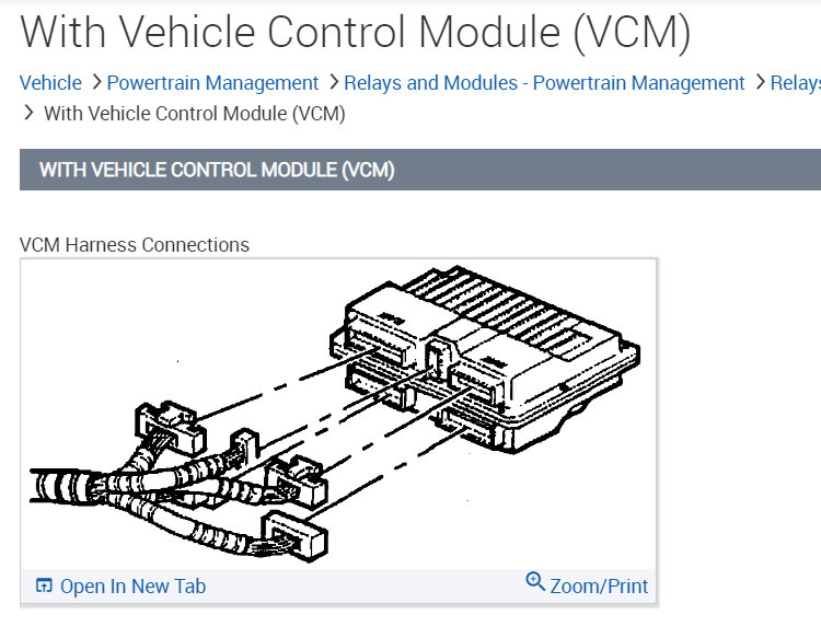

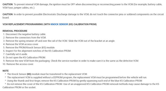

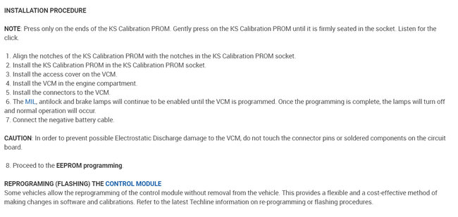

You could have a PCM going out which will cause this problem and is common with that many miles, and when this part goes out it will not have a trouble code FYI.

The only code I'm getting now is a misfire on #6 but that only pops up after the truck starts running funny. Thanks for the link but I already have a scanner. When I look at live data, the MAF reading is always in the red along with the TPS when I accelerate. How do I confirm that it is or isn't the PCM?
Aug 5, 2022 at 11:18 PM
  • 54,840 POSTS
The only way yot see if the PCM is bad is to send it out and have it tested.
