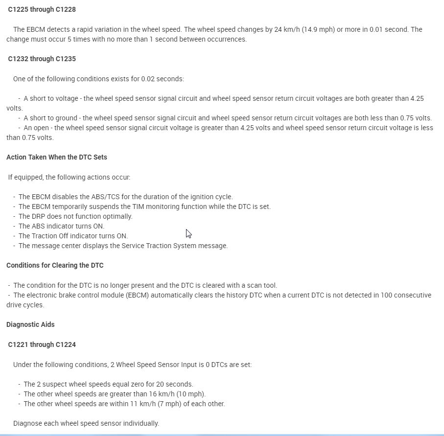

Multiple Speed sensor one, codes C1233, C1226, C1225, C1224, C1222
2001 CHEVROLET IMPALA
251,018 MILES • 3.8L • V6 • 2WD • AUTOMATIC
KAYLANJ

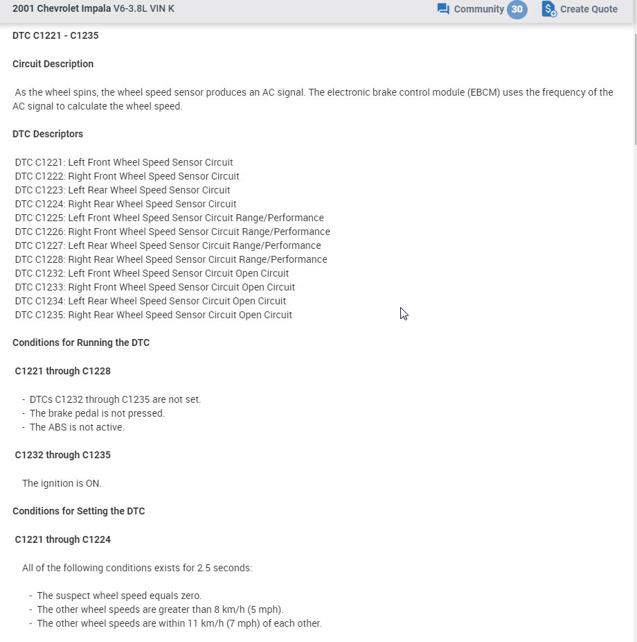

I'm not sure if it is all due to one issue or if each sensor should be tested on its own and if so how to test them manually?
Aug 10, 2019 at 7:58 AM

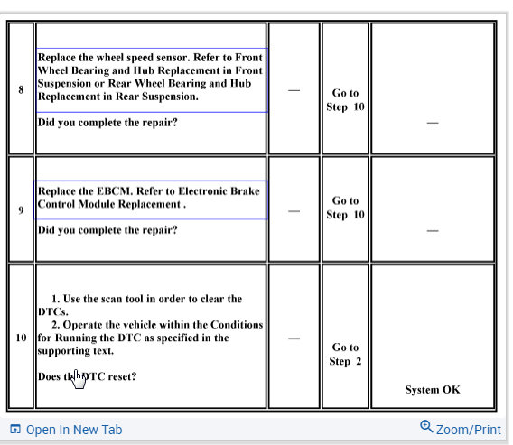

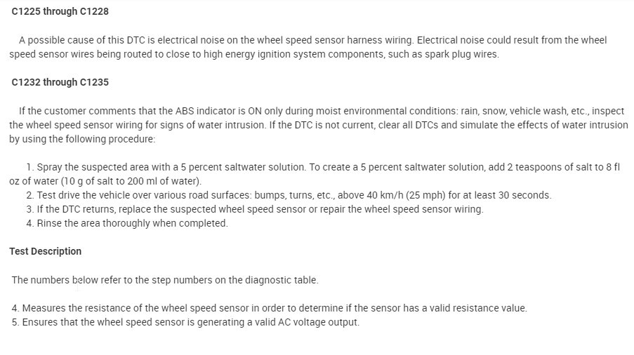

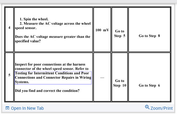

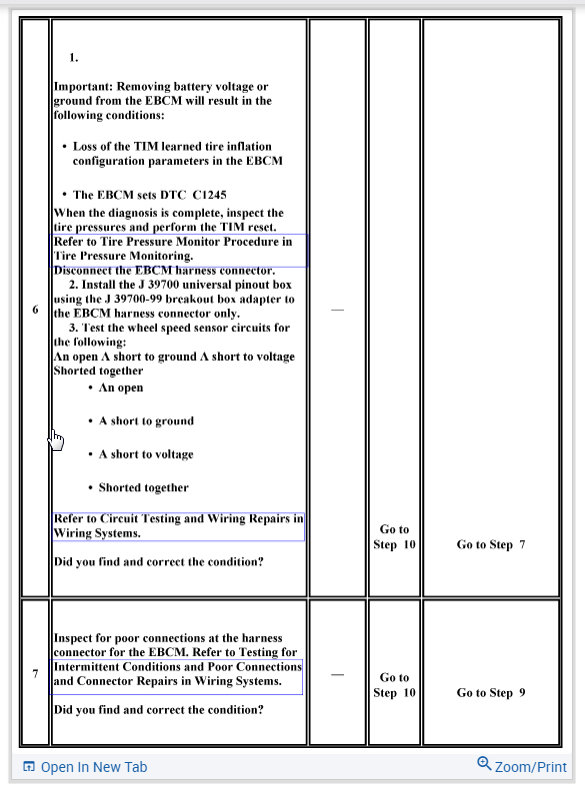

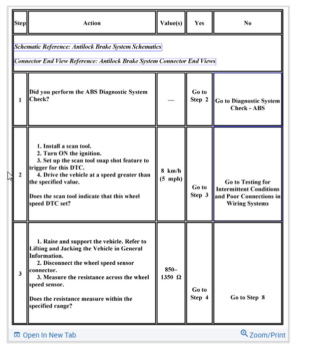

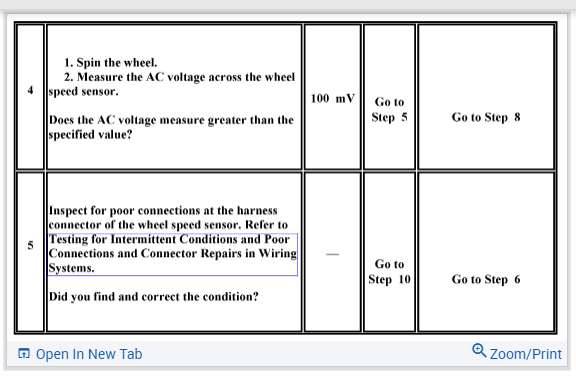

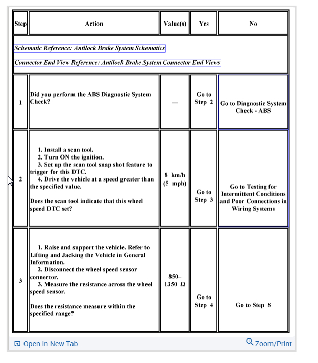

These could be failed sensors but if you work through each one of these codes it could be a a wiring issue. so the easiest thing to do is test each sensor and make sure it is reading properly. Here is a guide to help with that:
https://www.2carpros.com/articles/abs-wheel-speed-sensor-test
Keep in mind that you have two codes against your right front wheel speed sensor, one against the left front and one against the right rear. Nothing against the left rear so the most likely issue is 3 speed sensor issues. However, it is highly unlikely that they all fail at the same time, so a little back ground on the issue would help. Did you just buy this vehicle or did this happen all of a sudden? Just let me know the progression of this and we can go from there. Thanks
