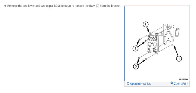

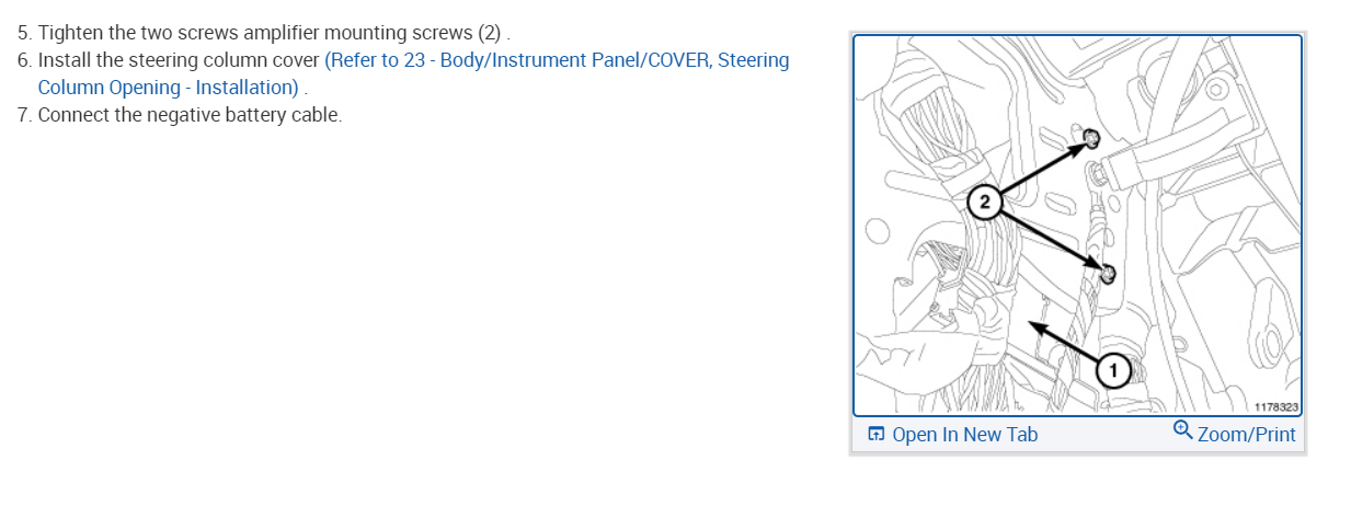

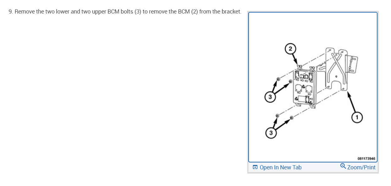

It sounds like you have a BCM that is going out but to be sure we need to do a CAN scan you can get a CAN scanner (Controller Area Network) from Amazon for about $36.00.
https://youtu.be/u-4syLc-ifQ
and
Amazon CAN scanner link for about $35.00:
https://amzn.to/3R9lJ60

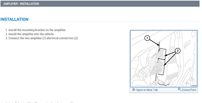

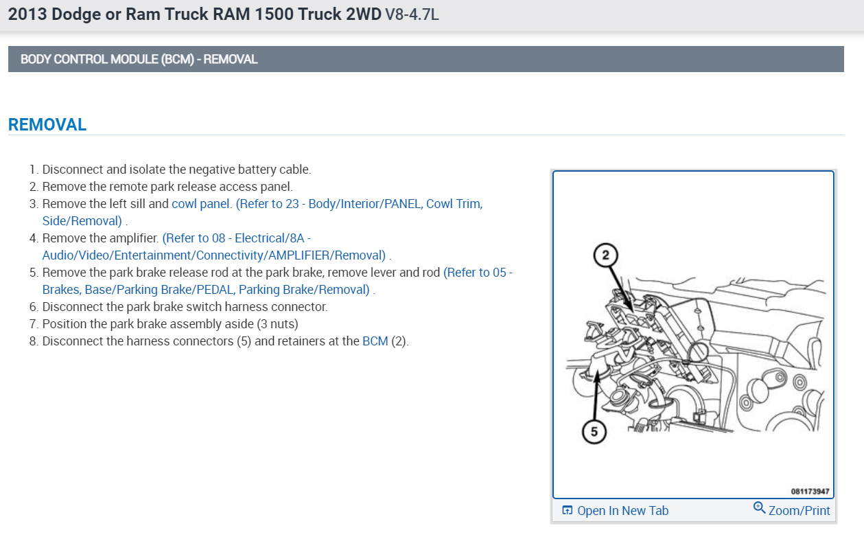

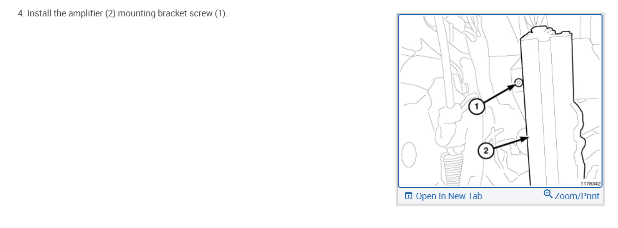

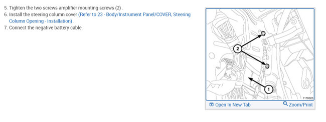

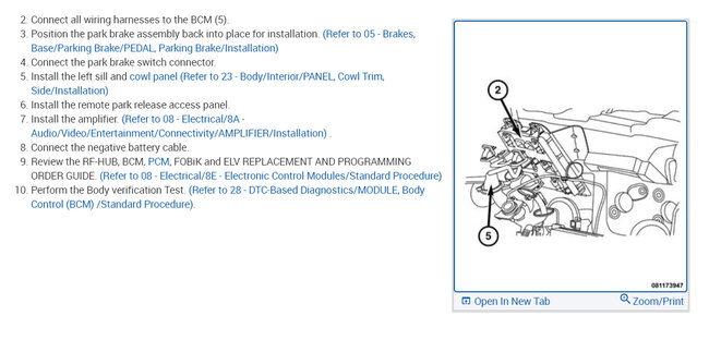

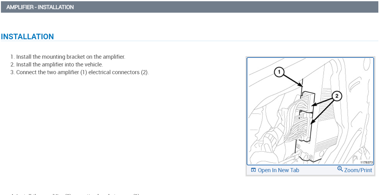

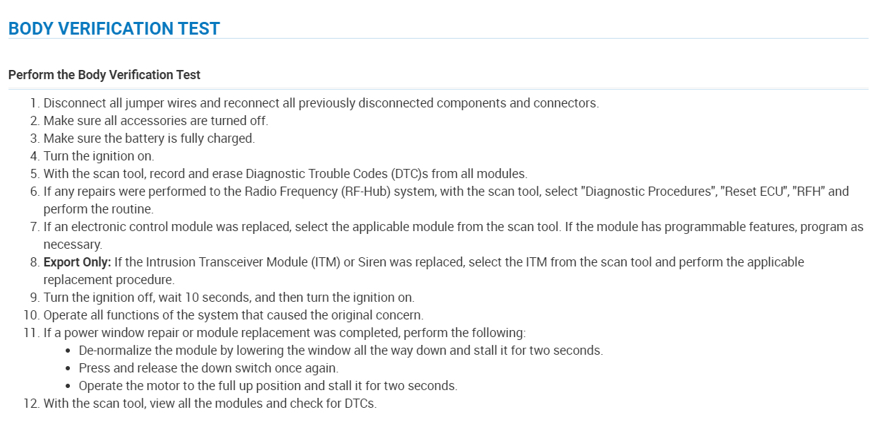

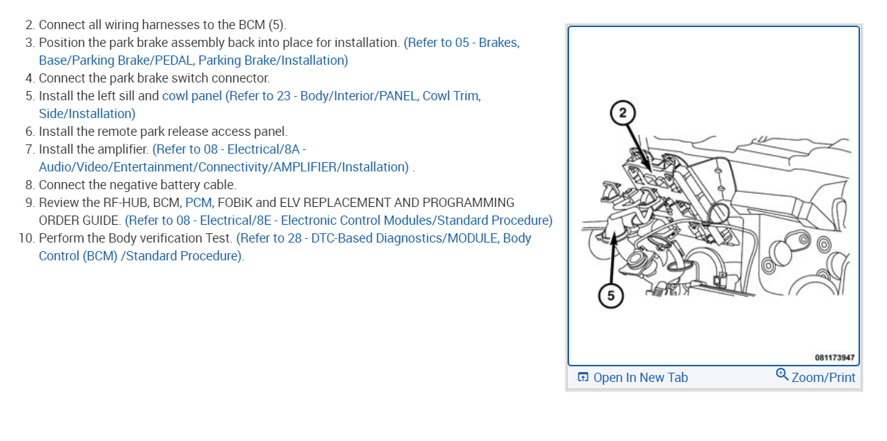

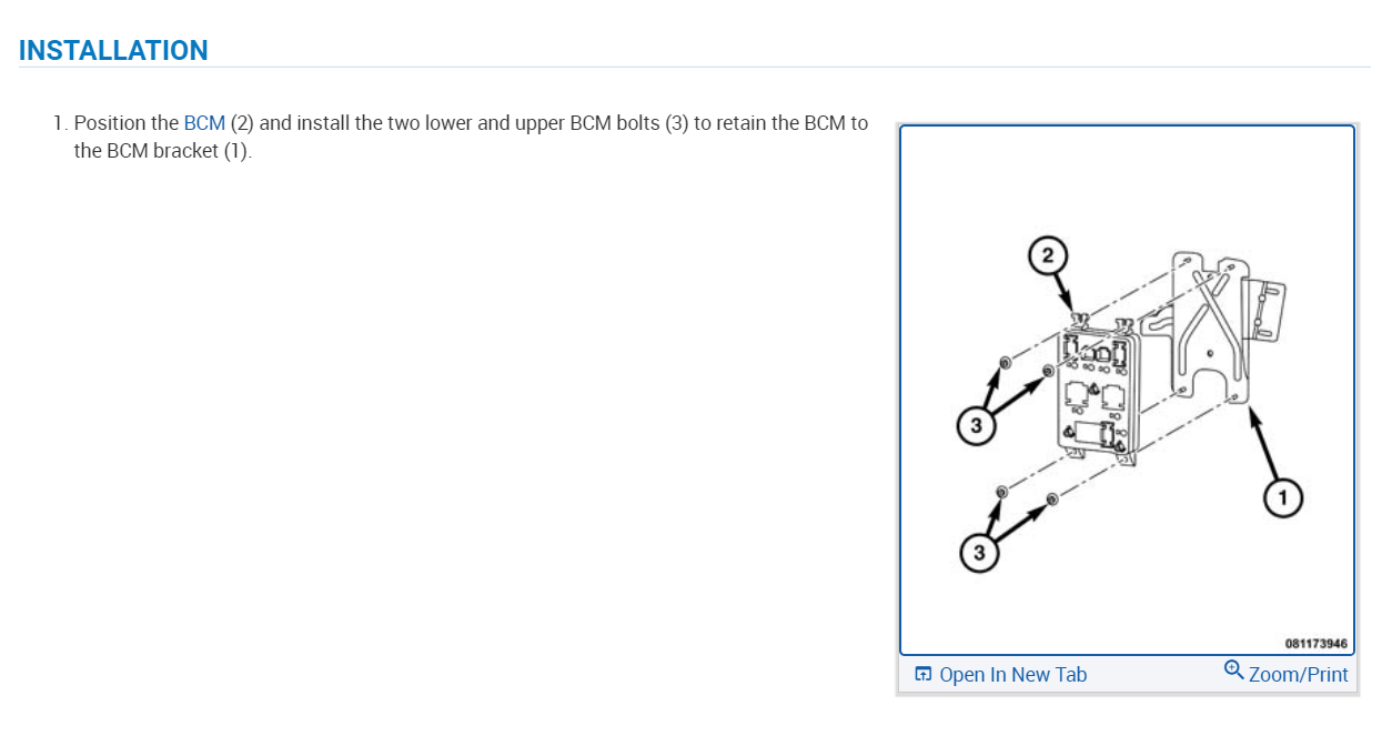

Here are the instructions on how to change the BCM out in the images below in case you need them or want to see how the job is done.
Check out the images (below). Please let us know what you find. We are interested to see what it is.
