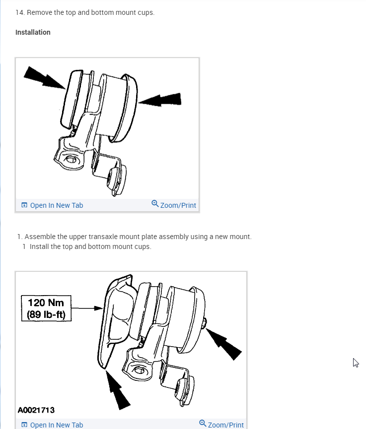

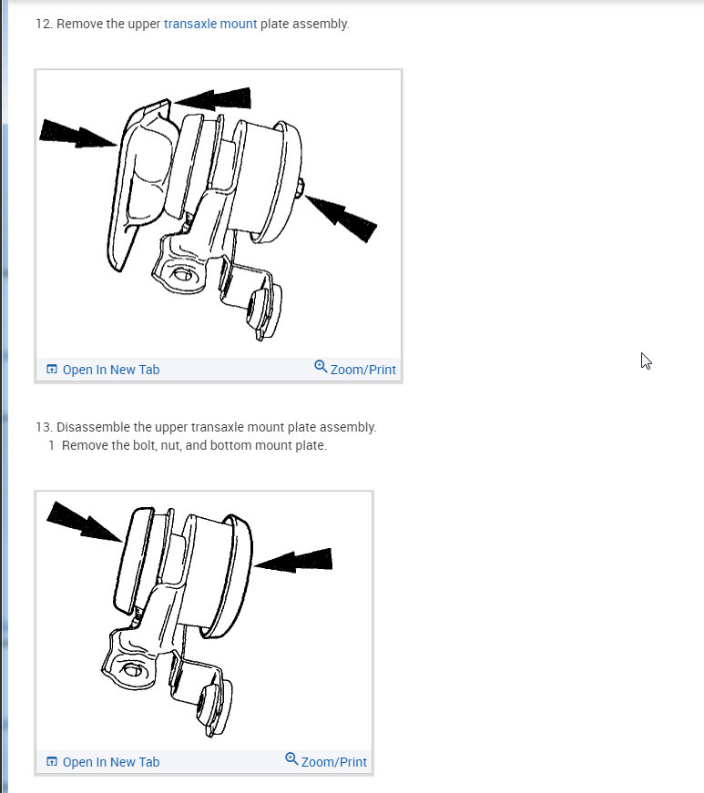

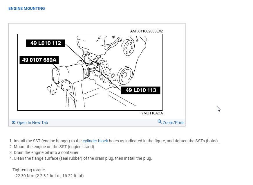

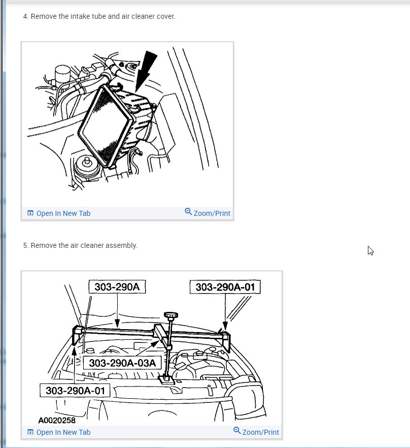

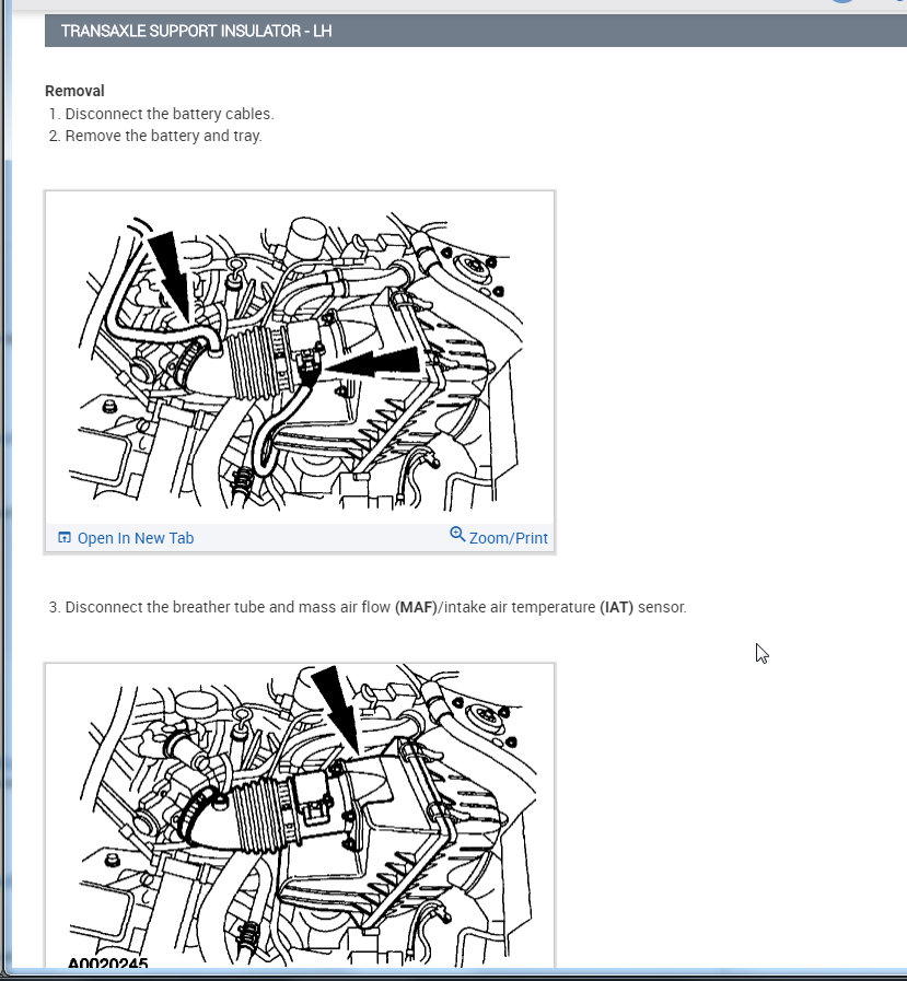

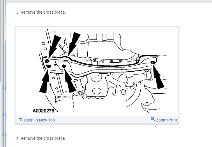

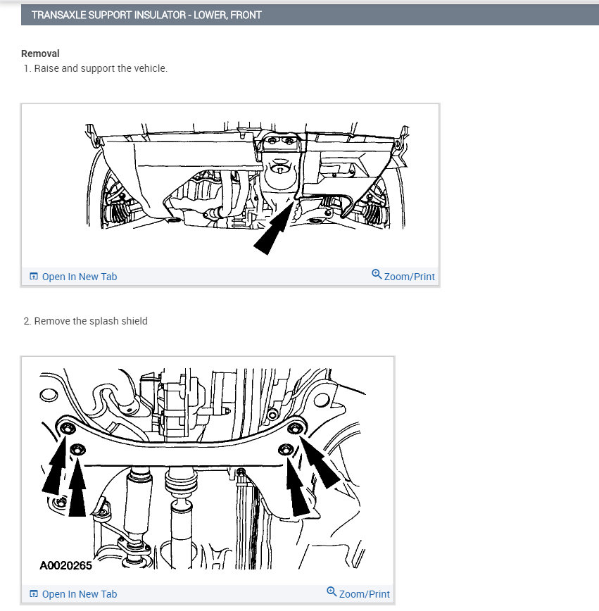

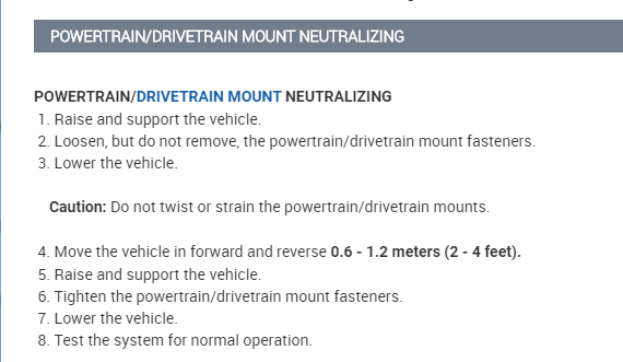

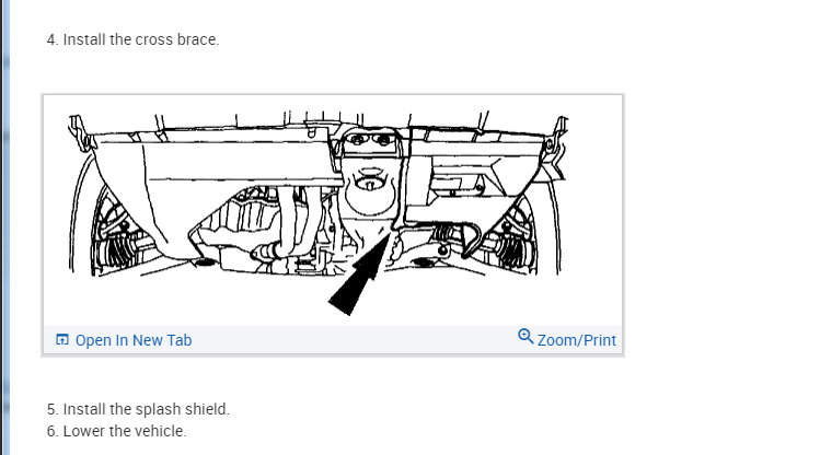

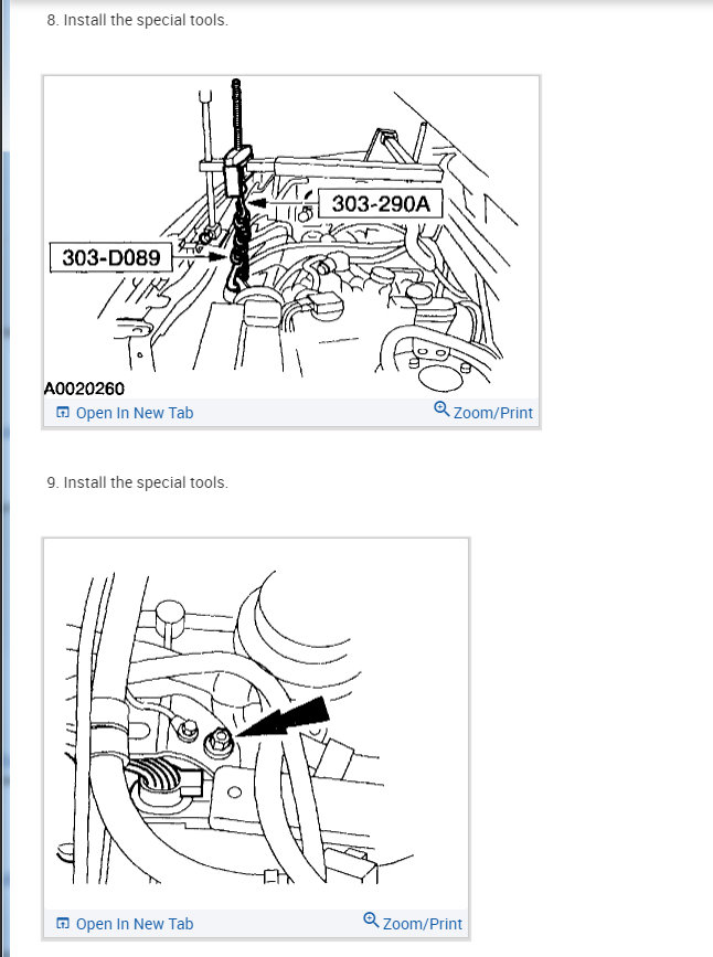

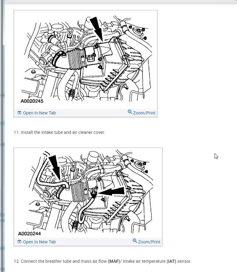

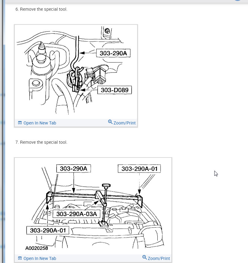

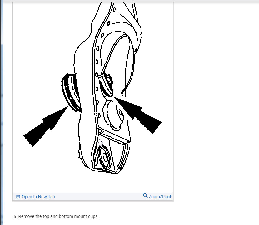

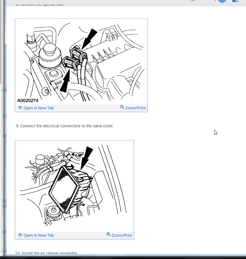

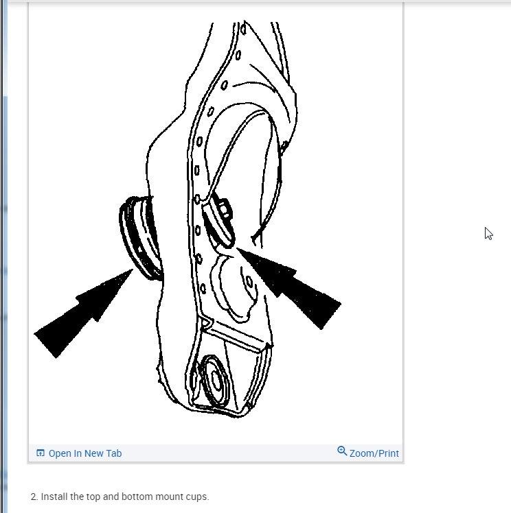

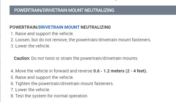

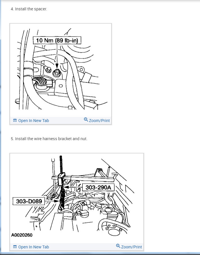

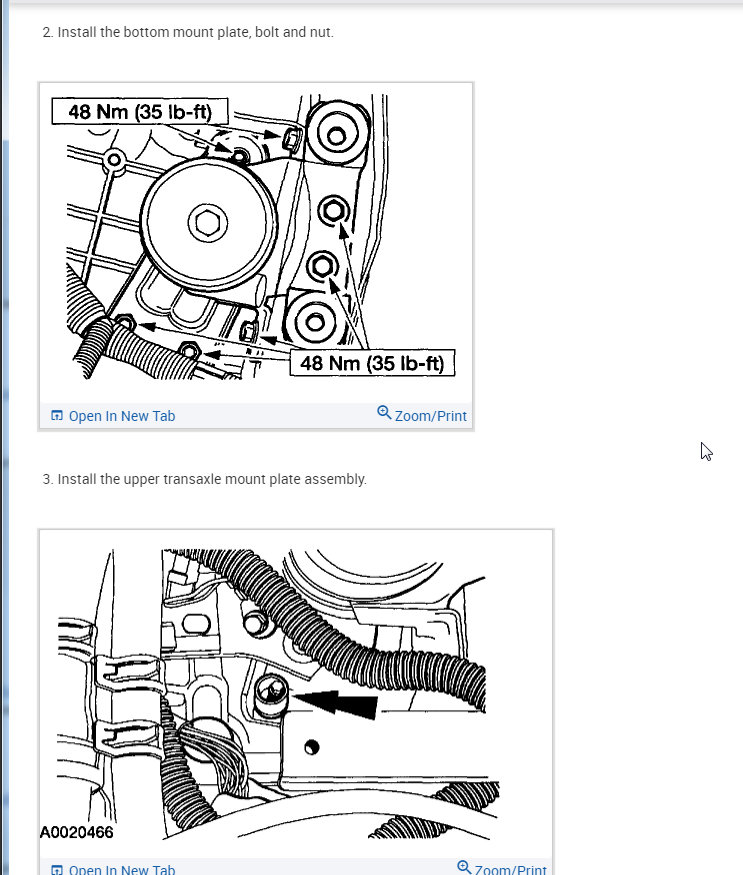

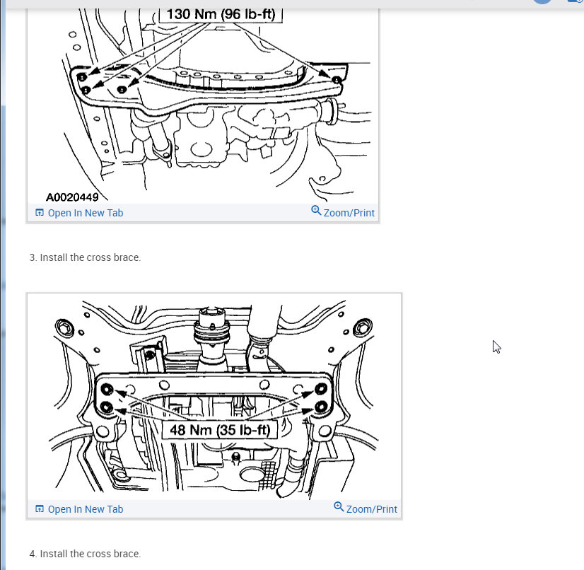

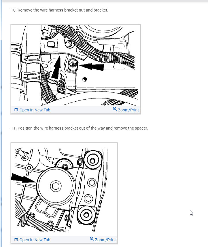

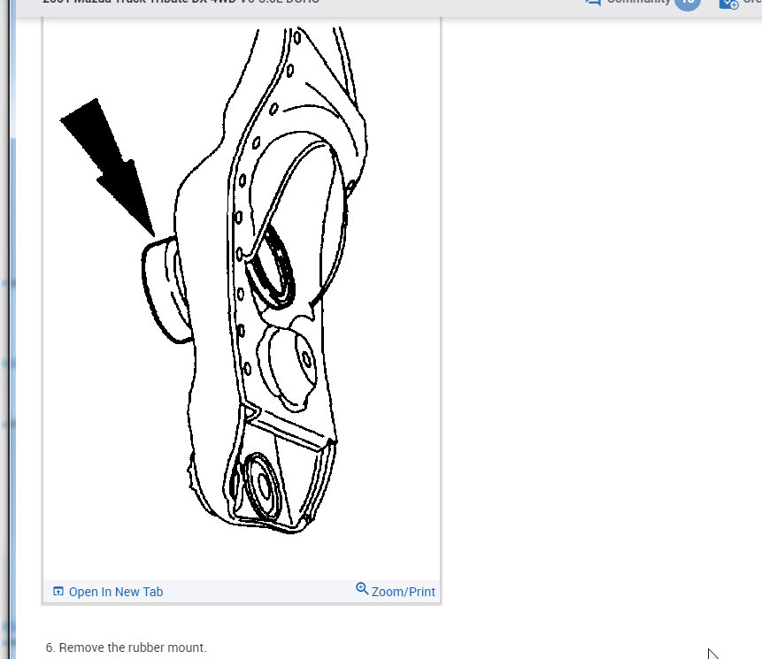

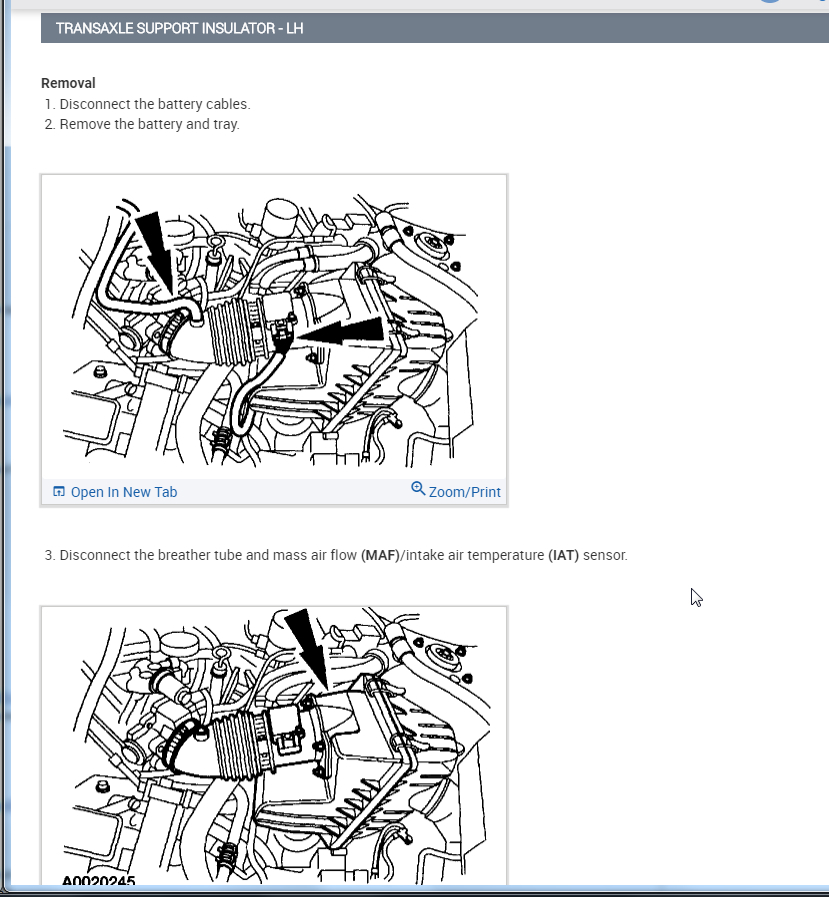

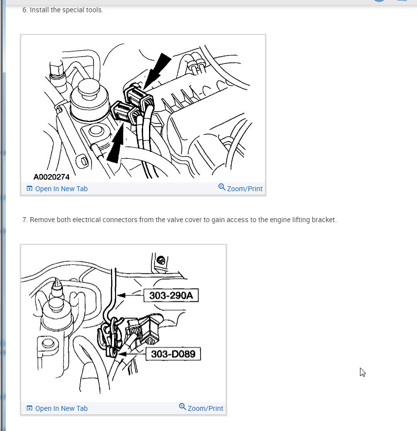

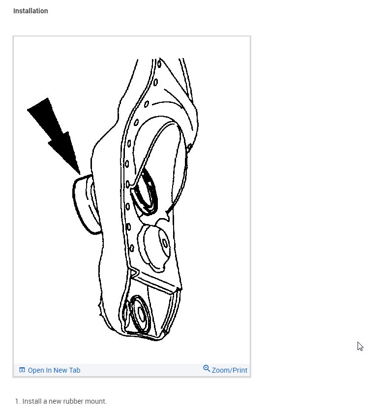

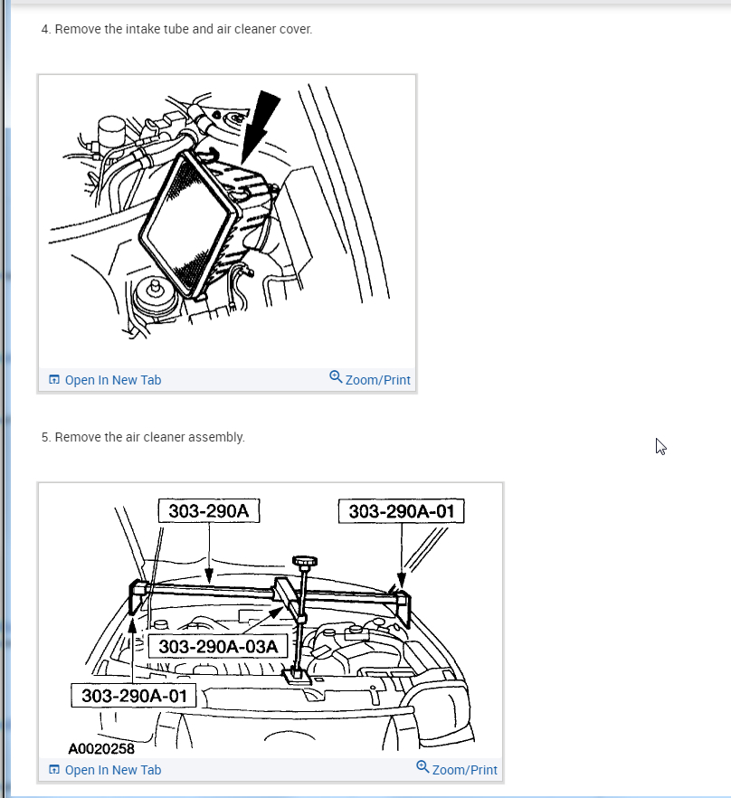

Replacing engine and transmission mounts.
Oct 12, 2020 at 6:32 AM
I am attaching the requested information. Let us know if you need more info. Check out the diagrams (Below). Please let us know what happens. Thanks
