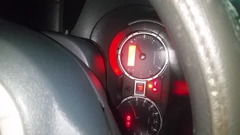

Once I came to start my car, the starter spun first time but couldn't start the car, the I return back the key and try again, at this second time I heard the starter. sounds like it is stuck and couldn't spin. When I turn the key, I just hear (tic tic tic tic).

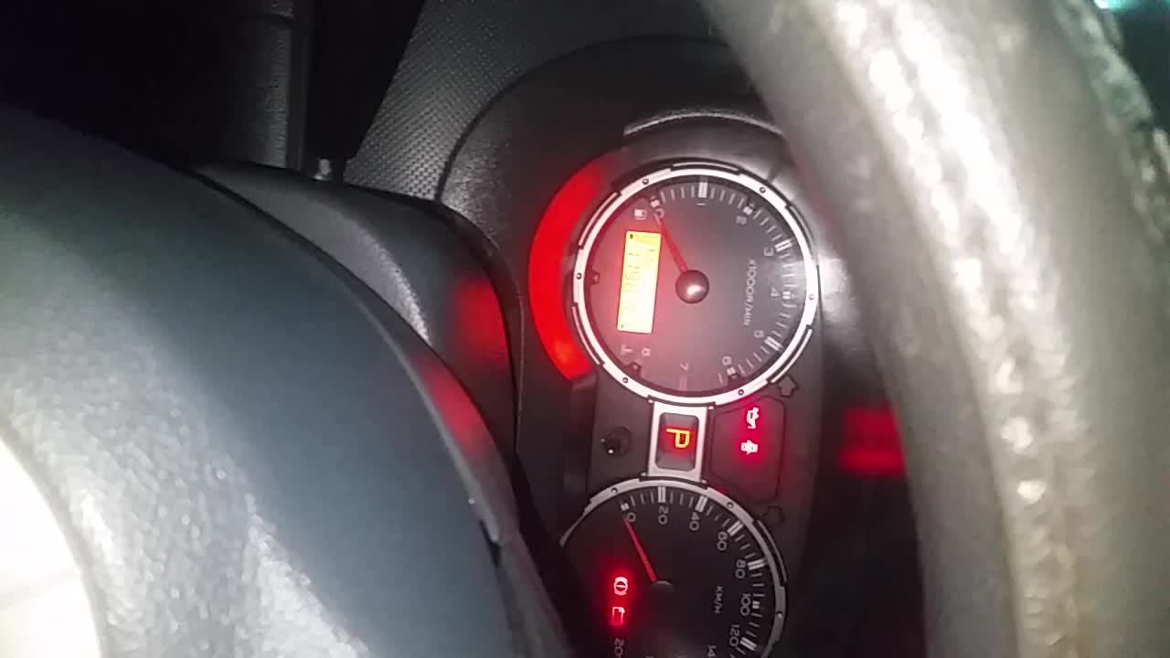

Here is the video, as you see the light strong and the gear in Parking mode.

It sounds loud, but I don't know if that is how it always sounds. I also noticed that the RPM's are going up about 200 which is normal. So, the starter is turning the engine. Does the sound I hear in the video is what you are referring to as a ticking? Also, was there anything other that happened?
I need you to do me a favor. Have a helper crank the starter and I need you to record it from the front of the vehicle. I.m wondering if you broke a timing belt and I'm hearing internal interference.
I hate to ask for another video, but I need a clearer audio. Also, let me know if that is the ticking sound you are referring to. If it isn't, does the starter sound totally different?
Here is my biggest concern. If the timing belt has broken, then we are hearing noise between pistons and valves hitting. The 1.3L engine is an interference engine which means there isn't enough clearance between the two components if timing is off. When that happens, most times it is cheaper to find a good used engine.
If you can, and I don't have the technical info on this vehicle, remove the timing belt cover and see if it is broken, loose, or evidence of it jumping time.

The sound ticking is tic tic the background noise is a parking noise it is not related to car any more. Only that sound tic tic tic tic.
I will try jump start and see if it will help or not despite of the lights is strong.
