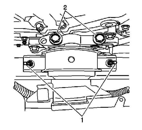

how many motor mounts on the vehicle listed above?

On the engine itself, I believe there is a front engine mount and a torque mount only. (see pic below) If I recall, the transmission has both a front and rear. The front transmission mount is responsible for supporting the rear of the engine.
There is also a torque axis mount. That is normally located at the top of the engine and prevents the engine from too much front to rear movement.
joe
See pic below.
