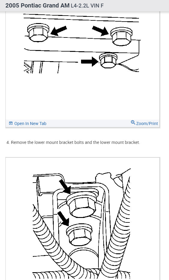

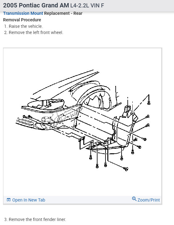

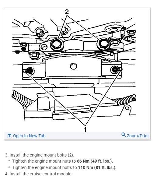

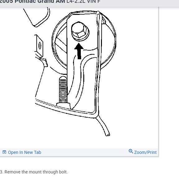

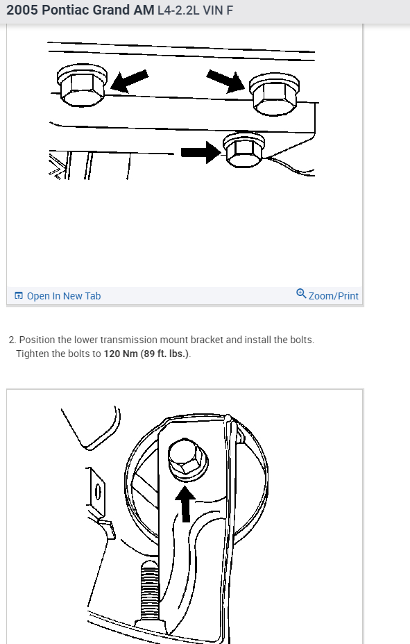

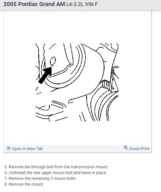

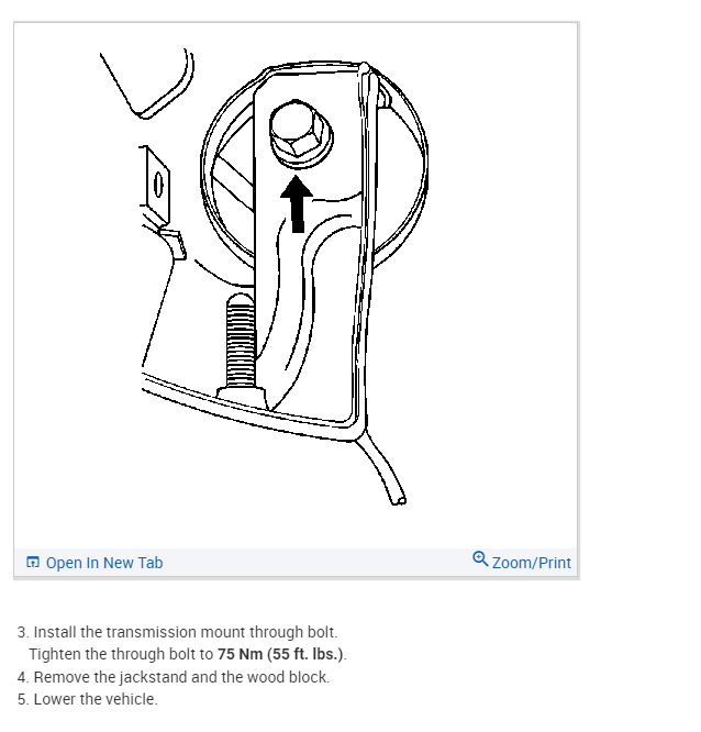

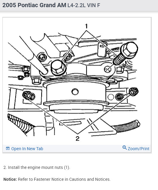

I was recently told three of my motor mounts needed to be replaced. So I have 3 questions:
+ How many motor mounts are in a 2004 Pontiac Grand Am SE 4 Cyl 2.2L(automatic transmission)?
+ How many transmission mounts are in the same vehicle?
+ If there are multiple motor mounts, and they all needed to be replaced, would I buy the same part 4 times, or rather four different parts?
Thanks in advance for any help. :-)
May 22, 2013 at 11:54 AM
SQM
  • 6,383 POSTS

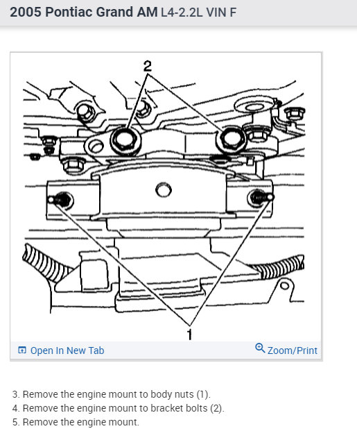

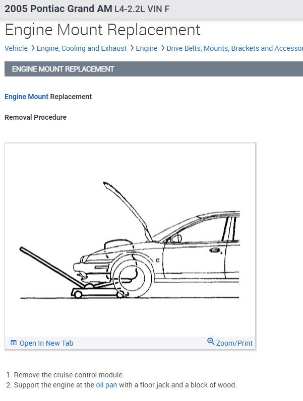

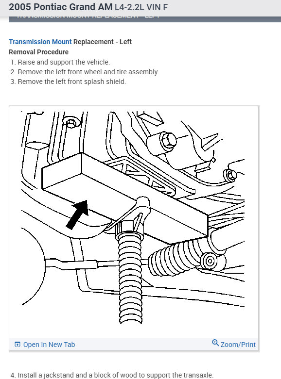

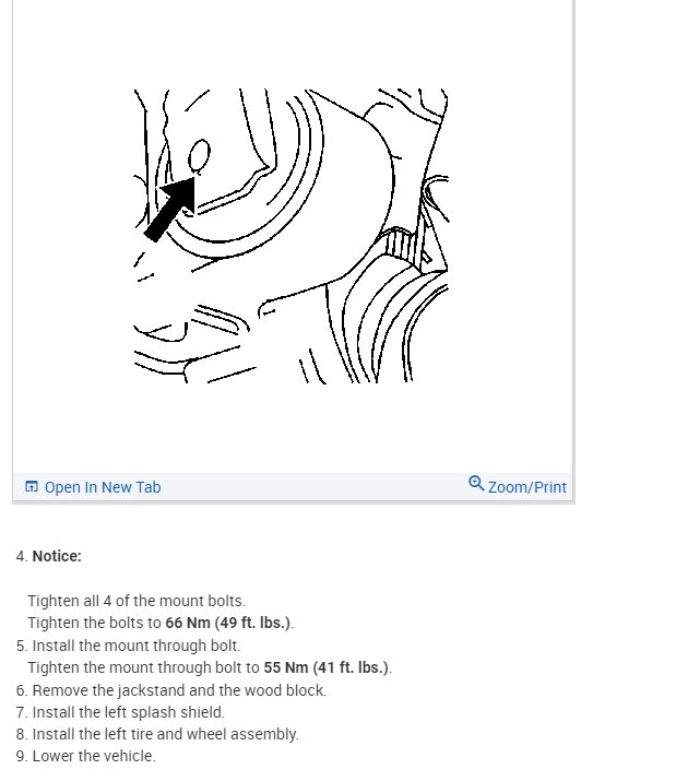

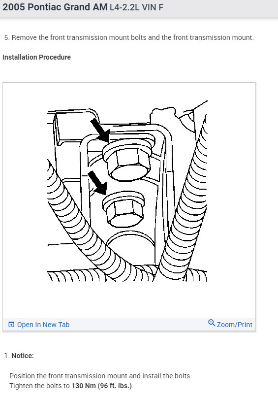

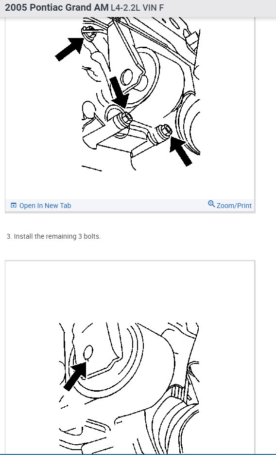

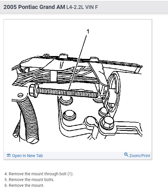

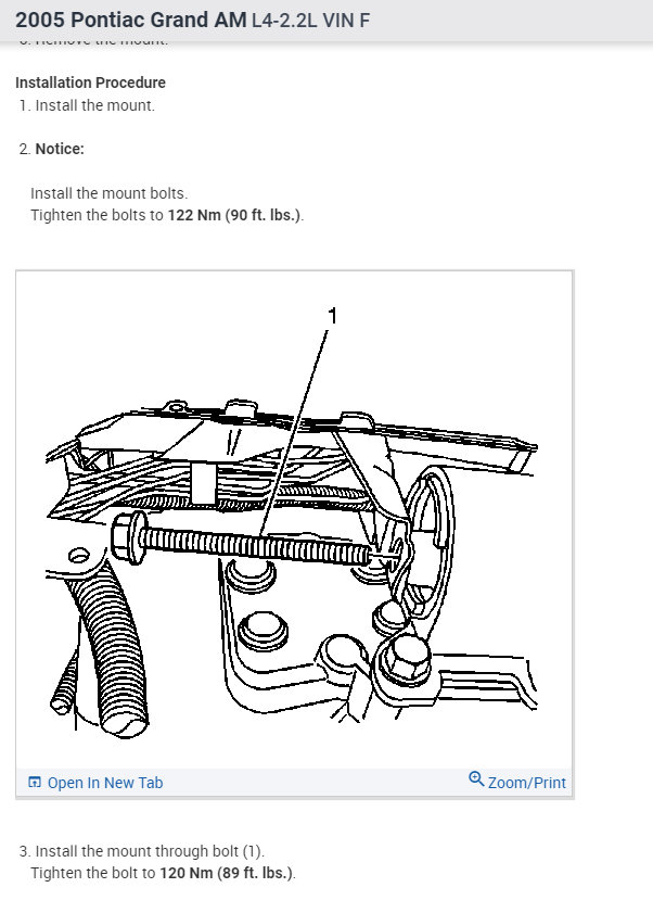

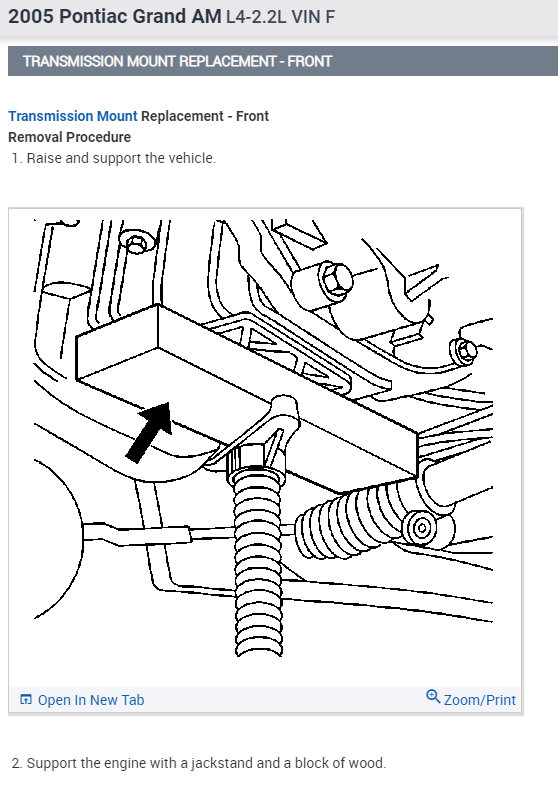

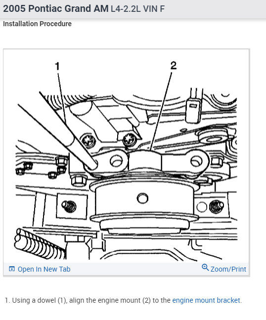

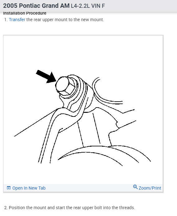

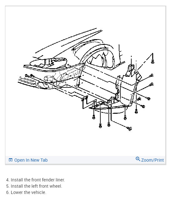

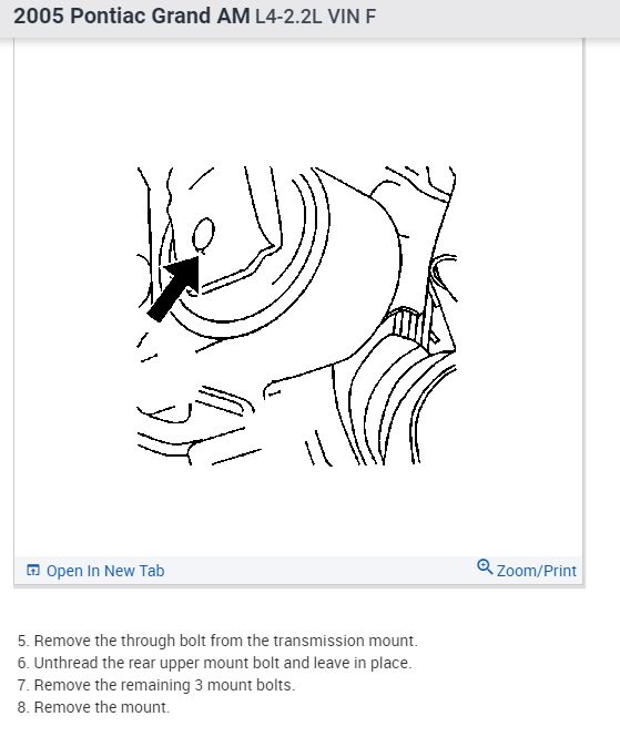

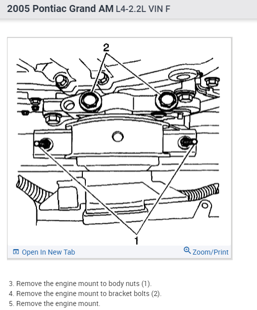

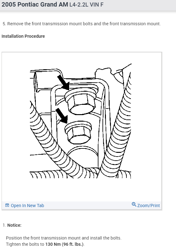

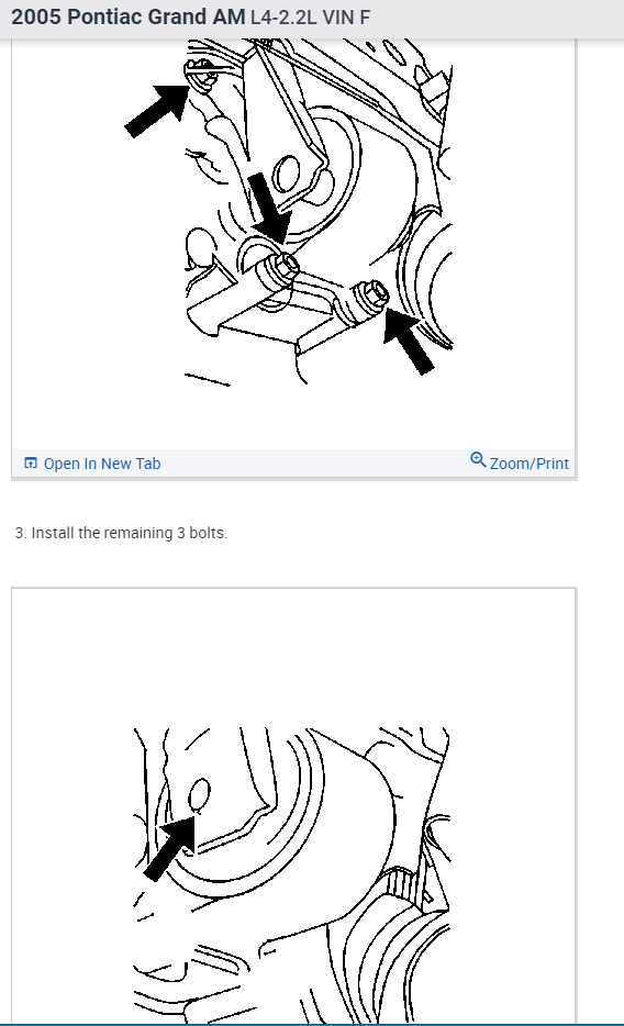

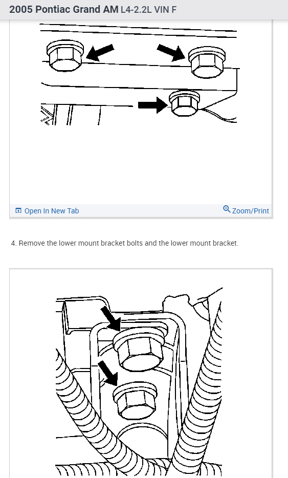

On this vehicle there are 4 total mounts for engine and transmission.
They are all different.
Many of these are available as a kit online. Prices anywhere from $80- $140 for all 4.
Here is a helpful guide:
https://www.2carpros.com/articles/replace-motor-mounts
I have attached the replacement procedures for all 4 mounts below.
