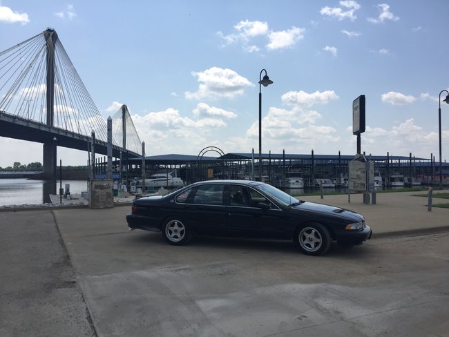

More HP please
200,000 MILES • 5.7L • V8 • 2WD • AUTOMATIC
GRNEYEDSS
From what i gather the vehicle is O1.What has to be modified for OBD2?

GRNEYEDSS
Thanks bud. Never really had anything super fast. Don’t really know much about engines. Had a stock 1990 Foxbody 5.0 but I think the chick that came with it was a lot faster. Lol. This SS kinda fell in my lap and it’s got some power but started it up one morning and it went one block and never started again. From your response it sounds like maybe it lost the tune it had or could be a dozen other things. Just got laid off after almost 16 years at a job and have some free time. Thought I’d tear into this car and get it back on the road. Probably was a mistake I’ve learned a little bit about engines but have a long way to go. From your email something rang true. High mileage! A car this quick needs to be sound and safe for the road and not just fast. Thanks for the knowledge. Take care
