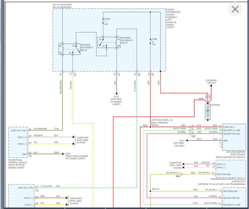

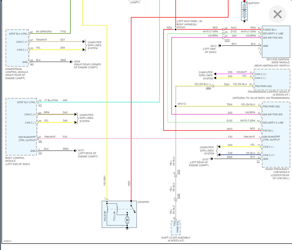

This first diagram is of all the nonsense it takes to crank the engine. The second one is of the lower left expanded for easier viewing. The Radio Frequency Hub is at the top. The ignition switch is at the lower left corner. It has a ground, a 12-volt feed, a switch sense circuit, and a data, or communication line. Those last two are the ones we can see switching on the scanner.

After further discussion, we found on the scanner the two lines going from the Body Computer to the TIPM. Both switch to "crank" when the fob is turned to "crank", yet the engine doesn't crank when the problem is occurring. It appears the TIPM sends a reply to the Body Computer on one of its multiple "Ign start / run" signal wires. That is not showing up at the BCM resulting in the fault code "implausible data" in the BCM.

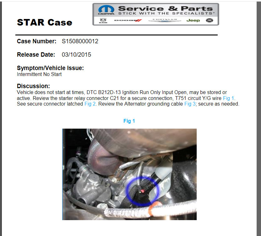

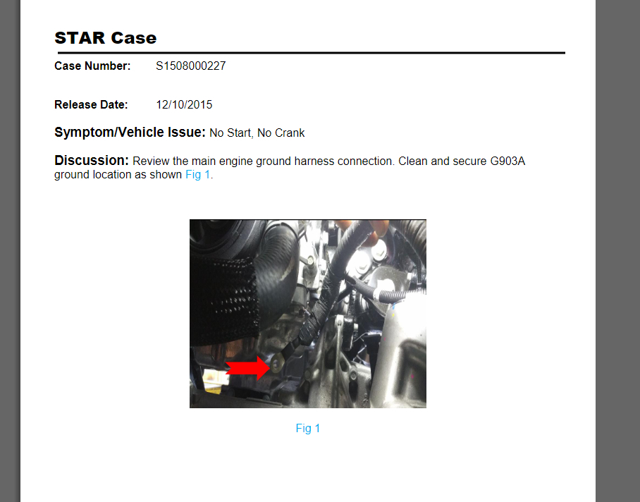

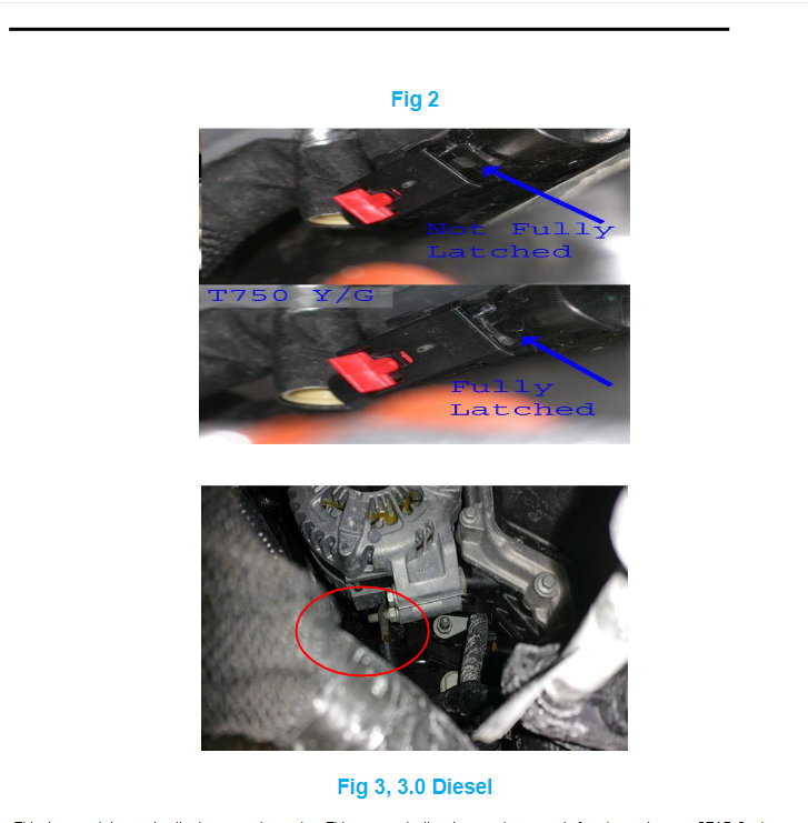

So, to address what may be happening, these trucks have a TRS signal that goes from the shifter (6 speed) to the right front hub and TCM. If this signal is missing, then you will get a no crank no start like you are. So, you want to monitor the TRS signal with a scan tool in the TCM. If you have an 8 speed then this is contained in the TCM/valve body.
However, there are also known wiring issues that will cause the same thing. I am attaching a number of documents from FCA that will point you to these known wiring problems.
Let me know what you find with this, and we can go from there. Thanks
