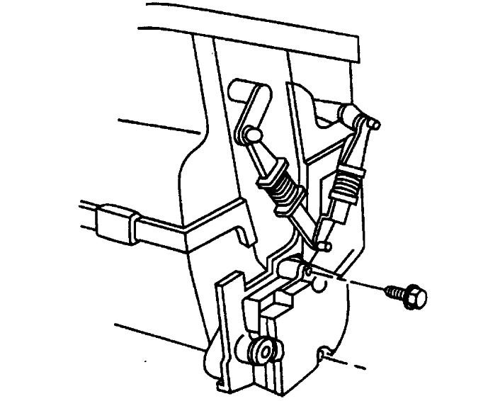

Air comes out on floor only. No mid or defrost. I replaced the actuator, but no change. I can see that it is trying to move, but does not move the vent doors. With the actuator off, the engine running, I can move the doors by hand to get floor, mid range and defrost, but not with the actuator in place. It seems like a fairly simple replacement, but I cannot figure out what I am doing wrong. Please help! Dwight

First of all, this is the actuator directly above the gas pedal. That being said, yes, I can move the plastic part in the heater box that fits into the actuator motor with my fingers, changing the air direction from floor, to mid to defrost, but when the actuator is mounted, nothing happens, just heater air on my feet. I can see the actuator trying to move (barely) when the engine is running, but not enough to change the air flow. I have not tried to work the actuator un-mounted to see if it is moving, the directions
or warning in the box it came in said not to. Dwight

Okay, I tried it and the motor moves maybe a 16th of an inch, back and forth as I move the selector from floor to mid to defrost. Barely at all.
Oct 30, 2018 at 6:41 AM
Okay, sounds like you have a bad motor. I would get a new one. Even if it is new, it can be bad. Test the new one before installing.

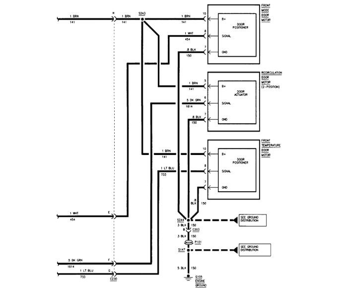

Okay, check the voltage to the actuator. In the diagram, it identifies the power and ground. Verify they are present.

Okay, there is no relay. The voltage comes from the control head directly to the actuator as in the diagram I sent you.

This is why the voltage at the actuator needs to be checked as I suggested way back. You need to verify power and ground to the actuator itself. If it is a voltage issue, yes, it may be the control head but it also may be a bad connection or wiring issue.
One step at a time. the voltage to the actuator is the next step.
