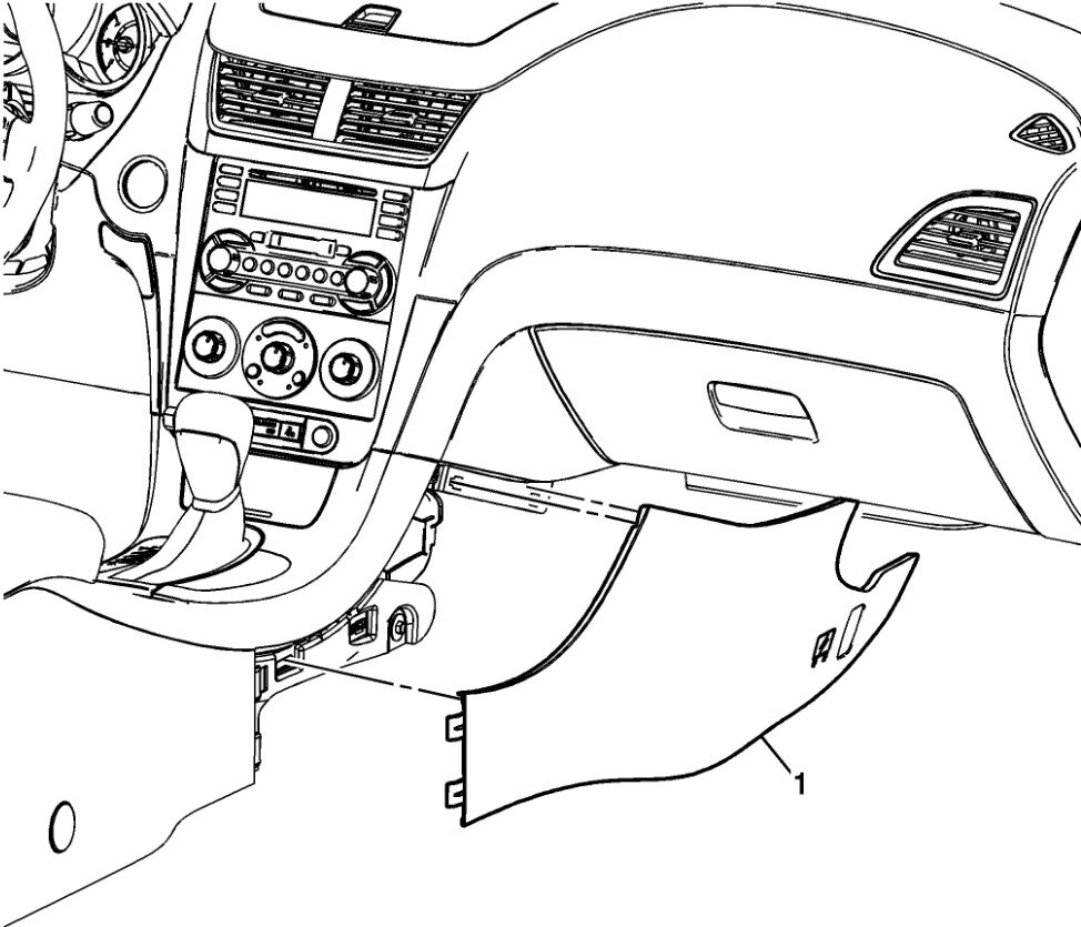

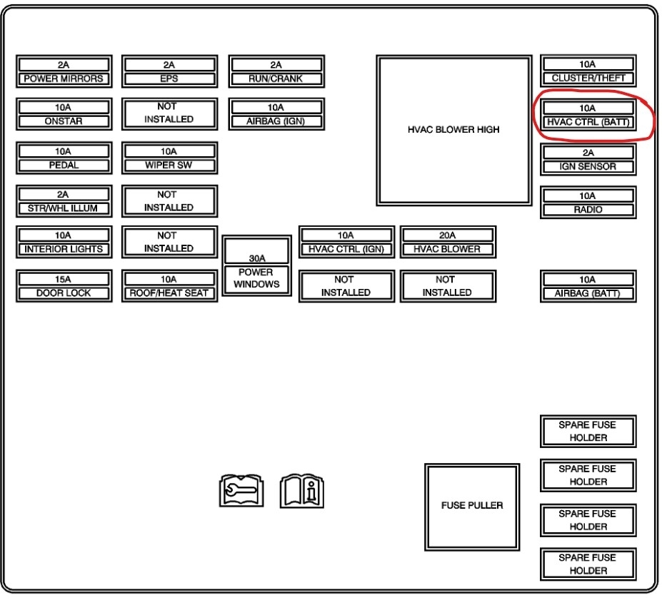

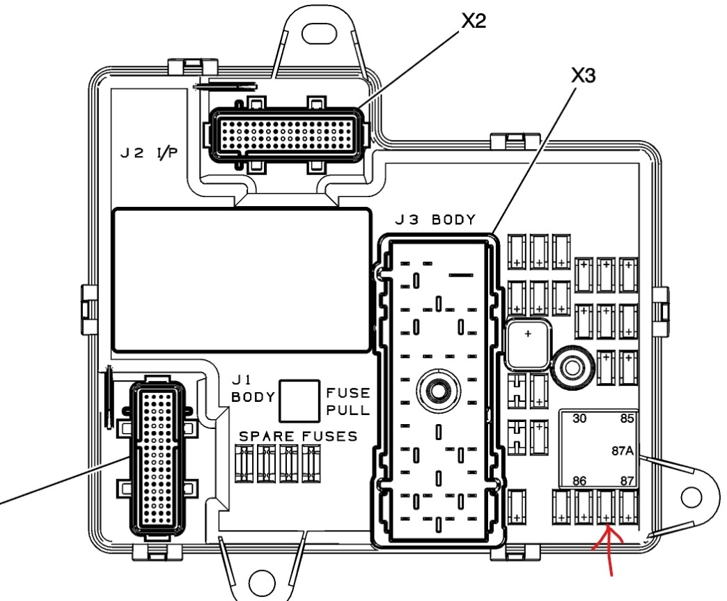

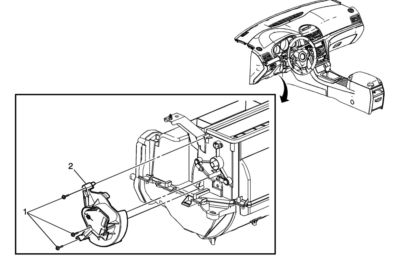

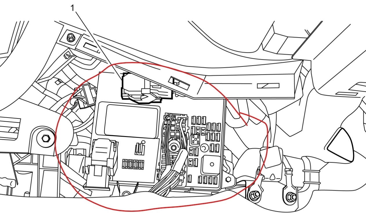

The mode door is located on the top left side of the HVAC case. From your description it doesn't sound like the actuator itself, but controller related. I would try a hard reset by removing the HVAC ctrl fuse from the body control module. To get to it you remove the right-hand console trim panel and the BCM is behind it. Remove the fuse, keep it out for about a minute. Now put it back in and let the system reinitialize. Test it, do the vents now work? If yes, then it is likely the control head and not the actuator. This could also ne tested using an OE level scan tool to move the actuator.
To get to the actuator itself you can try reaching way up to get to it but the way GM wants you to get to it is to pull the dash out to get to the HVAC box and change it that way. That entails recovering the AC system, draining the coolant, removing the console, disconnecting the steering column and unbolting the dash. Then you remove the HVAC unit from the back of the instrument panel to get to the actuator. This is another of GMs fun vehicles where the part is like $35 but it's 5 plus hours of labor to get it replaced. There might be a shortcut posted online at a place like https://www.chevymalibuforum.com/ or possibly YouTube I usually go by the book and while it's out inspect the heat and AC cores as well as the door seals and other actuators while it is apart.

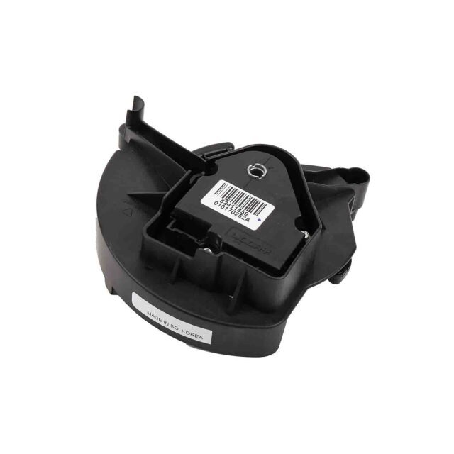

If you can see and access the screws that remove it, then great. It sounds like the actual door is sticking, not the actuator. That would require pulling the entire dash out so you could access the door inside and see why it is binding. If you can move the linkage so the door changes try this, select the floor vents, now select the dash and gently assist the actuator as it moves, does it feel like it's binding or is it still moving some after the actuator stops? Can you get to the electrical connector and unplug it? The way that system works is that the control head tells the actuator to move and then it looks for a certain value on the potentiometer to tell it when the door is in position. If the door is free, then it could be the return signal that is bad. Hard to tell without physical examination. The part is very likely GM only at this time, but in looking at the various GM parts sites it only shows the complete assembly. I would see if you can read the part number on the actuator and use that. Is the image attached what you are looking at?
