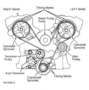

I change the timing belt and I put everything back together. The truck start good but when I drive it there is very little power and it seem to over heat

Hi there,
I would be re checking the belt tension and alignment, see pic for timing marks.
