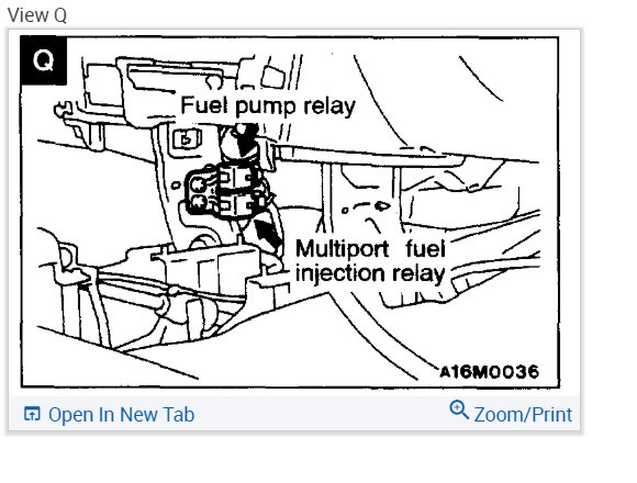

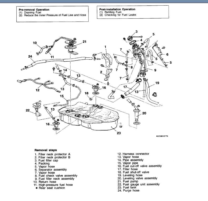

Well I went to change my battery one day and I accidentally put the wrong cables to the wrong end the positive to positive and negative to negative. After that I heard a little poof sound near the battery maybe it was the fuse but now the car wont start. I tried to jump it or change the battery but nothing. I think the fuel pump went out but where is it located what number/ if not what the problem the relay or the fuel pump?
Thursday, August 19th, 2010 AT 6:45 PM
  • 75,992 POSTS
Here is a guide to help check the relay and show you step by step how to change out the fuel pump with diagrams below to show you on your car.
and
https://www.2carpros.com/articles/how-to-replace-an-electric-fuel-pump
