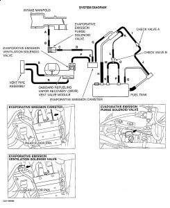

this evap, where is the position on the car?

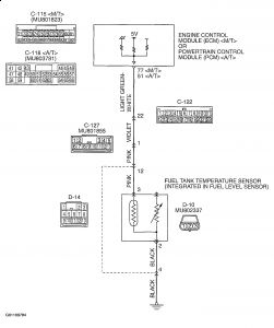

the fuel temp. sensor, where is the position as well? I may be able to check if the fault is electrical because I am an electrical engineer. It could be lost of continuity on the cable

Hi there, See pics for sensor & evap systems. Mark (mhpautos)

Thank you for the picture but it too tiny and I cannot read what is written on
