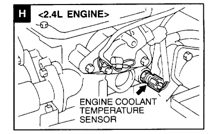

This sounds like the engine coolant temperature sensor is not working right Here is a guide to help you see what you are in for when doing the job.
https://www.2carpros.com/articles/coolant-temperature-sensor-cts-replacement
Here is the location for your car (below)
Cheers
+1
Thursday, December 11th, 2008 AT 10:03 AM
DAVID SR.
Wow that fixed it, so good thanks for your help I didn't think that would do it but all good now :)
