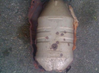

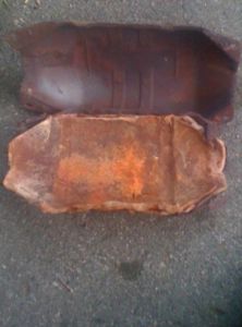

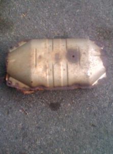

Hello friends,
Before I go to the shop I always stop past here to get a little information or understanding so I don't appear clueless. This morning when I was getting into my car while crossing the street I noticed something appeared to be hanging from the bottom of my car. I got on my knees to look under the car it it apeared to be some type of pan looking thing hanging. I have a 98 galant. The pan looking think is in the middle underneath hanging but not dragging. What part could this be?
I was able to get it off with ease however I still don't know what this piece is so I have posted pictures so someone can help me identify the part so I won't get duked when I go to the repair shop
http://www.2carpros.com/forum/automotive_pictures/120173_photocar_1.jpg
http://www.2carpros.com/forum/automotive_pictures/120173_photocar4_1.jpg

This an overheated catalytic converter.
It reduces tailpipe emissions of hydrocarbons (HC) and carbon monoxide (CO) to extremely low levels, when everything is operating normally
The first pic is the shell that goes around it.
The color of the shell prove that it has overheated.
Unburned fuel, bad oxygen sensor giving wrong information, fouled spark plugs, leaking valves.
Replace the catalytic converter and have a compression test done.
