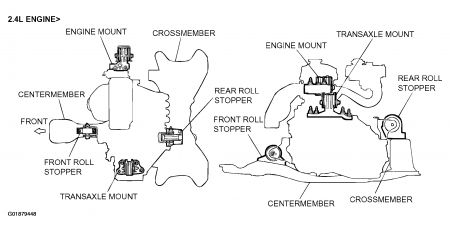

my friend, richie, says he needs to know what size press he needs for changing out his motor mounts....??? you only need a ratchet right? his haynes manual tells him he needs a press for it.... what should i tell him. all the mechanics i know say they've never heard of needing a press of any kind to change one out before, but one person mentioned something about a bushing or something...?

They just unbolt see diagram

thyats what i told him but i think he may be looking in the wrong section of his manual or something... :\

May be looking at cross member bushing that do need a press

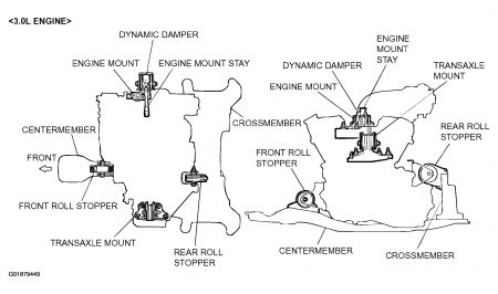

his is a 3.0L not a 2.4L... shouldnt there be four engine mounts?

Doen't matter 3.0L same there are four count them on left figure
