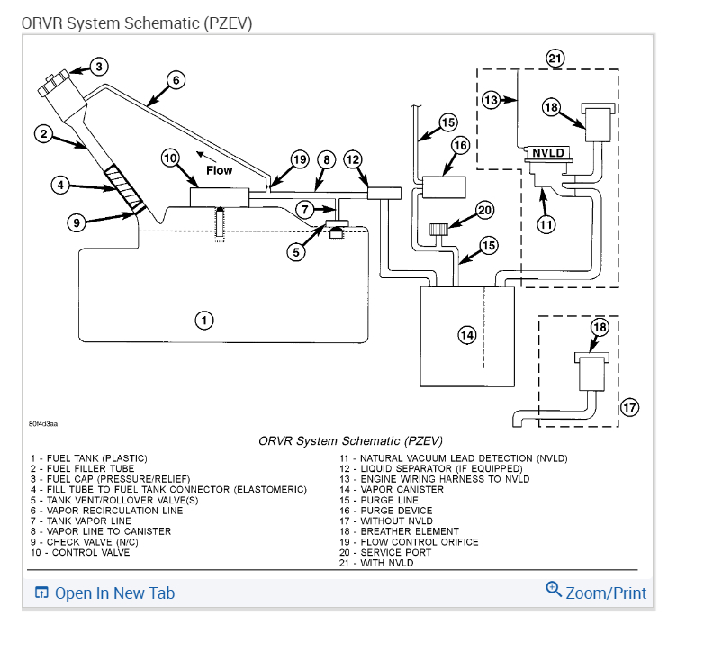

I have a hose missing on the intake that runs into the throttle body there are two nipples side-by-side. The top one has a hose running into the valve cover the bottom nipple has no hose and is sucking air making the car run bad, but I cannot find where I need to run a hose at from that nipple. I checked the diagram, and it was no help and if I plug the nipple the car shuts off. I don’t have a pic of mine, but I’ll put a picture in of what I’m talking about. If someone could help me with this I would greatly appreciate it.

Can you please shoot a quick video with your phone so we can see what's going on, that would be great? You can upload it here with your response. Here is a vacuum line diagram for your car in the images below. Check out the diagrams (below). Please let us know if you need anything else to get the problem fixed. This is the only diagram they give us.
